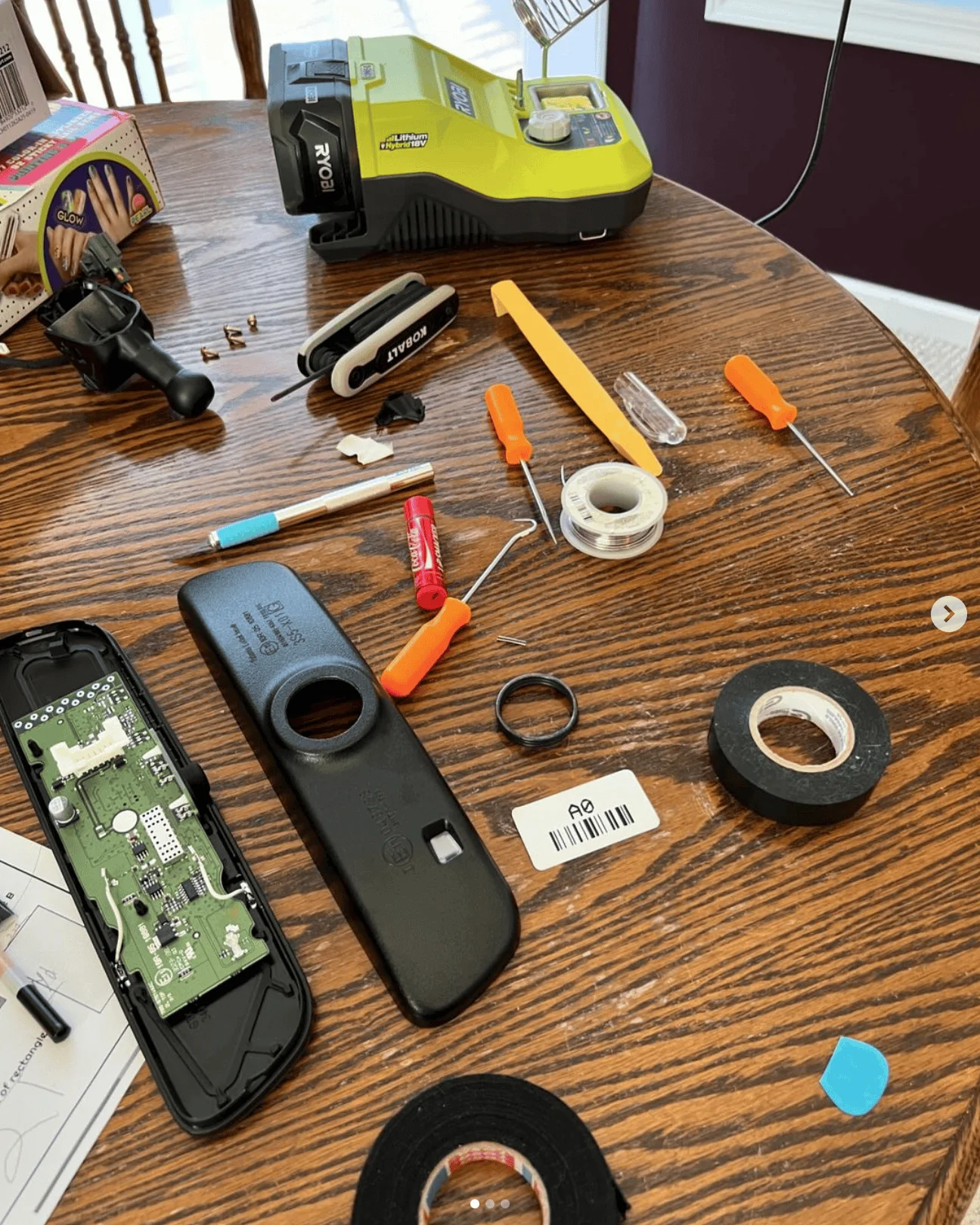

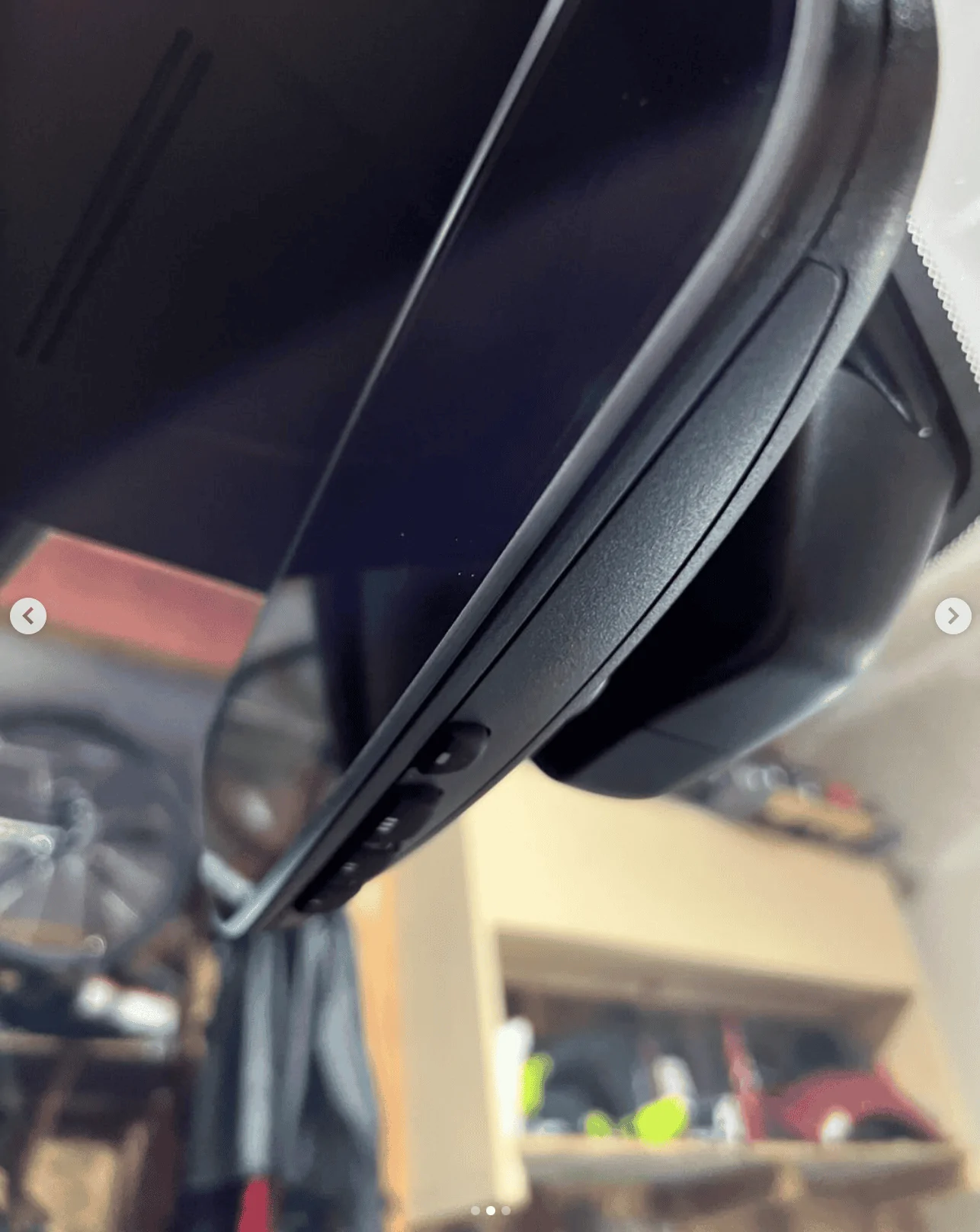

Small but necessary mod last night. Bought a frameless Homelink mirror for a 2023 Accord and swapped the Integra's internal harness and mirror stem over, modified the harness a bit to provide power to the Homelink module and now my most major annoyance with the Integra is fixed!

Was thinking about this job a bit. What parts did you need (and cost/source)? And how long did it take you to swap? Thanks in advance!

I purchased a 2024 Accord mirror with Homelink. Part number is 08V03-3A0-100. That's it. I got the info on how to do it elsewhere on this forum. I'm in the process of doing a little blog write-up that's detailed, and may also do a video that explains the disassembly process. The whole thing took about an hour and a half. If I had to do it again it'd be probably 30-40 minutes.

Will do. Blog is up here.
https://www.levelmotorsports.us/?p=1
I'll have to take the video when I'm able and it's nice enough out to do it. Disassembly and re-assembly is really the only tricky part. There are a lot of plastic clips and it might be easy to break them. Fortunately the mirror has a TON of them all around it so if you break one or two, it wouldn't really be the end of the world. The modified mirror is already in the car and I'm not going to pull it back out again, but I have the other mirror re-assembled fully so I can show disassembly of that. Disassembly and reassembly is the same for both the Integra and Accord mirrors.
