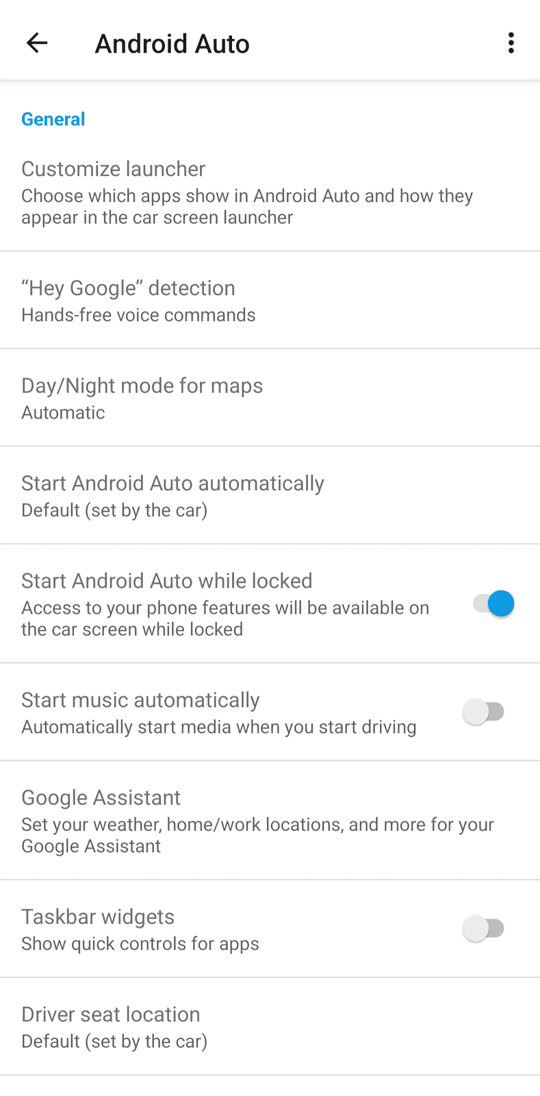

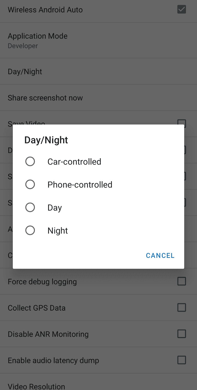

Anyone have issues Maps/Wyze not switching to night mode automatically? Day/Night mode for maps was set on Automatic and it seems to do nothing. I went to the Dev option and change Day/Night mode to Phone-controlled and it works until I turned off the car. Once the car starts up again, it's back to Day mode. Car-controlled doesn't seem to do anything. I prefer to have Day mode in the morning and switch to the Night mode later but it's either stuck on one or the other settings. My old Pioneer deck was able to do this but not sure why it's not working here

I'm not sure why it won't stay at phone controlled when you start up the car.
I did notice that when the car is controlling it, it goes based off of the time. I wish it would just switch when the lights come on.
When I was using the Pioneer AVX-4500, car-controlled worked based on when I turn on my headlights, the maps auto-switch to dark mode. I know google did something that broke it and changed it based on time. For some reason, Car-controlled doesn't seem to work for me in the Type S.. It's always showing Day mode..

Make sure in the AA Day/Night mode settings on your phone it's set to automatic
Strange how my dev settings is unchecked
Thanks... Mine was setup Automatic in the Main and in Dev (Car-controlled).. But i'll double check again if it working.. Unfortunately I can't tell if it working correctly until the day of the time. Is yours working correctly? I'm using Samsung galaxy s24u if that makes any difference.
