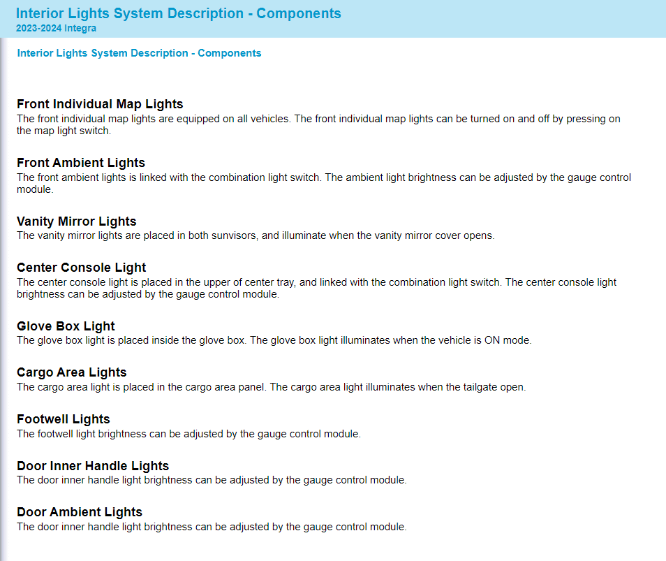

Acura has the same exact description for the last two items - Door Inner Handle Lights / Door Ambient Lights. Patrick, can you chime in here and tell us if all you replaced was the LED module from the Inner Door Handles. I think you replaced the Door Ambient Light LED and not the Door Inner Handle Light LED because those are still illuminating as white. I don't see a separate LED for the Door Ambient Light anywhere in my parts catalog and that is very odd.

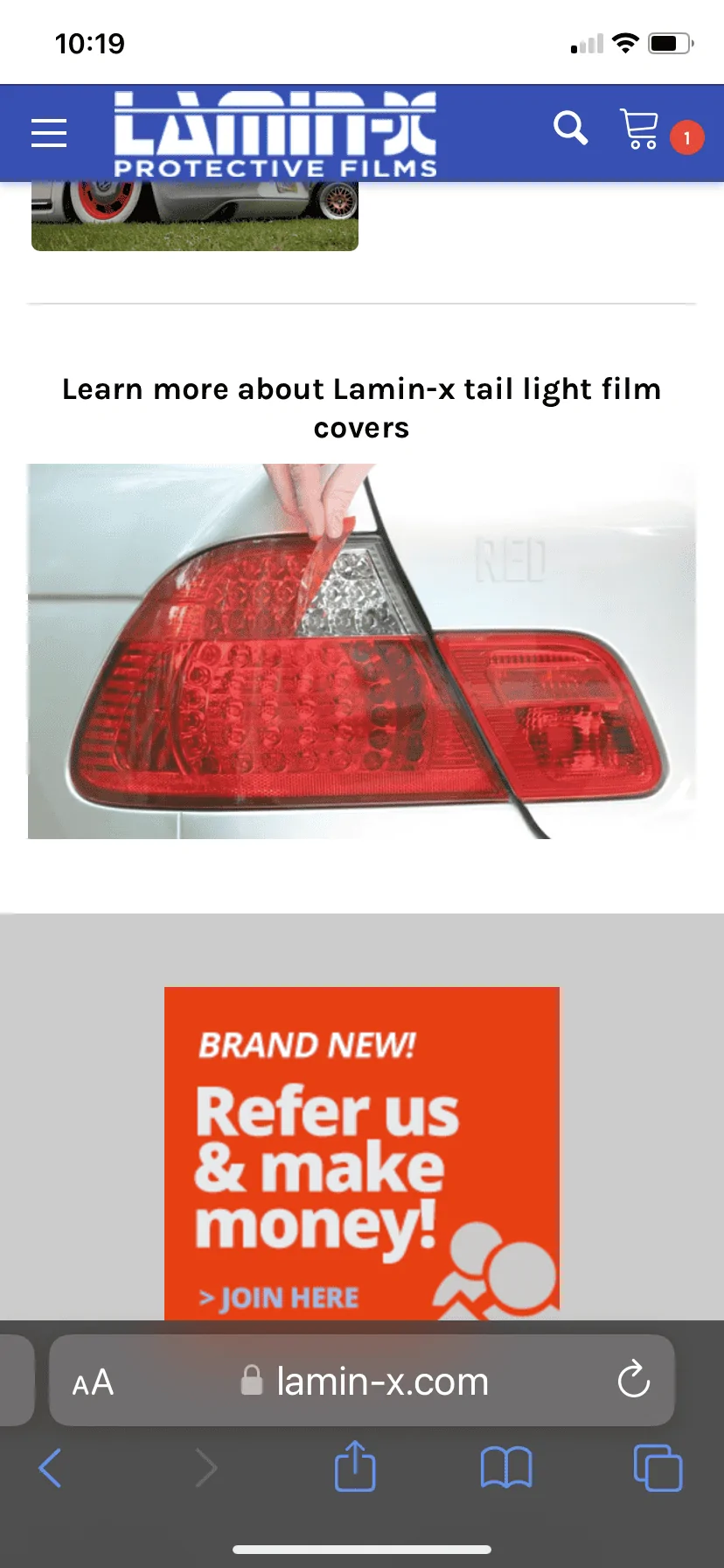

I hate to mention this publicly for risk of shame, but there might be something. ? Lamin-x self adhesive red film. I've used their stuff on my trucks before & it's the best film I've come across so far. I'm actually trying something out custom cut myself from one of their universal sheet sizes for the DRL's - like Jets Vinyl overlays but honestly, I think I can cut the more symmetrical & a fuller shape to cover them better & achieve a different hue I'm going for maybe. Hard to say how this lighting effect would compare to just replacing the bulbs.
Going for a demon brow look; I dig it!!! Knowing you, there will be a guide showing step by steps ? are you referring to going for a darker hue like stacking layers of the lamin-x to create a darker red?
I think I may look into theis for that pesky over-head co sole light!
1,480
1,201
Actually, I tried Jets Vinyl Amber/orange but with the lights on it still looked yellow like everyone else's - which I think does look great, but I wanted something different. So I stacked the 2 on top of each for a mock up & I did like it better, but still really wanted more of that orange/amber glow with the lights on. But now I'm thinking red might be cool...or it'll look pink with the lights on. Or maybe be too intense. Or too much red with the other red accents. I've got some thinking to do. ?
But it might definitely be a solution for any interior LED's that don't have a red replacement yet so far.
