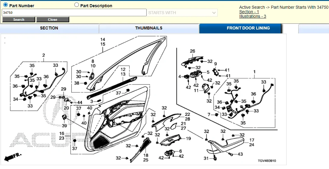

Very easy swap. TLX part number: 34750-TGV-A410.

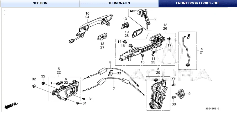

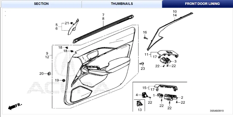

So I'm looking at that part number you posted and I find this in my catalog at work for a TLX - it's #3 in the diagram which is detailed as Front Door Handle Light Assembly....
Acura Integra Ambient Lighting 1691771121165
You can see it just below the horizontal molding above the door panel to the left. Tiny little box...is that the grey box in the 2nd picture you posted? The Front Door Handle Light Assembly on the Integras are not pictured with the door panels but rather the door locks/handles as seen below....
Acura Integra Ambient Lighting 1691772865265
Acura Integra Ambient Lighting 1691773168982
That can be seen as #1 in the diagram above, shown with the inner door handle and are only found on TECH package A-Spec and Type-S models. Did you simply swap the Integra module with one from a TLX A-Spec to achieve the red interior light? Please let us know and thanks...
-G
The tiny grey box from the pic I posted is the LED. It can be swapped out to a RED LED. The pipe itself is clear. I updated my original post. The Type R Red LED is the same and way easier to find online. 34750-T20-R01 Light Footwell. Yes I know its a footwell, but its the same as the one in the doors.
