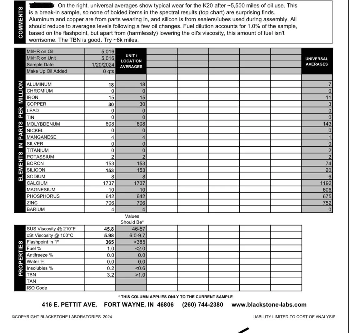

I know there are a few different opinions about when to do the first oil change. Here is an oil analysis at 5K if anyone is curious.
thanks for sharing!!! are those aluminum and copper numbers acceptable for the long term? i get it'll get flushed out with oil changes but i was leaning towards going with the manufacturer's recommended interval at 10k miles.

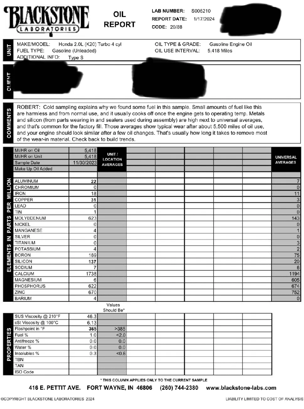

Sent mine in around the same mileage. Need to another change very soon. I’m just below 10k.
I did not use the extractor. I simply put the bottle under the oil while draining when it was about halfway through.
This next time I will at least warm the car up slightly before sampling.
Acura Integra Oil Analysis at 5k (Blackstone Labs Report) IMG_1593

Good report so far. In other applications, the previous gen Accord and current gen RDX, fuel dilution seems to be more troubling....especially with short trips. I imagine ITS owners try to get the car up to full operating temp and let it stretch it's legs. Keep in mind, that Blackstone isn't the best at measuring fuel dilution; maybe try another lab like Polaris or Oil Analyzers for more accuracy on that.
The 1.5T in the regular Integra is going to be the troublesome fuel diluter for sure. Depending on how you drive and how far down the rabbit hole you want to go, maybe try a nice 0/5W-30 once fully broken in/outside of the free dealership changes. If the sky is the limit, look at HPL (High Performance Lubricants) or Amsoil Signature Series for drain intervals beyond what more mere mortals think is possible.
