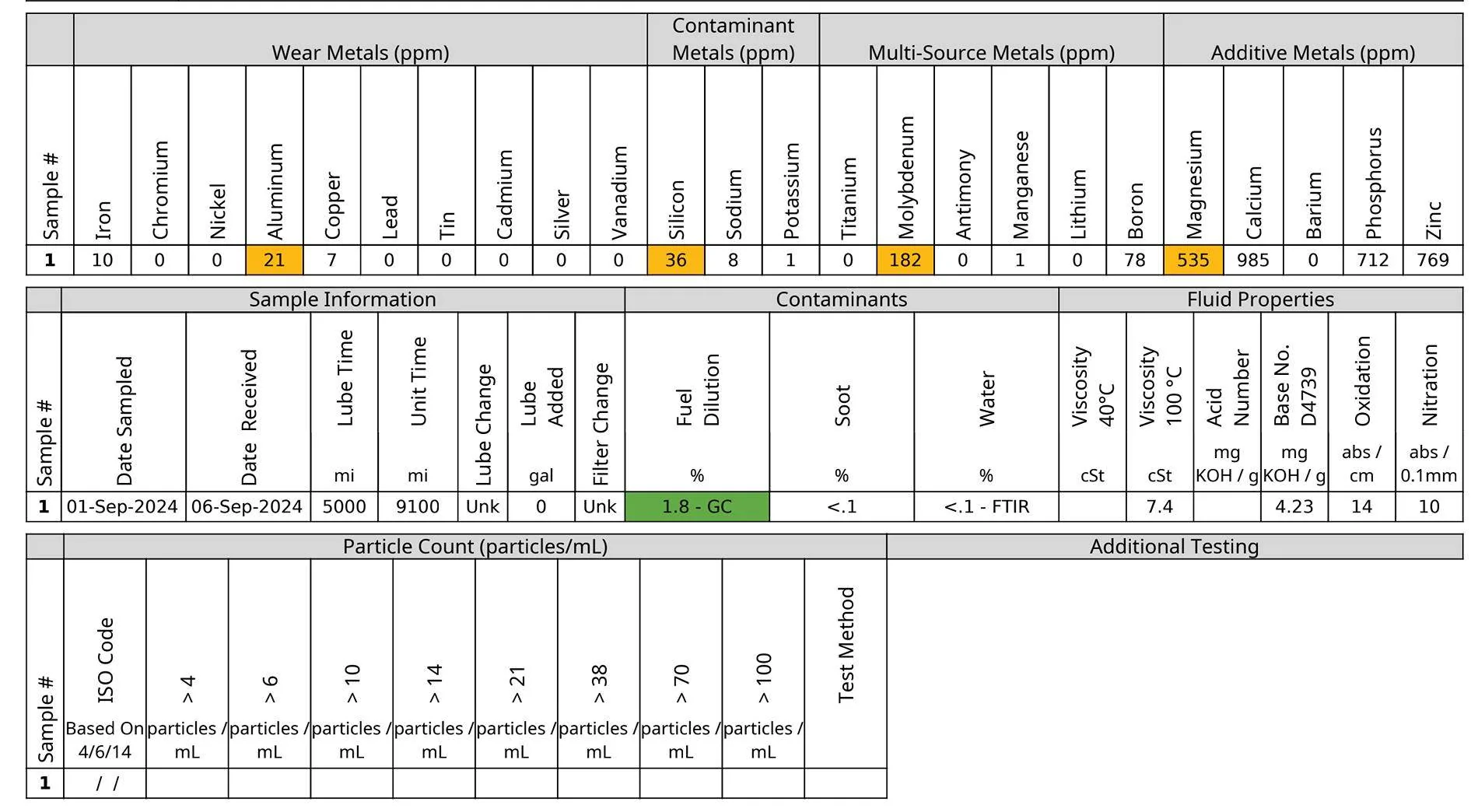

Adding mine in as I am starting to see how a good 20 holds up to to shearing along with dilution. Looks to me its still breaking in a bit with higher metals. Mag was flagged but I think that is a mistake as they think its M1 ESP vs M1 EP which I told them about (the emissions Euro oils have slightly different add packs and limits to SP).
5K of 80% HWY miles on this sample, nothing added. M1 0w20 EP used with filter change., 9K total on car.
Dilution while not being as bad as the 1.5T is still there a tad, thus is life with GDI. Viscosity held up pretty good as VOA shows EP in the 8.6 range.
I'll run 5-6K OCIs and see how it trends and if metals stay higher, will see what a 30 grade does.
