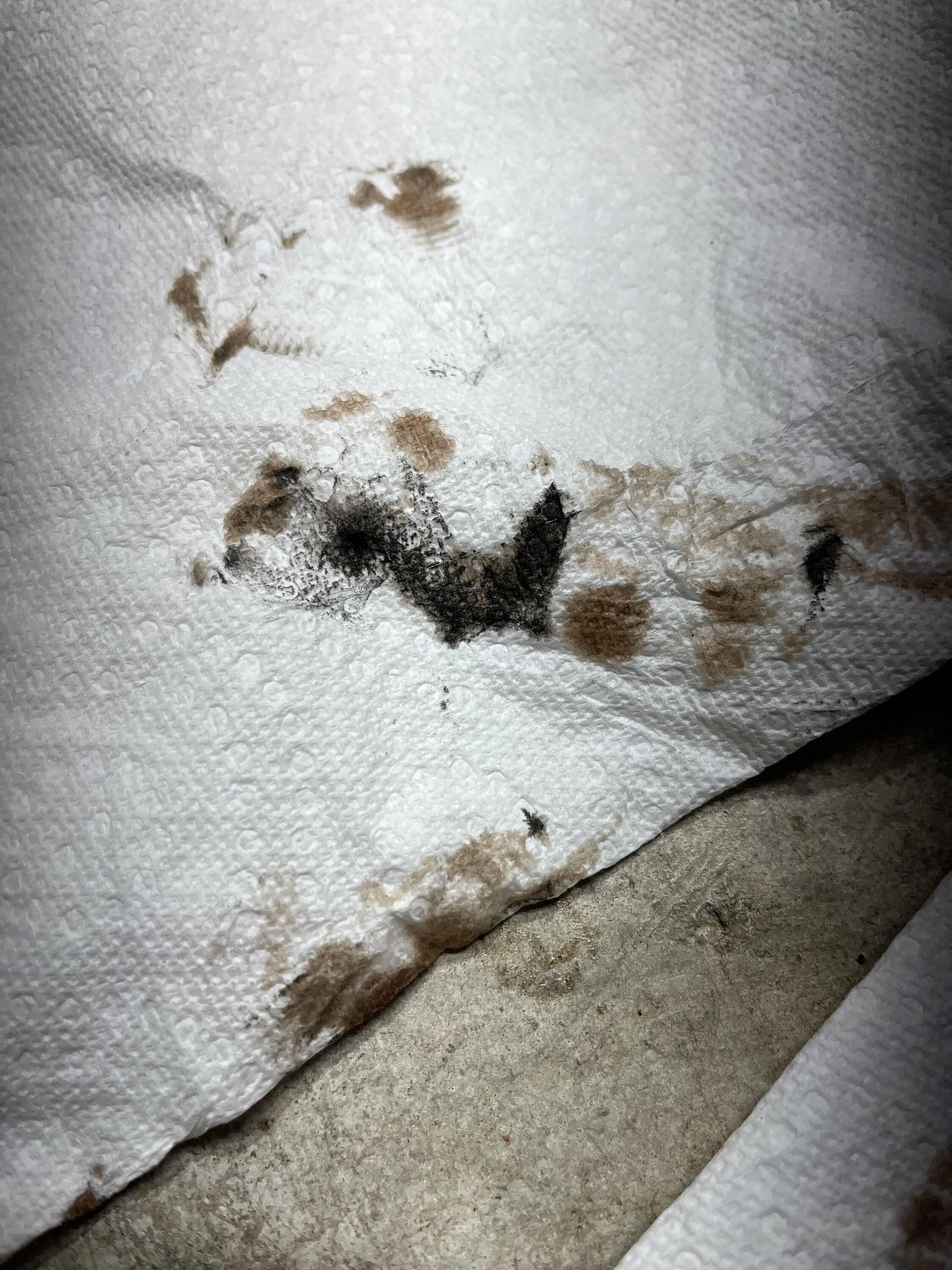

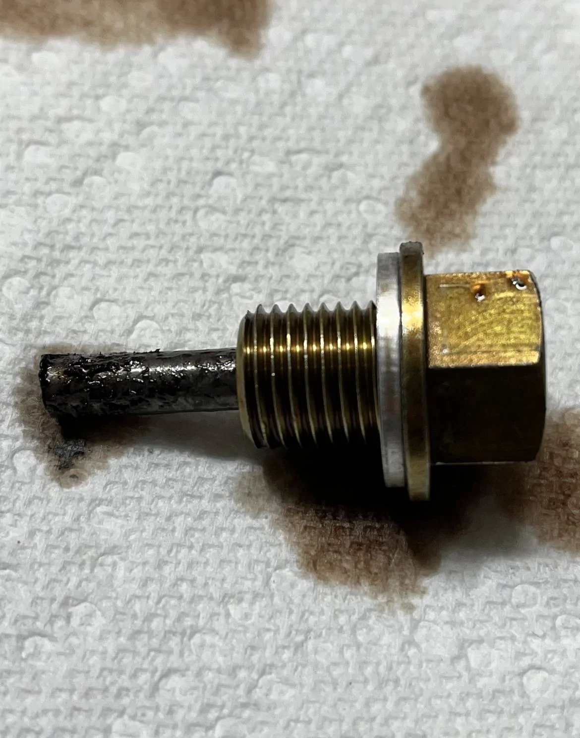

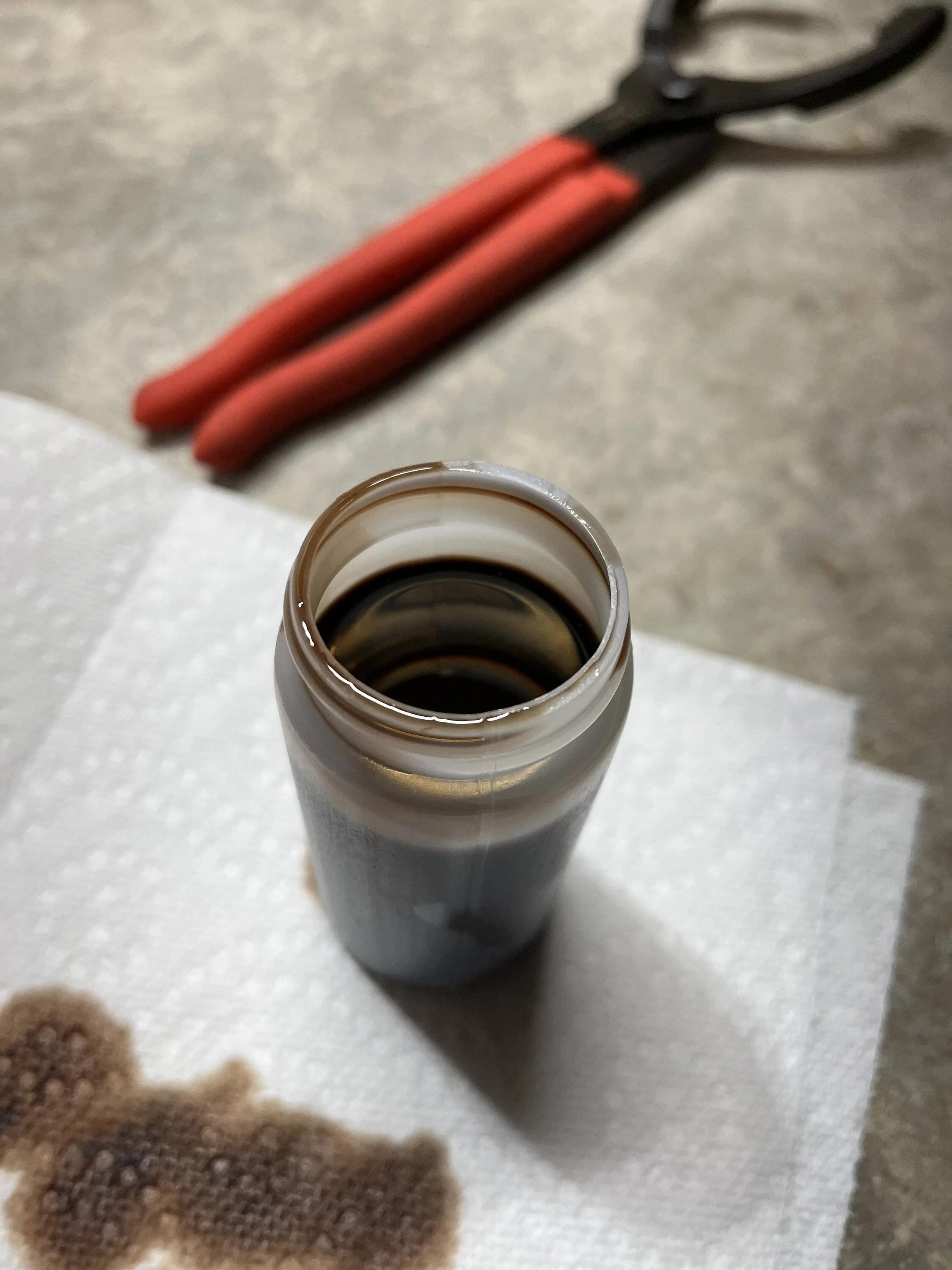

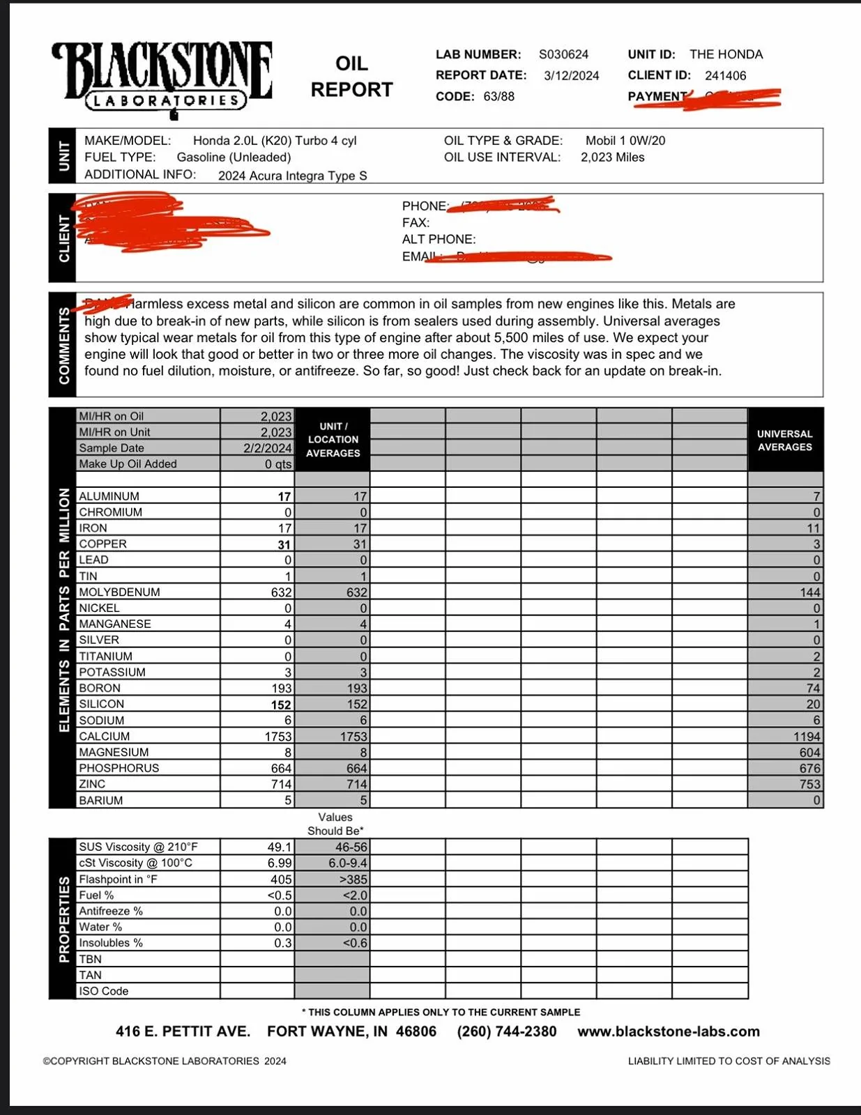

Just sent my second oil sample off & switched to 5w30. Spoon magnetic plug either picked a little bit up or a little factory moly came out with it.
Acura Integra Oil Analysis at 5k (Blackstone Labs Report) IMG_2707
I run the same drain plug in my S2000 - That looks pretty normal. But was the black stuff smooth or gritty when rubbed between your fingers? Smooth is fine, gritty not so good. Looking forward to seeing the lab report.
It was smooth actually! I expected it to maybe have a little grit to it, but it all rubbed off smooth. Probably can’t tell very well here:

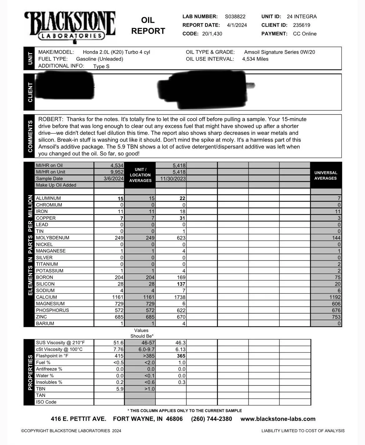

2nd report:
Acura Integra Oil Analysis at 5k (Blackstone Labs Report) IMG_3259
