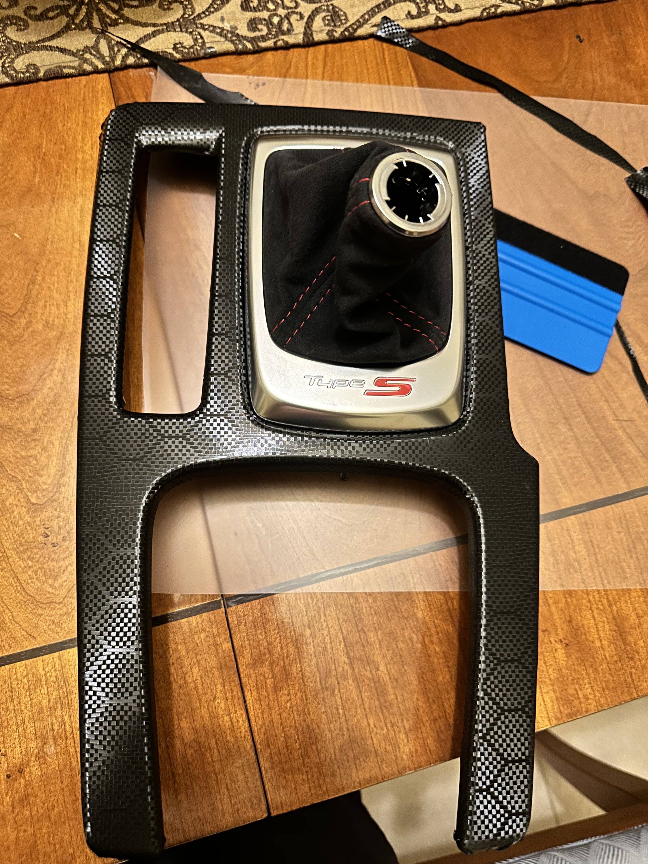

I know personally this is a popular topic but with little information available (at least I couldn't find any) so I'm hoping to contribute to the community.
This is the Alcantara wrapped console I bought from Overland Designs:
https://overlanddesigns.com/products/type-s-console-cover
Disclaimer:
• I'm NOT an expert and used the best tools I had available to me. Take your time and be patient to avoid any broken clips.
• Also make sure to protect the rest of your interior from getting scratched.
• I'm open to suggestions regarding this process so feel free to chime in.
• I believe the process should be similar to all manual Integras from 2023-onwards.
Tools used:
• Phillips screwdriver
• Prying tool
• 15mm wrench (i think 14mm might be the exact size but 15mm worked for me)
• Tiny screwdriver (for poking that small plastic clip)
• A lot of patience

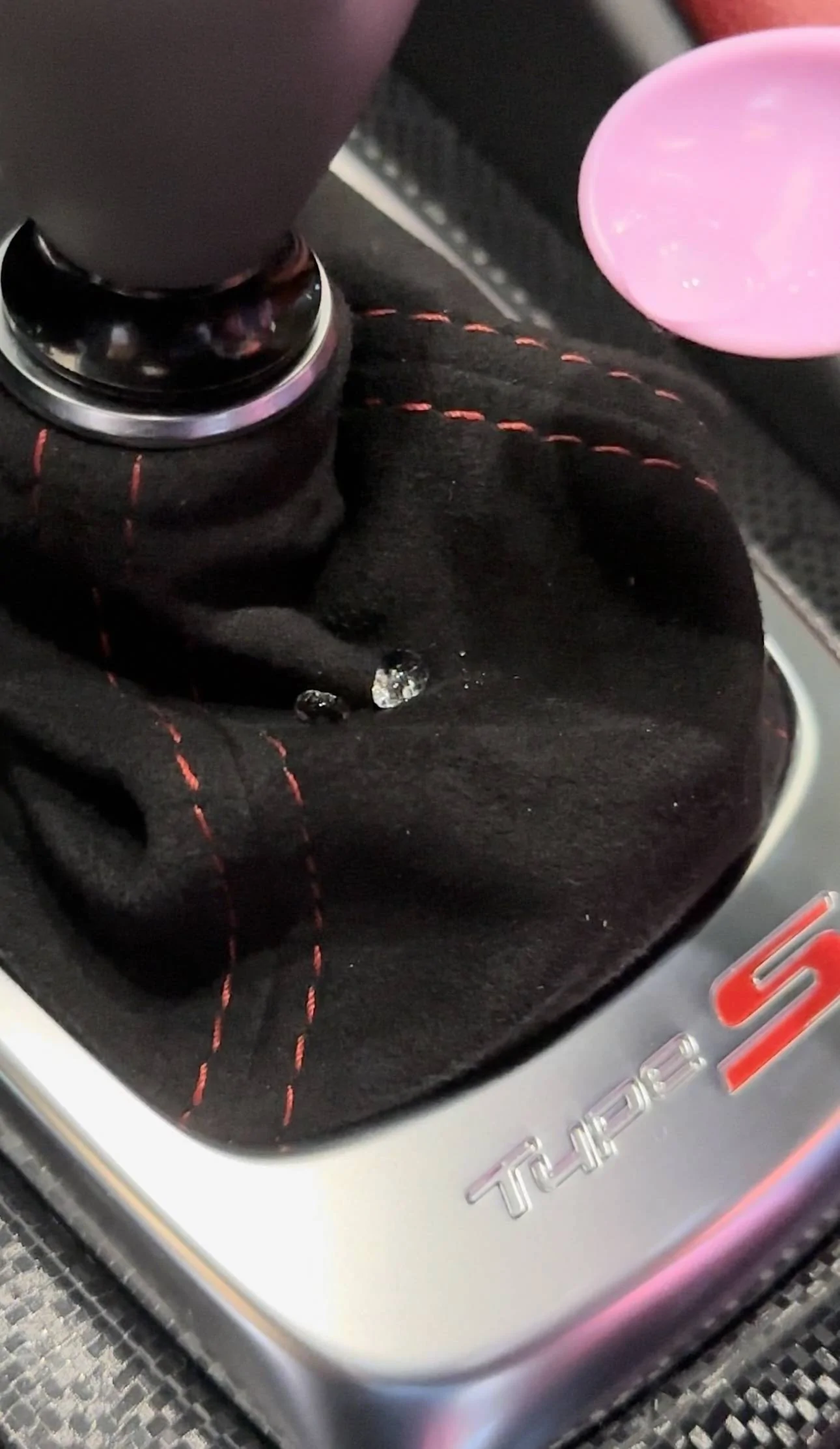

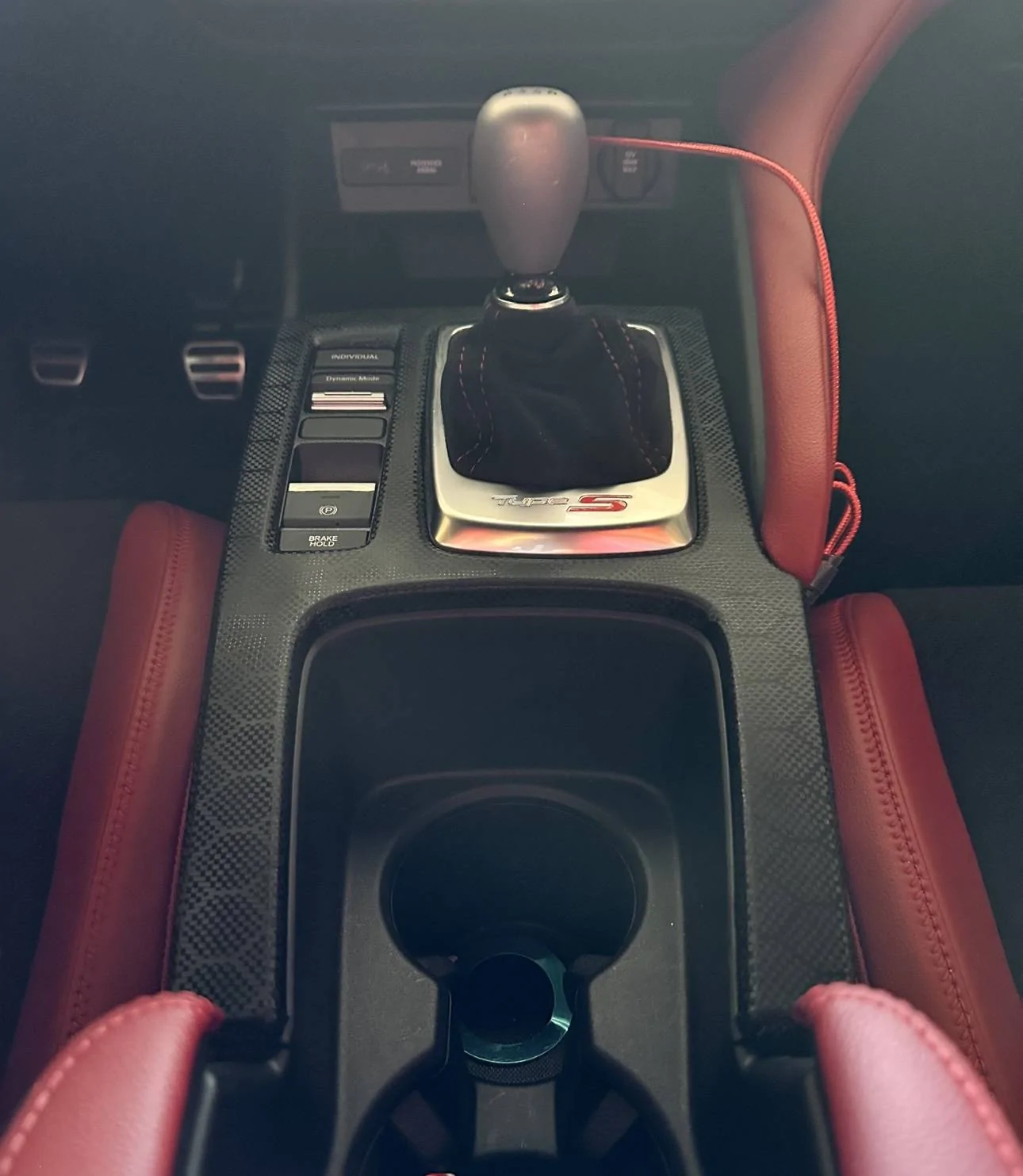

Much thanks to your video I was able to do this very quickly:
Acura Integra Integra Type-S Center Console Replacement DIY Tutorial (3mins video) 6F2B6150-E2A5-4391-A479-8533F3A29B45
Acura Integra Integra Type-S Center Console Replacement DIY Tutorial (3mins video) 71DC8BE9-D48F-44E4-B894-759013E80D02
Acura Integra Integra Type-S Center Console Replacement DIY Tutorial (3mins video) 4D6920EA-0ED8-4200-BF27-F948EBBA6918
Alcantara protected:
Acura Integra Integra Type-S Center Console Replacement DIY Tutorial (3mins video) B2020914-DBC2-400D-8010-4BFAE6F9CE53
Biggest difficulty was the shift knob torque nut was tightened way too much by the dealer. I had to hold the wrench on the nut Then wrap the knob with rubber and apply channel locks to loosen it
