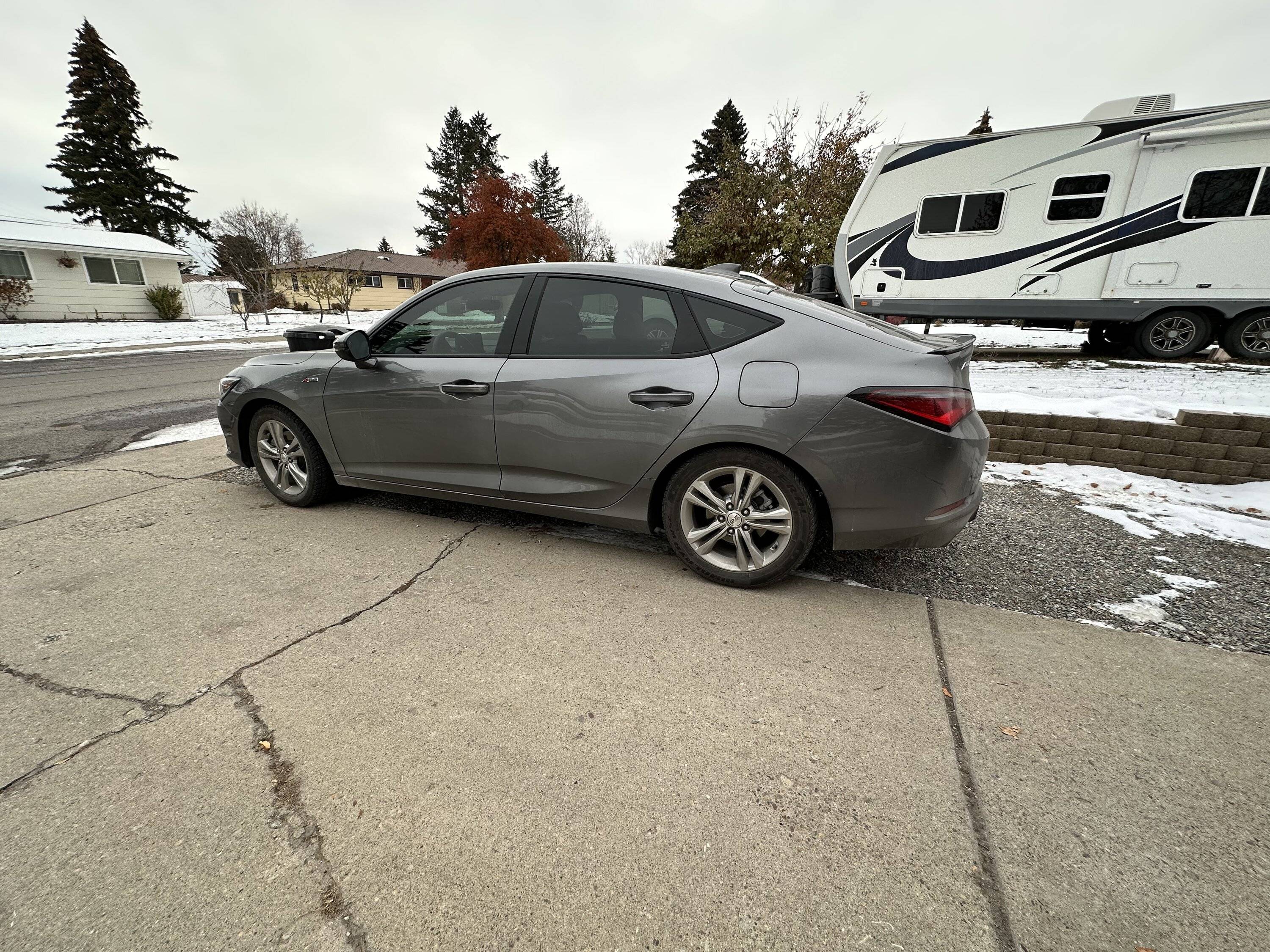

Update: Got the 17's on without TPMS sensors and there is a notification in the center of the right-side gauge on every startup and a small yellow light on the left side. No audible alarm at least.

I bought wheels off of a Hyundai sonata. They are 7X17 with 5x114.3 bolt pattern. Not sure about what offset they are, but they work well. Even got some center caps off eBay for them.
