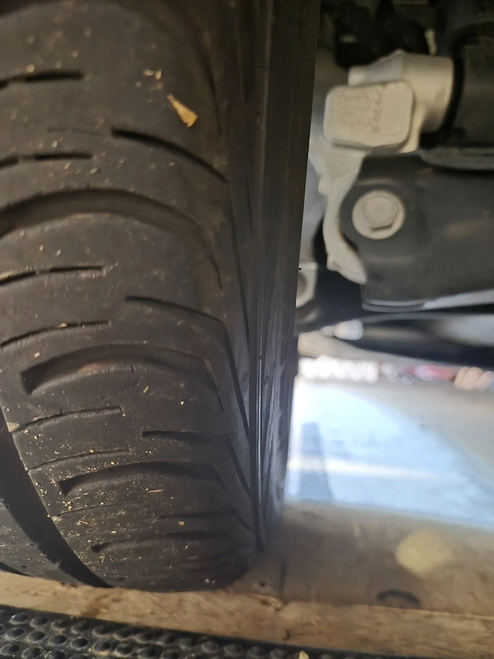

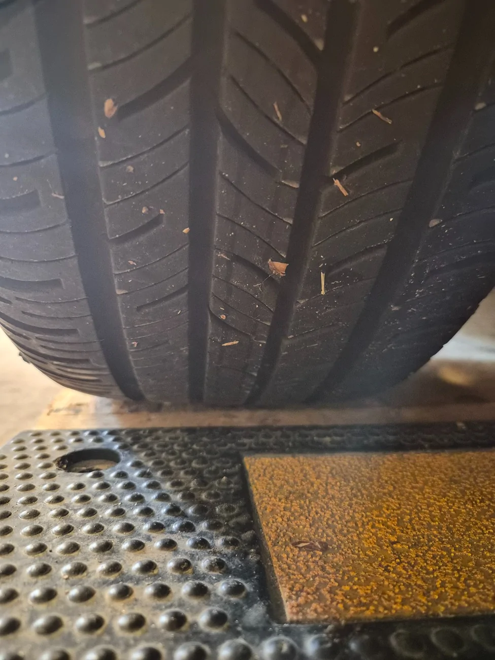

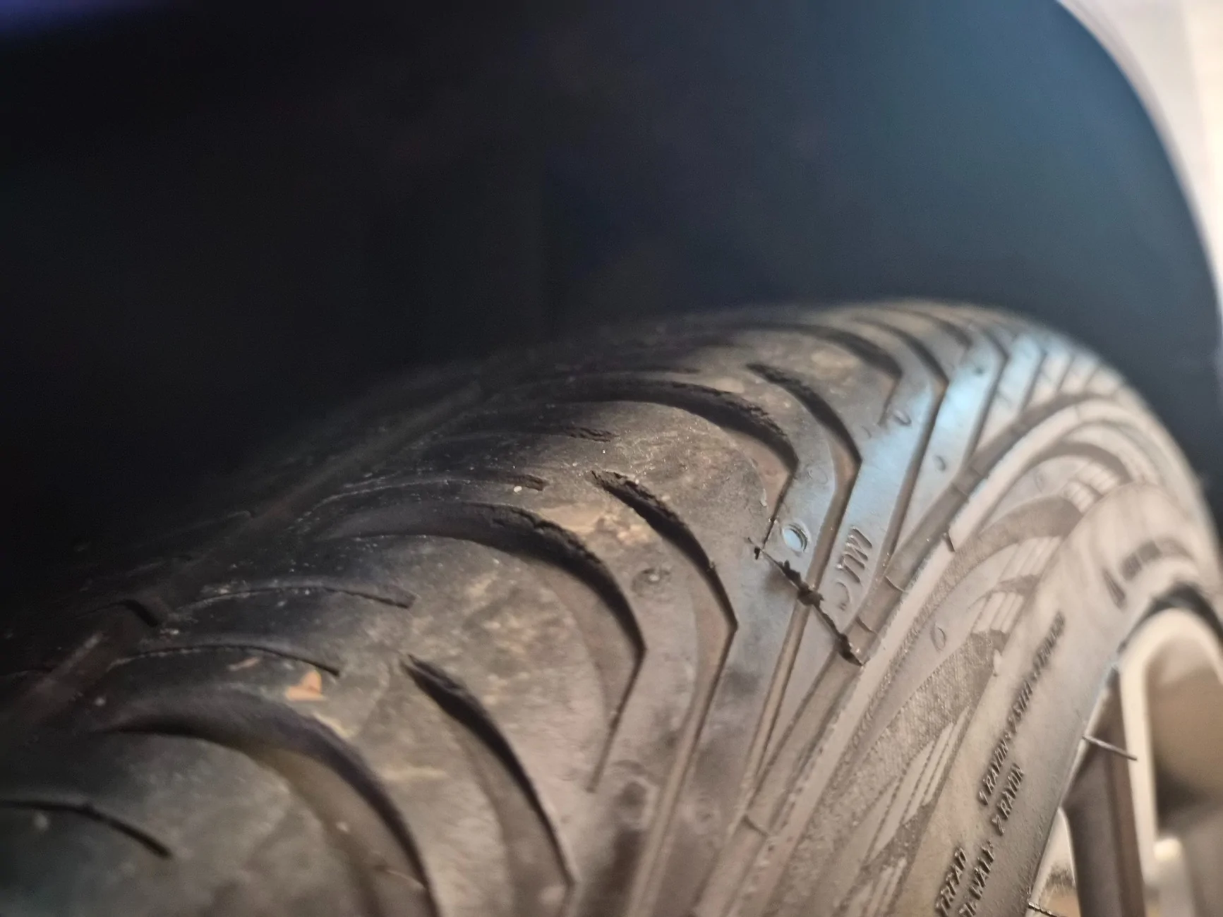

What does your wear look like on your stock tires?
Note I said spring rate, not springs. Springs will generally be detrimental to performance without other compensating factors. If you're going to up rate for track use or for a slicker tire, you'd ideally want coilovers that leave at or near factory height. Limit what's being changed so you don't chase rabbit holes.

Basically no wear on those, lol. I was expecting more worn. How many sessions have you put on them?
Yeah figured it'd be hard to say much, they only have 3 decent road sessions. Closest route for it here is the Pinnacle to Little Italy route. ~24 miles round trip with 400ft elevation change, 40 mins or so spirited.
Just feel like these sidewalls roll or the tires want to let go too soon when powering through turns. Maybe the stiff RSB adds to that. Trying to build a case for upgrading tires before the stock ones wear out 😅

Squishy sidewalls will roll a lot! Sway bar will force more load to the sidewall. Makes it flex more, heat up more, lose grip at the axle. Usually that means upping air pressure which again lowers grip on the axle.
With a soft sidewall like on an all season, you want less bar and less spring rate overall for better contact.
