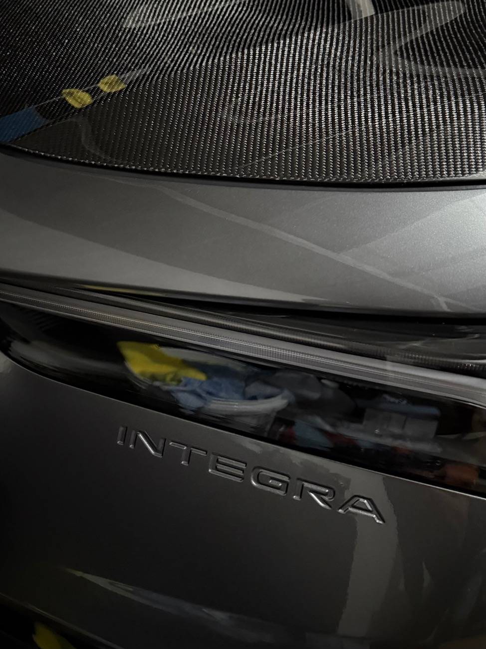

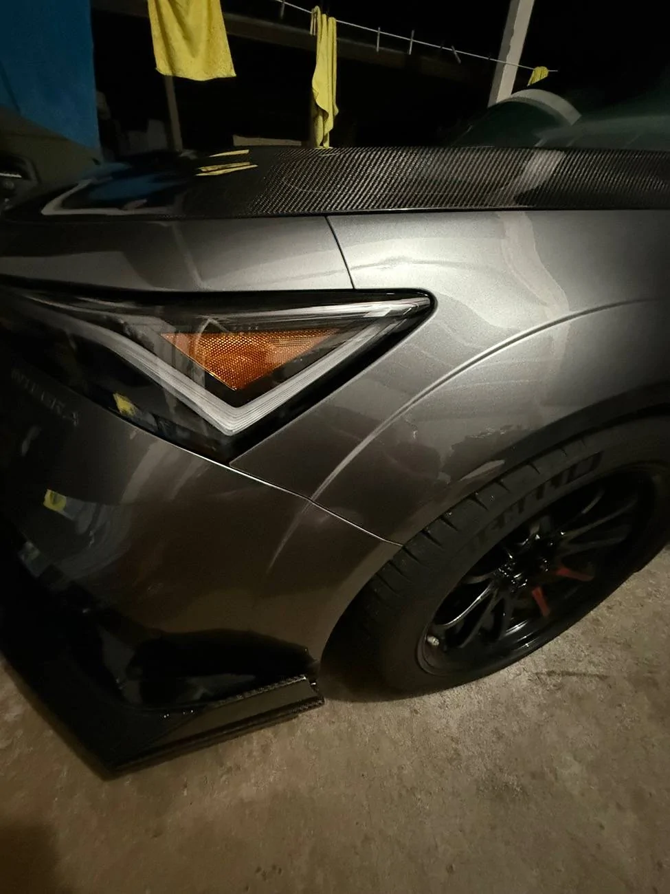

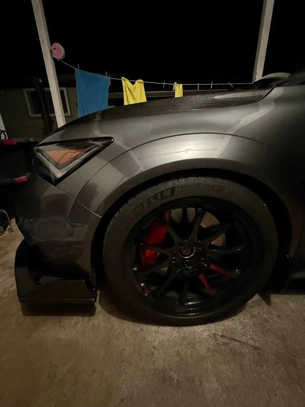

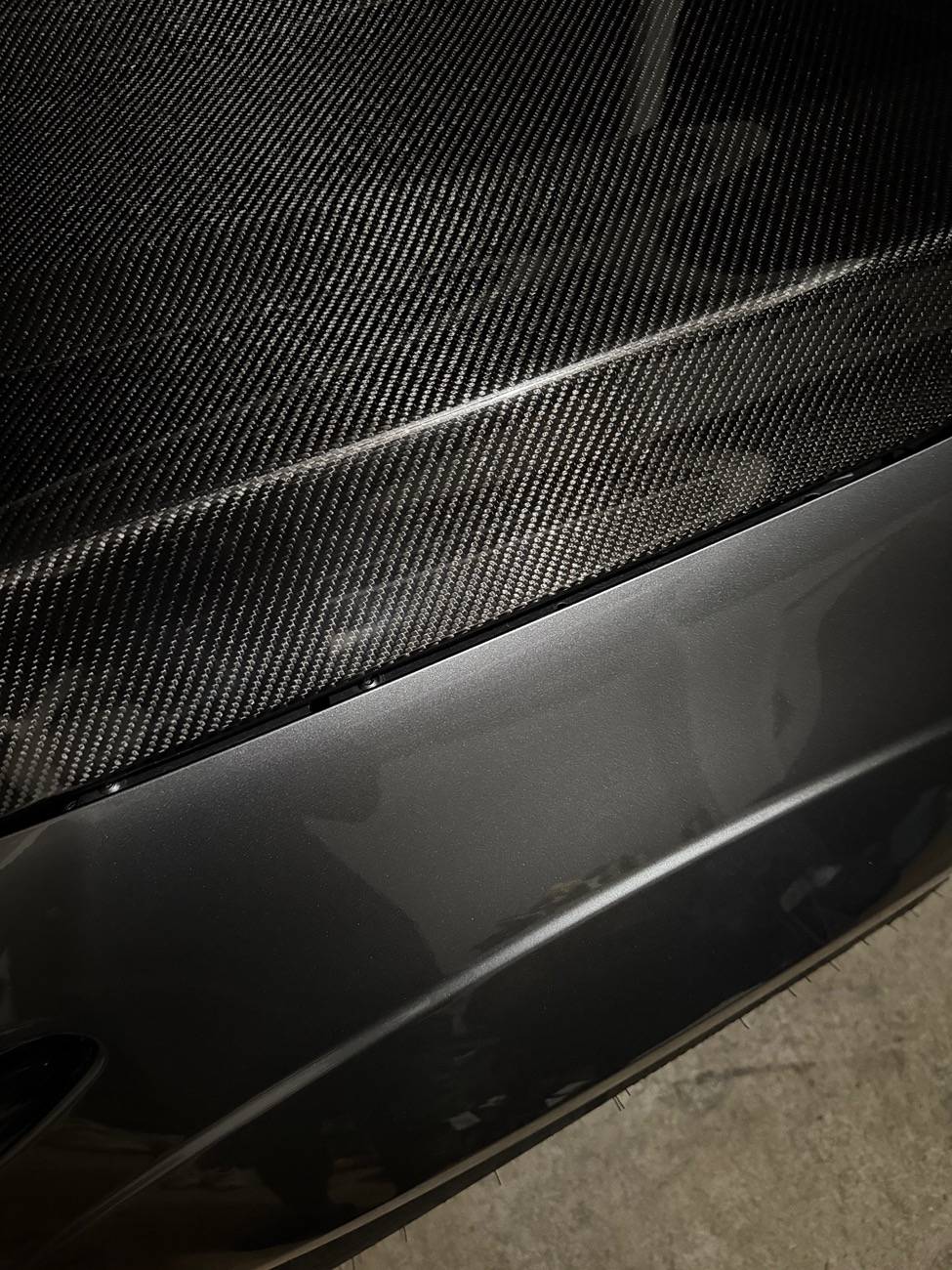

Swapped on a Seibon CF hood. Fitment is very nice and all the body/fender lines match up pretty spot on.
Some teaser pics as I plan to have ppf installed before I reinstall the hood vent piece. Then, I’ll try take some better pics.

Very cool! How much does the cf hood weigh as compared to the stocker? I looked on seibons site, but they don't mention weight.

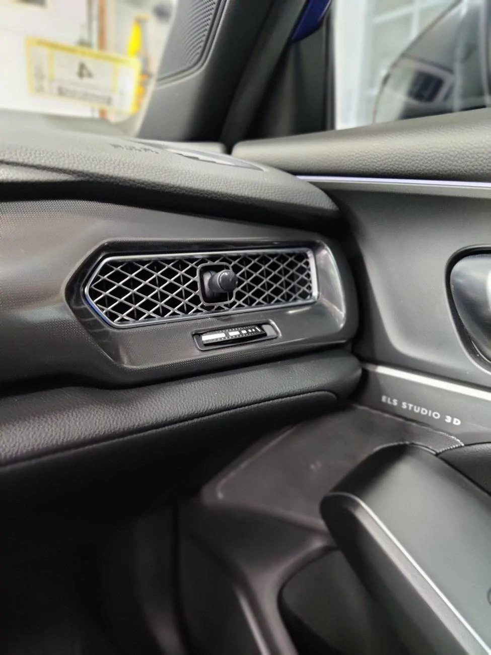

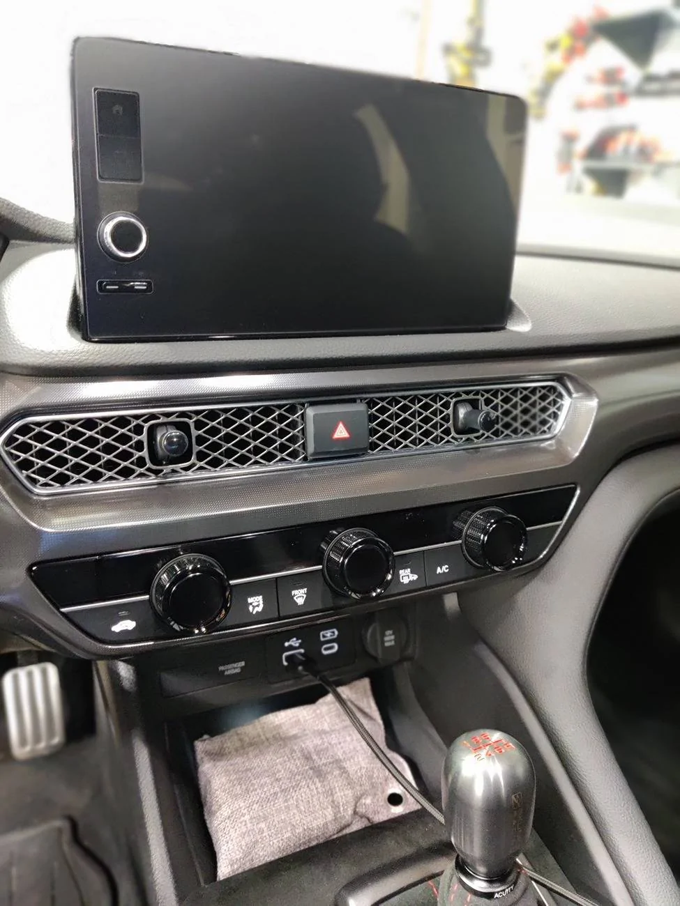

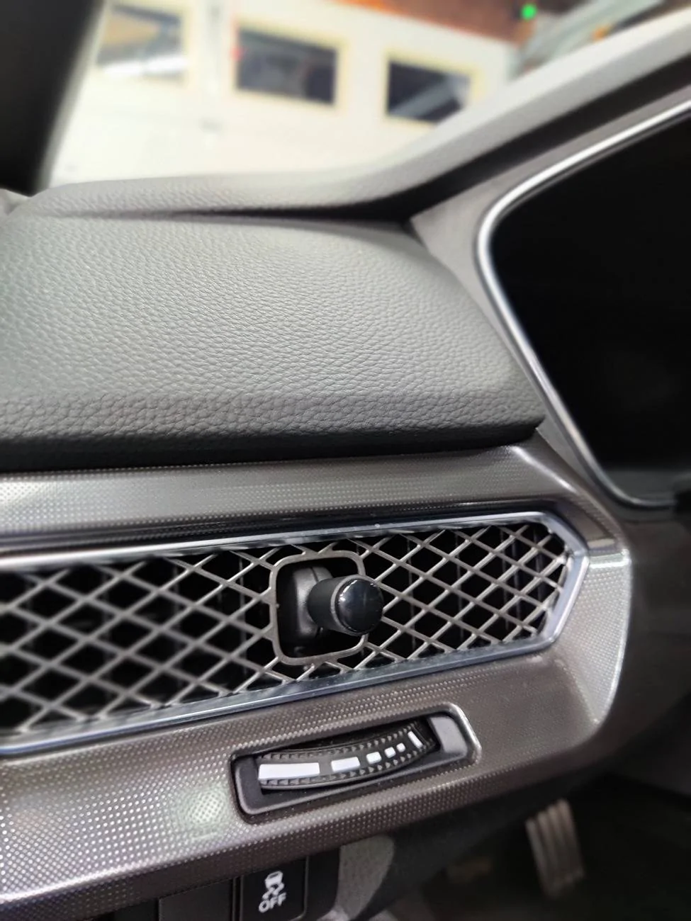

Checking in with my most recent ventures down the modding hole. Didn't want you guys thinking I called it quits with modding or something.
Did the "Racing Black" conversion for the HVAC dials and vent arms.

Which model had the black vent arms? I know the dials came on the accord.

Black dials are off of the Accord and HRV (cheaper to buy used)
The vent arms are off of the CRV (much cheaper to buy new)
P/Ns below for the vents (you scavenge them for the arms)
(2x) 776133a0a01za (passenger's side vent), these are cheaper individually but require a little more work to get the arms swapped
(1x) 772453a0a01za (center vents, pair), these are a little more expensive overall but easier to swap out without having to swap arms, you can swap the entire center vent assemblies. Still need to swap out the arms for the driver's and passenger's side.
You could also just get 4 of the passenger's side vents and swap out all the arms if you're on super tight budget but the savings is only about $5 overall. Better to get the center vents and 2 side vents.
I'm working on a replacement for the volume knob but I haven't come across an all black knob that would work yet.
