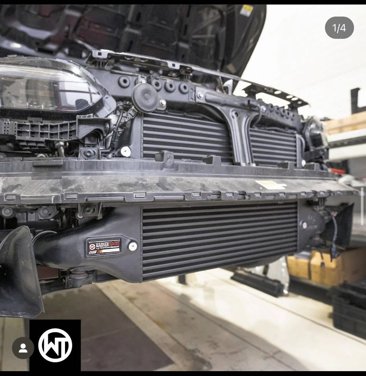

The PRL is significantly longer and thicker (yup, waiting for the jokes). Actually think there will be better airflow with the Wagner due to fin design and being almost 1.5 inches thinner. So although it looks massive, it should fit nicely. Here it is in the FL5, which I did get confirmation from them directly it fits US spec.
PRL is also bar / plate, as opposed to tube / fin. The Wagner should allow a lot more flow to the radiator. Will be interesting! I wish it didn't require proprietary charge pipes. I like how the HPS pipes are mostly metal and less likely to flex w. pressure.

Are the charge pipes included in the price? I think it would be a better option as it would mean they could control the diameter throughout the entire run, as opposed to with PRL where you will always be limited by the IC inlet and outlet diameter to match up to OEM. I do love my HPS charge pipes though.
Just be warned, when I was getting a Wagner for my last car, it was not a drop in process, lot of cutting and relocating involved. Nothing serious, but certainly more than what was involved with putting the PRL on. It is quality stuff though. Wonder if you can relocate an oil cooler in front of it to offset some of the decreased radiator flow. We have a ton of room in front of the IC on our car, even with the thicker PRL.
