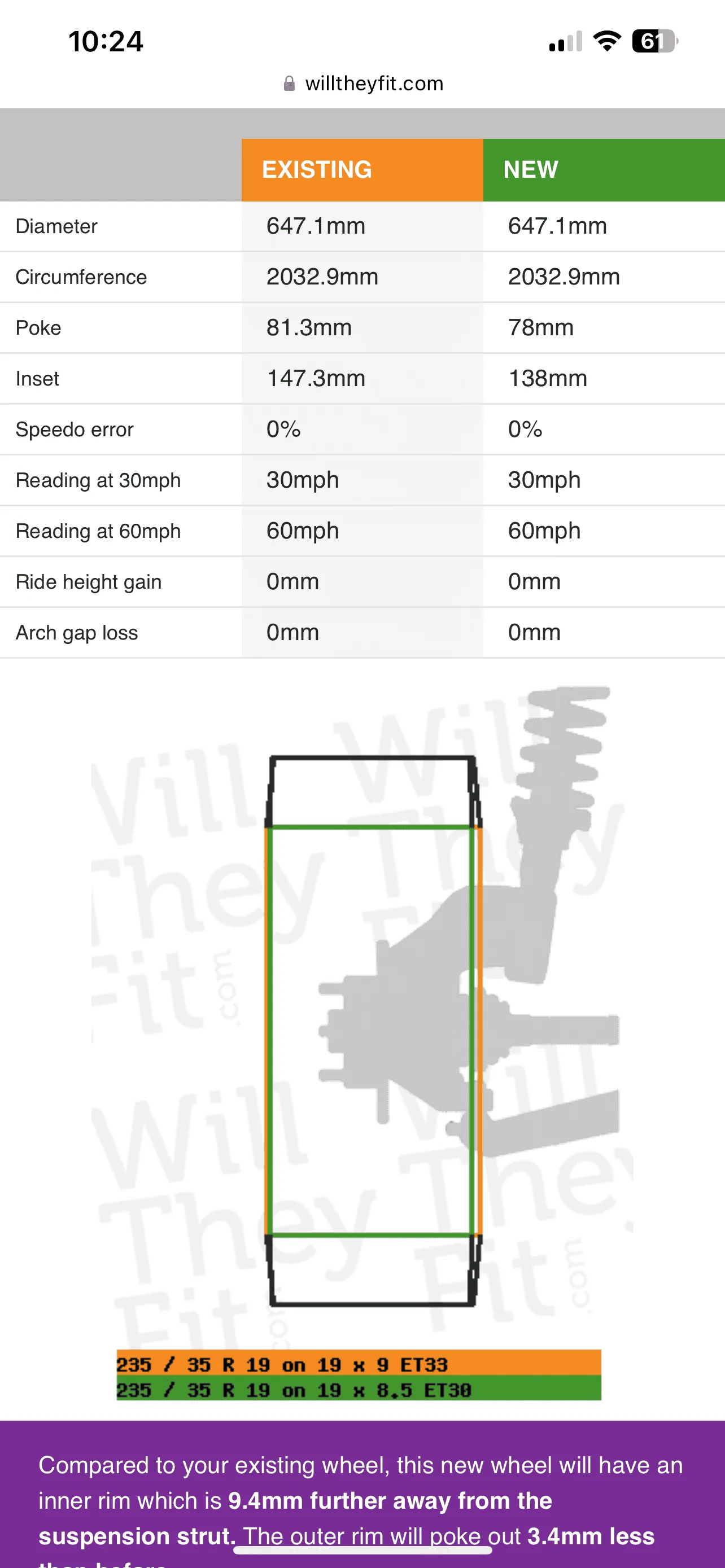

Recently got some wheels 19x8.5 with a 30+ offset any recommendations on tire size guys kind of new to this I’m also lowering it on ebiach springs
I would highly suggest 235/35/19 all around. The overall diameter most closely resembles the stock size. Any other size will start looking awkward.
Hey man thank you so much for the answer I think that's what I'm going to go with I just don't want no rubbing issues or anything

You won’t have any rubbing issues at all. Your wheels will be slightly less aggressive than mine (3mm less poke). Overall it will look very similar, with a tad bit less tire stretch.
sounds good thank you for running the specs for me as well been trying to figure it out but it gets a little confusing once I get everything install I share some pics with everyone here
I would also say 235/35 is the best for 19s, the ride is still fairly good even though the side wall is kinda thin
Just need to be careful around potholes and such
So I ended up getting the 235/35 tires and I was just wondering if I could go with a meatier tire I feel like im always going to scrape the wheel and you were definetly right about the side walls I was wondering what other tires I could have gotten?

You could go w/ a 235/40 for a much meatier tire but your speedometer will be off. A 245/35 will be slightly thicker side wall but may not look good on certain wheel, depending on how wide the wheel is
235/35 is the only real option if you want to keep the OEM diameter
https://www.willtheyfit.com/
you can play around w/ this link and see how off the speedometer will be and how playing around w/ tire sizes changes the overall diameter
