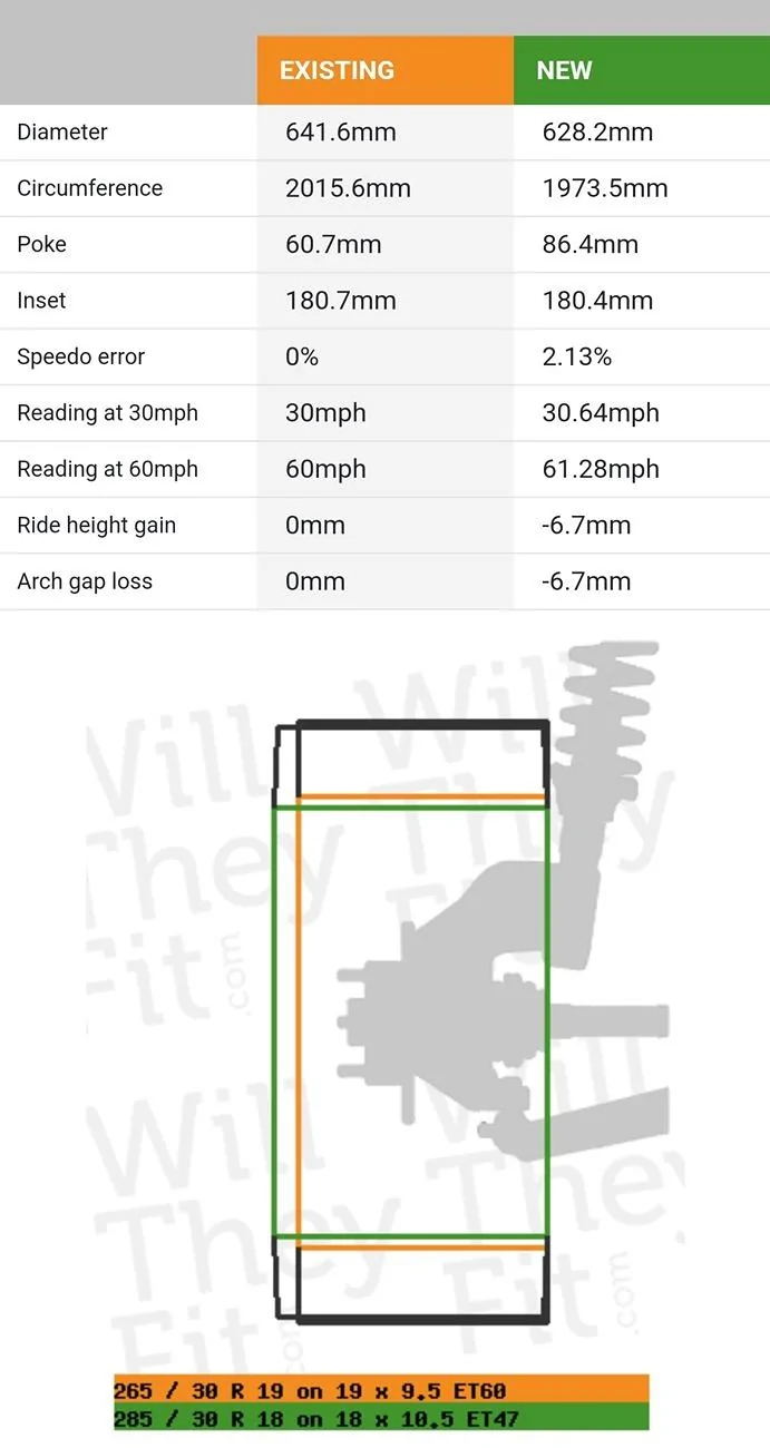

Yeah that's REALLY aggressive... but you're probably not wrong. I don't think 10.5 with 285s would fit without rubbing though so there would be more implications beyond just wheel and tire selection.
You'd need to pull the strut pins and max out the camber, but with any performance driving you should pretty much already be doing that on this car.
The key I think is proper offset. 47 seems about right and you'd gain roughly 18mm more poke with a wider tire. Inside clearance would be the same, but the fenders leave enough room on outside when I measured.
At the end of the day, if a 265 on a 9.5" with a 42mm or lower offset will fit, a 285 on a 10.5" with 47 will fit. Especially with shorter total diameter.
Acura Integra Type S Winter Wheels / Fitment Specs Screenshot_20240821_133953_Chrom

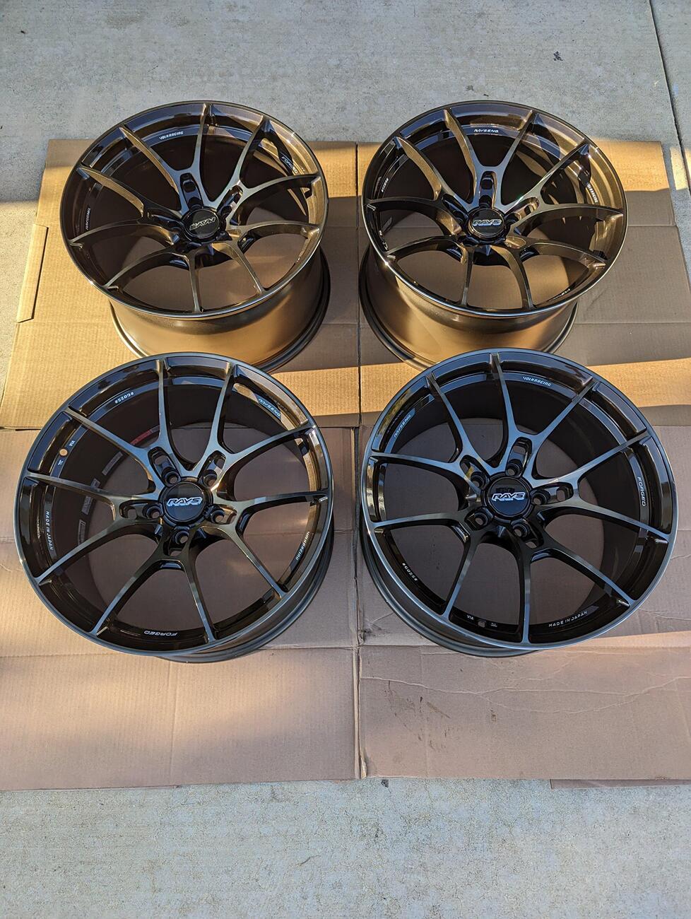

I have seen those.. its in a green color so negative $$ since i would have to get them stripped and powder coated.
Huh?
Acura Integra Type S Winter Wheels / Fitment Specs 1724270673529-31
Where is green anywhere in this picture? These are a gloss bronze. "Dark Amber/Clear" to be exact...
Not green.
Acura Integra Type S Winter Wheels / Fitment Specs 306284166_8064669923606491_1894606055336117393_n
3,443
2,932
Huh?
Not green.
? Some reason i read emerald. I guess i picked up a slight tint and assumed the word.
That offset is kinda out there. I think they would poke out too far.

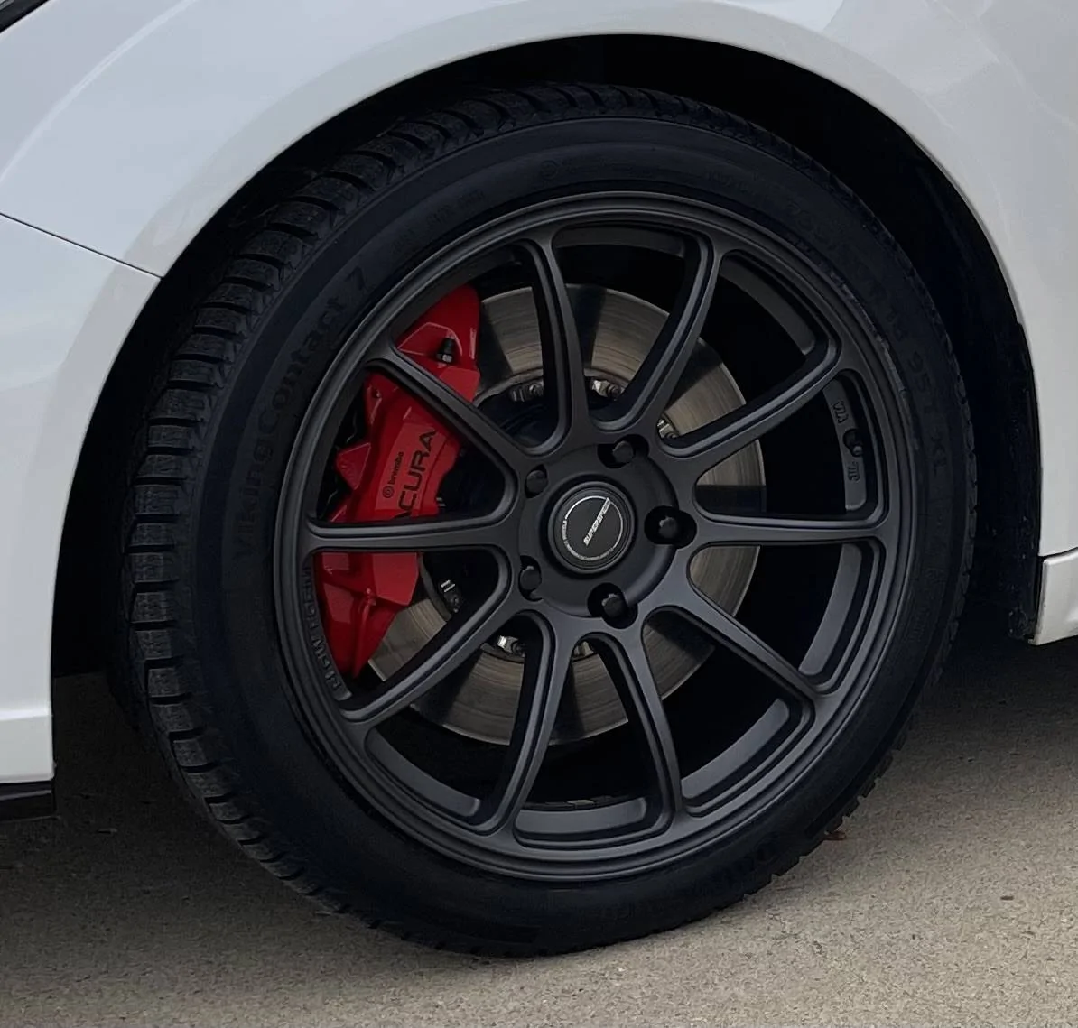

Here is what I did today, my winter setup. Superspeed wheels on Conti’s.
Got them from a Wheelsco, TMPS was supposed to be preprogrammed but it’s not working…sigh. I went for a thorough drive but still don’t sync up. Guess I’m heading to the dealer Tuesday.
A bit late to the party but can you give me the specs of your wheels? Is it 18x8.5 ET35 ?
I really like the look and need to order mine asap. Just wanna make sure everything fits well. :)
Thanks!
