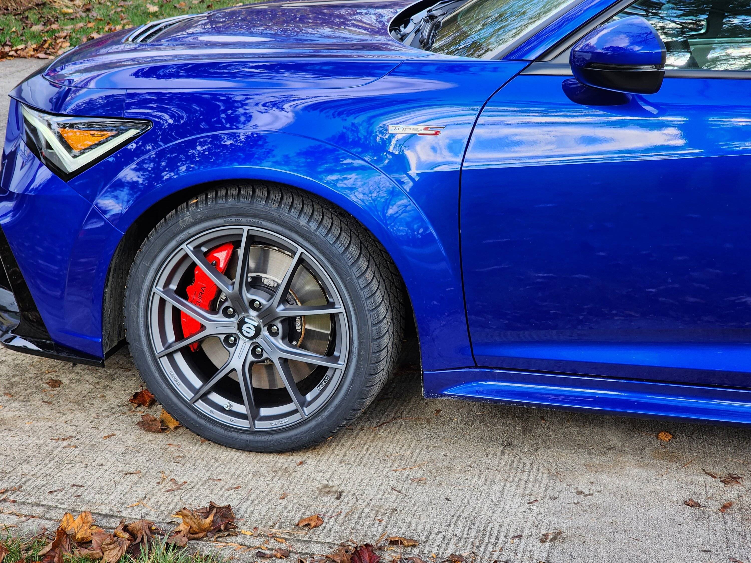

As promised: pics. I think they look pretty good especially for the price. Also was happy with tire rack, they came with a socket, instructions, centering rings on the wheels: very easy.

Put the winters on yesterday. Wheels sit at the same spot as OE. Handling is quite affected with 18x8 (+40) wheels and 235 tires. Will have to be careful driving with those...
Replying to myself:
After driving the car again today in colder weather, handling is not that bad.

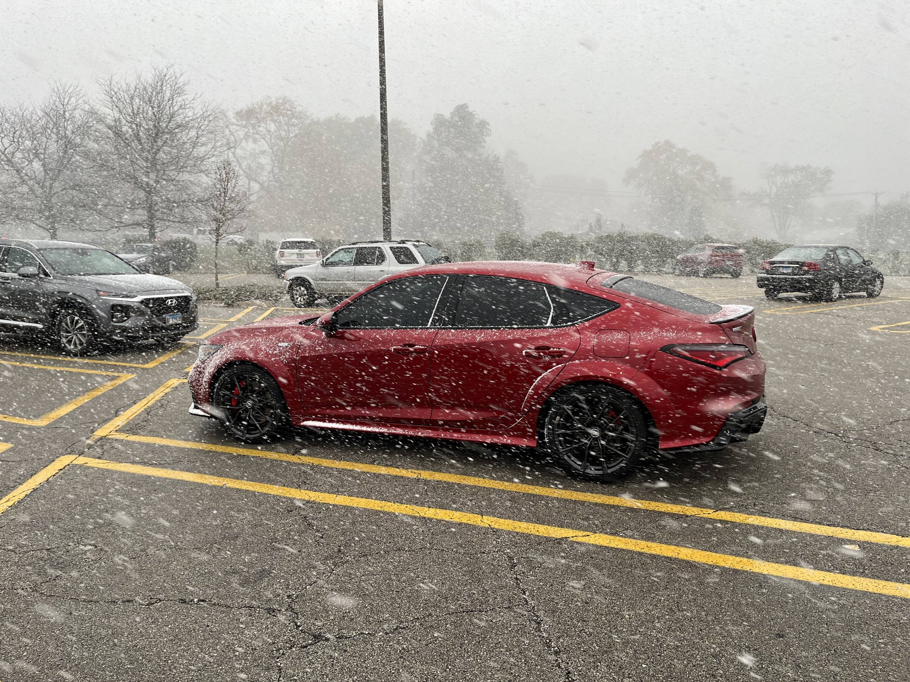

Got the winters on just in time. First snow in Chicago. 255/35/19 on oem
Looks good! My setup will be similar. I’m getting the P Zero 265/35/19 this Friday. Stock black rim for winter and bronze for summer. ?
