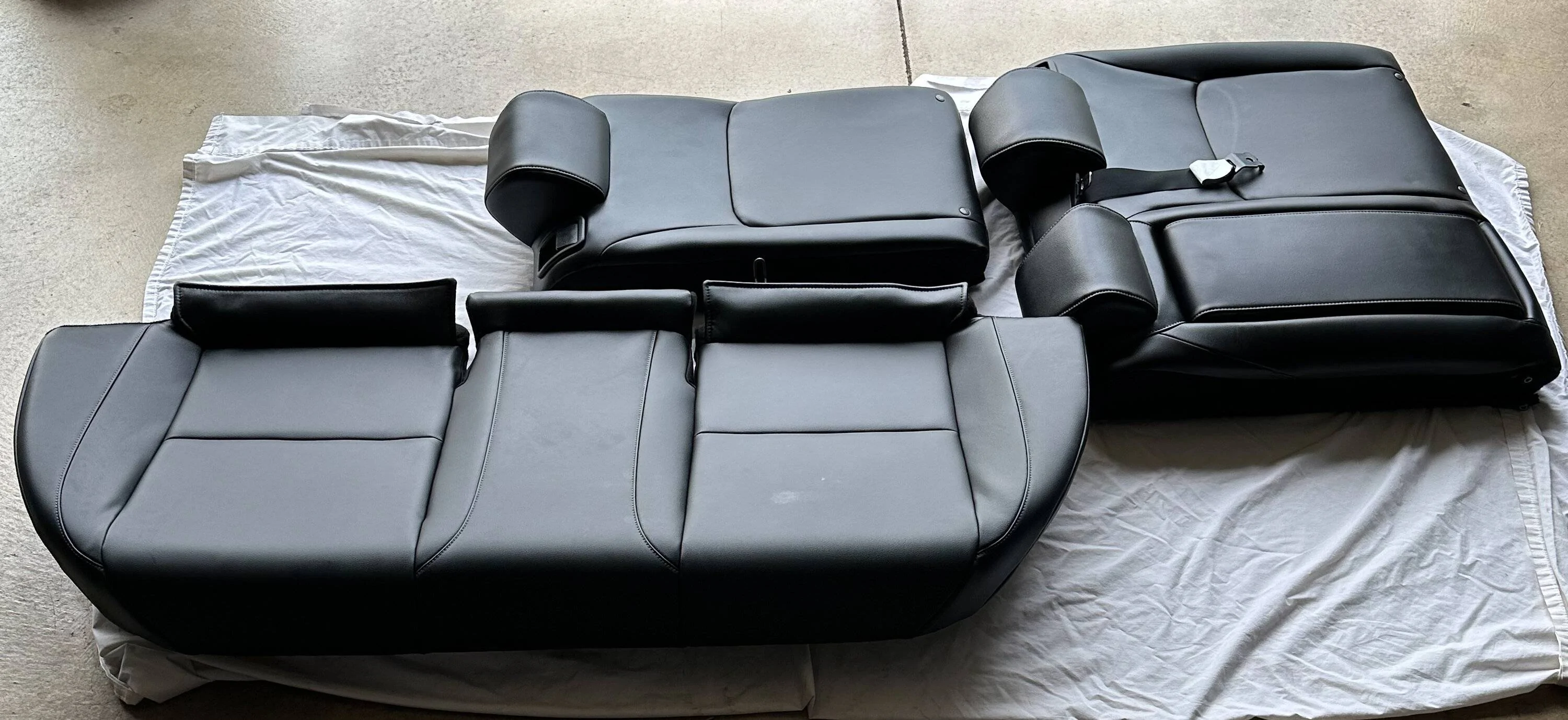

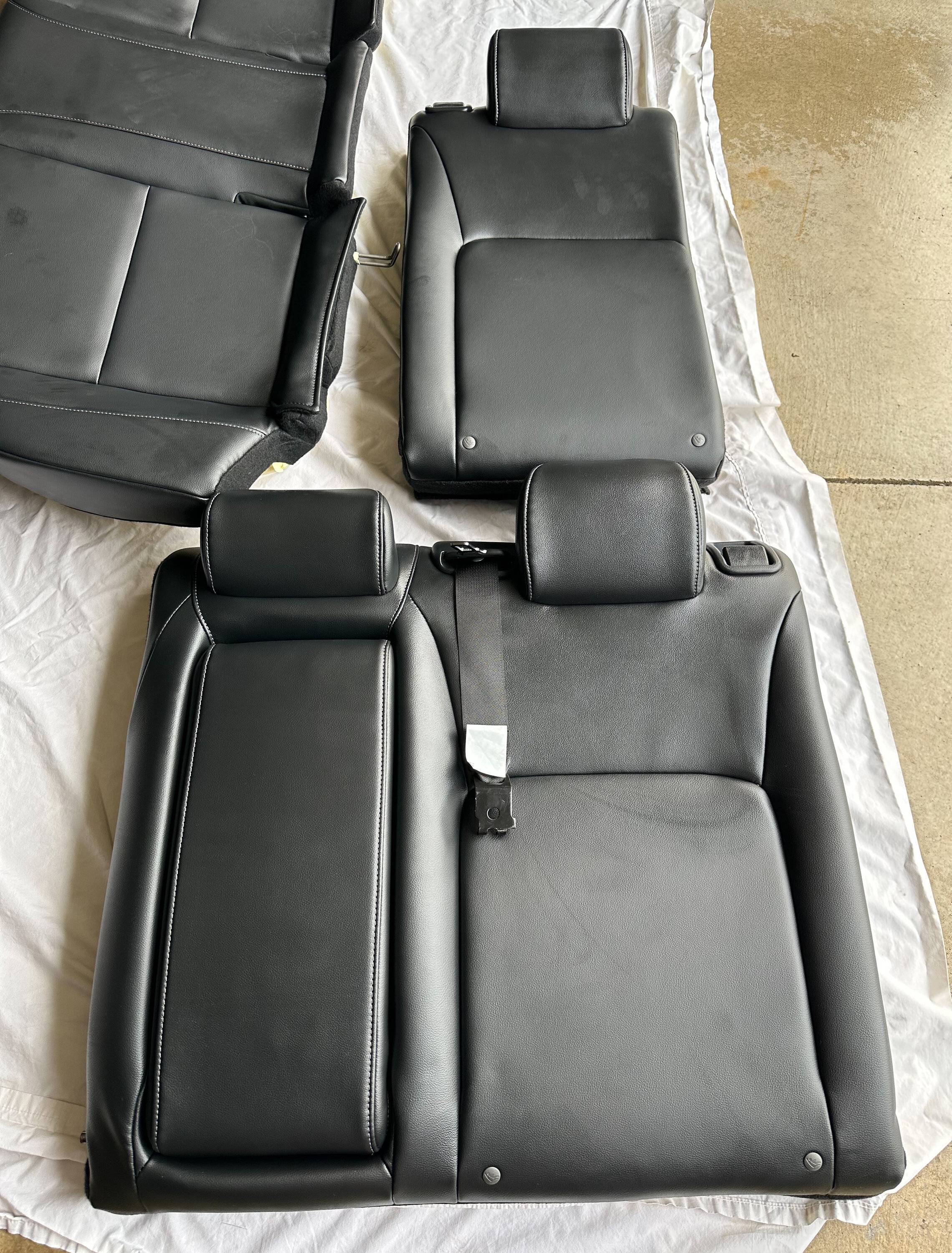

I have a 23 ASPEC tech with black leatherette/suede
Will trade any combination of black for red!
edit- pics. Sell or trade my ASPEC rear seat complete with middle seat belt
