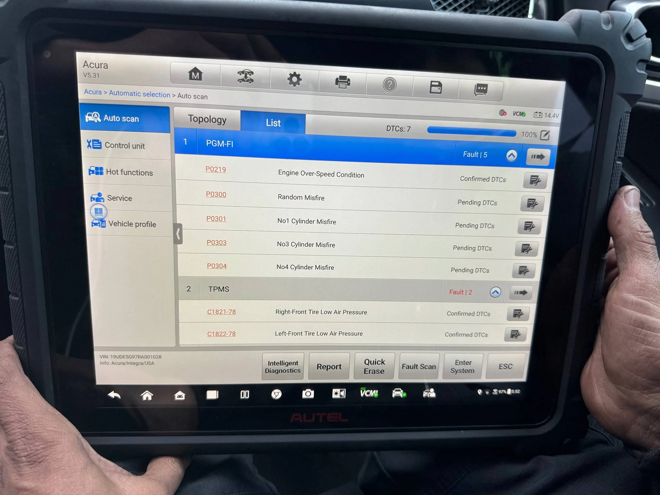

+update! I solved the issue!
I plugged in a high end OBDII scanner, and I found the issue, it went into a limp mode but there was no warning lights I attached a picture for you guys, hope that helps! I just cleared the codes and back to normal, pop pop pop ??

hmmm. what was the specific code you reset? "TPMS" line in the pic above?

Isn’t that the tire pressure monitoring system? And huh, guess that’s what happened to my car and it went away, thank god. Amen either, glad it’s fixed!
Yeah it shows every code that was ever presented, I took my car to Las Vegas Motor Speedway and lowered the tire pressure for more traction, also i remember exactly when the car went to limp mode
so basically I did the peddle dance, and on my 3rd run I sent the car tooo hard and some notification on my dashboard turned on and I ignored it since I was focused on the 1/4 mile run, ā€œI’ll see what it says once I’m done with my runā€ that’s what I thought. Then when I was done with my run the message was gone, I never had the CEL on though.. which is why I was puzzled the whole time, I guess the notification on the dashboard was that the car went into limp mode but I never noticed it. I was too excited about racing that I didn’t even notice the lack of pops till later
glad you got it figured out.
I reset every single code that was saved on it, I did a complete reset

just to clear the confusion, the code that was causing the lack of pops and crackles was
P0219
the misfire codes were caused by the limp mode which makes the ignition timing retard while I was pushing the car pretty hard

What scanner do you use?
