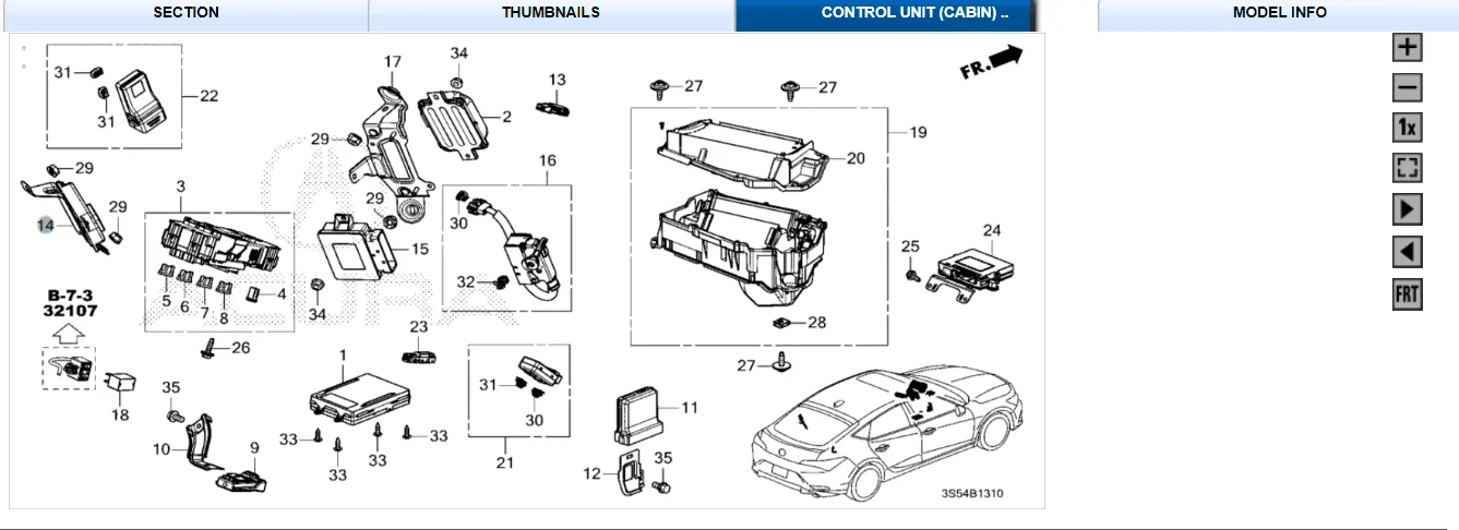

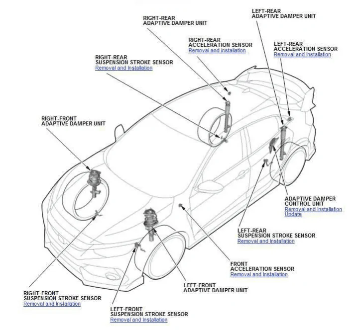

I'm looking for an Integra Type S owner that is willing to take apart their car and find the part number for the ADS module. It will be huge for the Type R community to verify if this module can be swapped out to soften our suspension modes. The dampers are the same on both cars so I think there is a good chance it will work and not throw any codes.
For anyone that is wanting a stiffer ride for their Type S putting a Type R module in might do the trick.
On the FK8 it is behind the plastic panel on the left rear of the car. I believe it is in the same location on the FL5/DE5.
I've tried to find the part number online but no Acura websites have 2024 models yet. Thank you!
