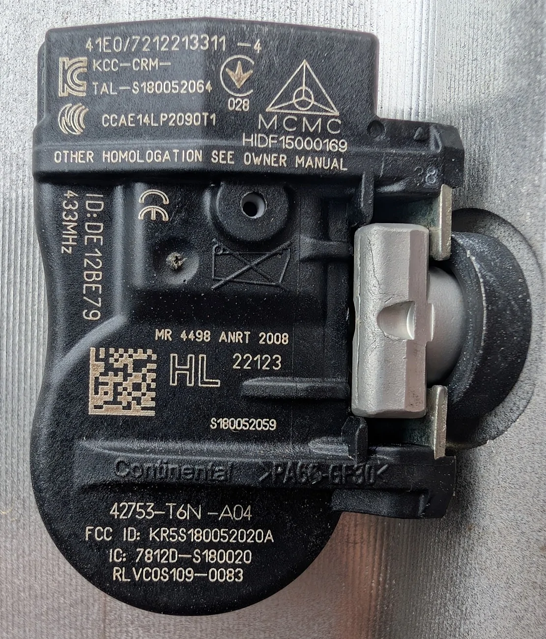

FYI here is a pic of the OEM TPMS Sensor and it is indeed 433mhz
Yeah they're continental.
I got them cheaper from the dealer than from continental directly. Oddly they came in a sealed Honda baggy which had a sealed continental baggy in it, because we clearly just like making trash... 8 plastic baggies for 4 sensors 😑
