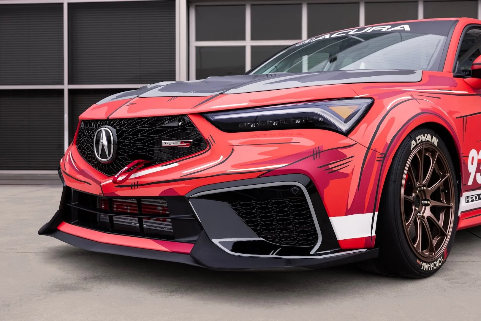

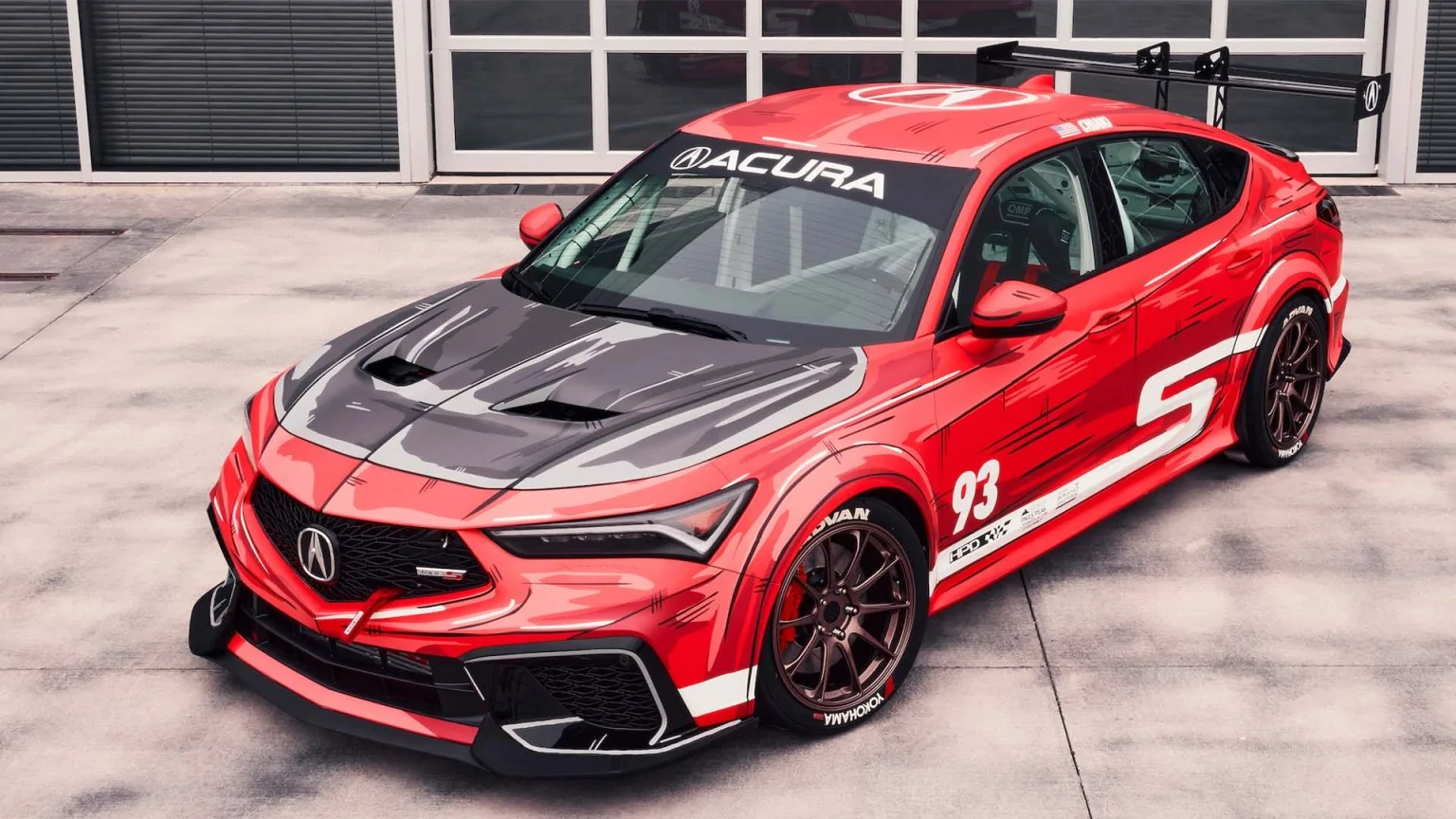

Why not do what they did with the Pikes Peak DE5? It looks like they just used the HPD/HRC FL5 strap and trimmed off some of the front grill. Requires drilling a hole in the crash beam and trimming some plastic behind the bumper.
Acura Integra Tow Hook Options 1784660965454-jf
https://dreamshop.honda.com/s/product/hrc-tow-strap-kit-20222026-civic/01tUT00000AehBlYAJ
https://www.civicxi.com/forum/attac...4710fg2jg000_install-guide_v01-bw-pdf.259916/
Acura Integra Tow Hook Options 1784660623661-x9
You could certainly do that if you want a flap constantly poking out of the front. It would scratch up the bumper fairly quickly and wear it down a lot after time. I prefer something to thread in only when necessary since this is just a street car that sees track time 6-10 weekends per year. My other car gets permanent mounting because it's not a street car...
I guess you could shove it back through the grill when not needed, but the fabric hooks would still damage the bumper/grill with any towing done with them because they're flexible.
Would certainly work though
