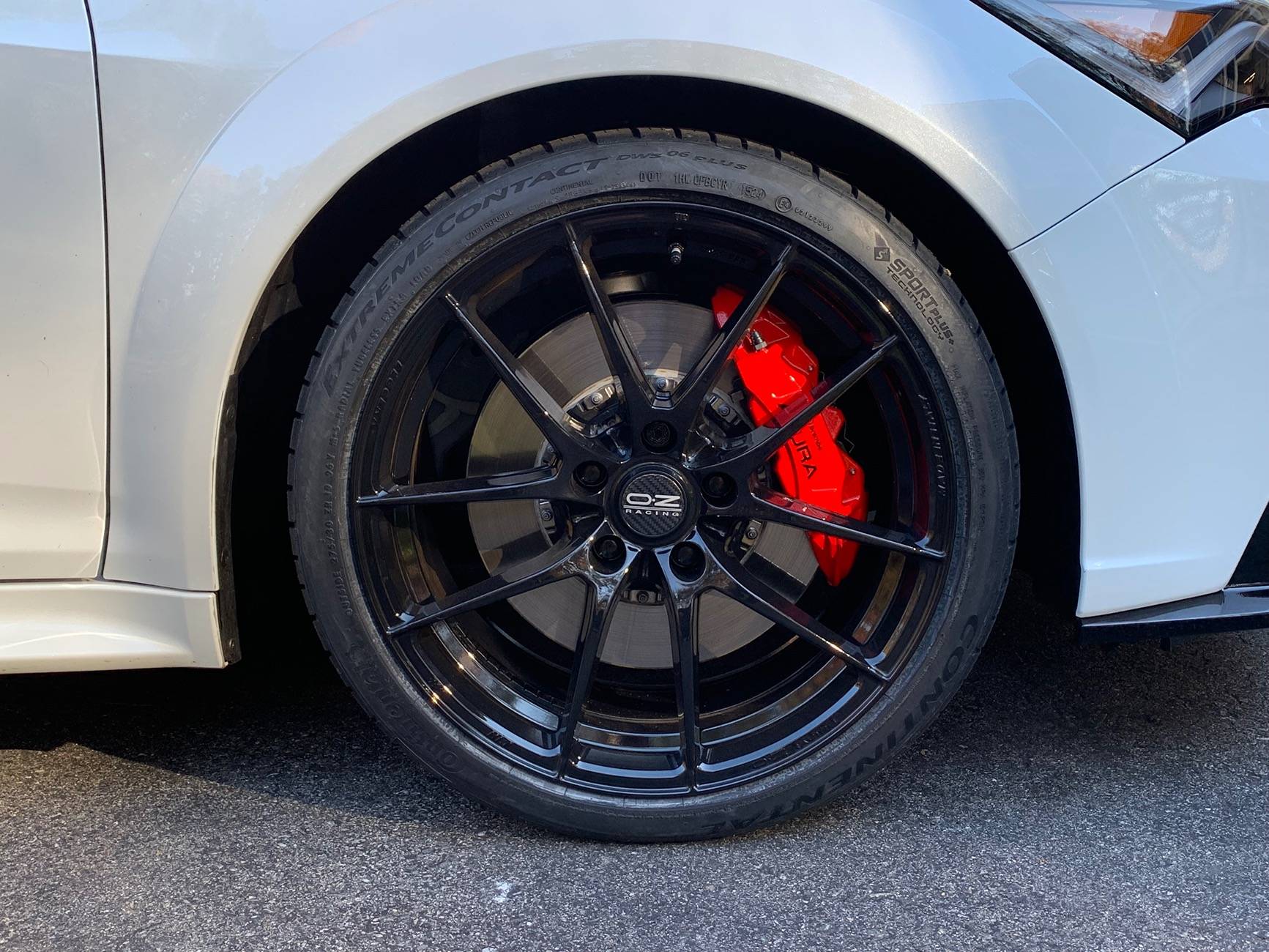

I have 19x9.5 +51 offset and run 275/30-19 all seasons (dws06+). I think there are a few people running the 35 series without an issue, but I drive in MA/RI and find my setup comfortable. The 275/30 gets you a hair more width and sidewall versus stock, and in my case it was less expensive than the 265/30.

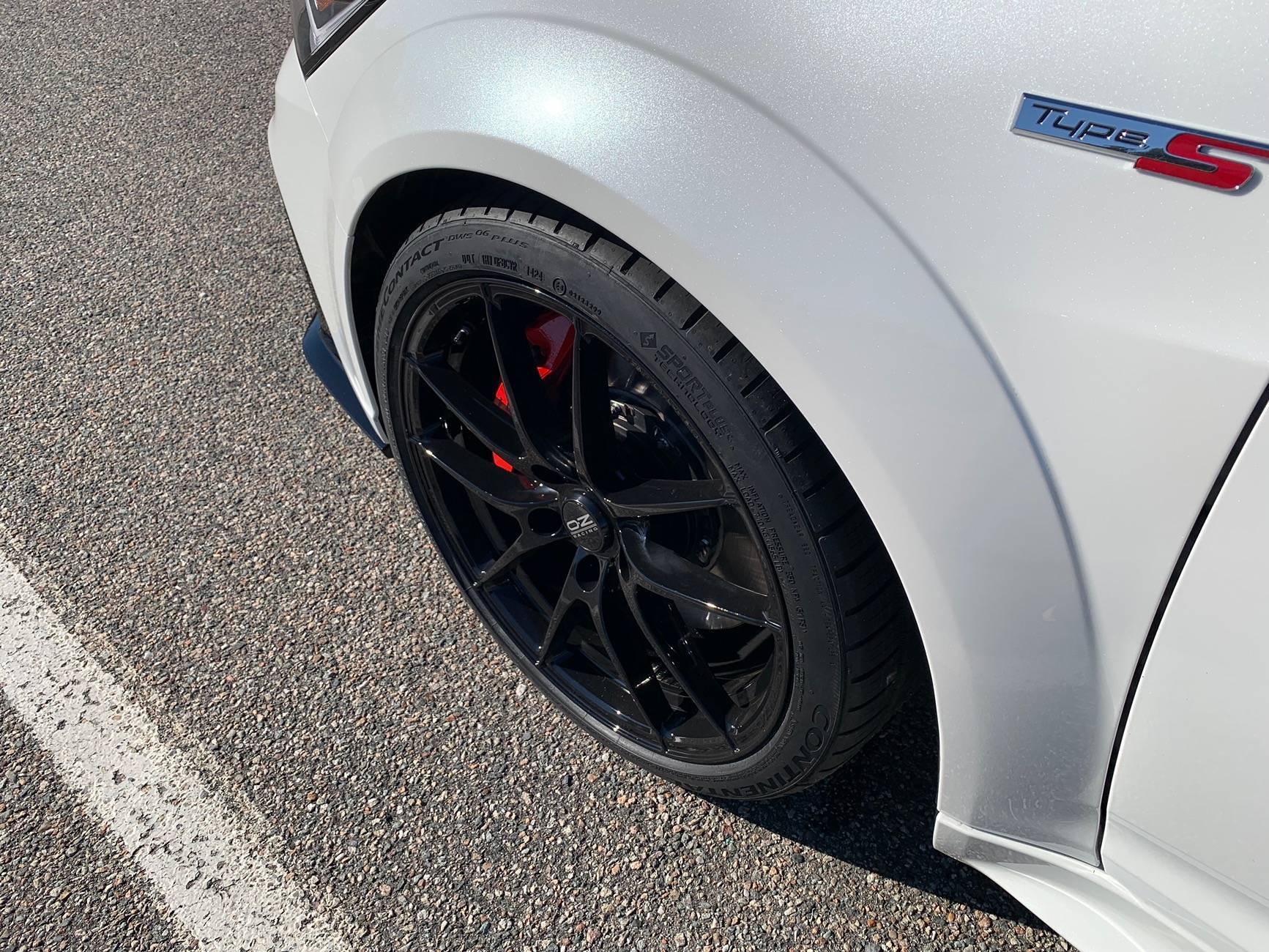

The tires are great. I didn’t have to drive in anything too messy this past winter, but they handle well and feel comfortable down as cold as we had… maybe 10-20 degrees? Most of the roads I drive are not too awful, so I don’t have to deal with a lot of surprise potholes or anything like that. I thought about going 18’s to pick up that sidewall, but wanted to be able to swap tires across my stock wheels. So far I’m happy I went that route.
Pic is from when the tires were first mounted and before I cleaned them up.
Thank you for the detailed info, I will go with 275/30/19.

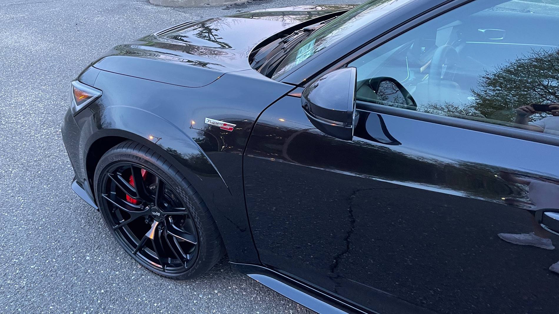

I just got the same wheels… and I’m just using the pilots that came with the car. Using them as a summer set. I also have the continental extreme contacts, on the stock wheels for winter. I live in NY, and they are a great tire. A little softer feeling, and turning isn’t as tight as the Michelins but they are great. I think the continental feel better on the stock rims, but the Michelins feel amazing on the apex, way better than how it felt on the stock rims.
This might be a good ideas since I still have the OEM wheels and can use it as a winter set. Thanks for the feedback.
