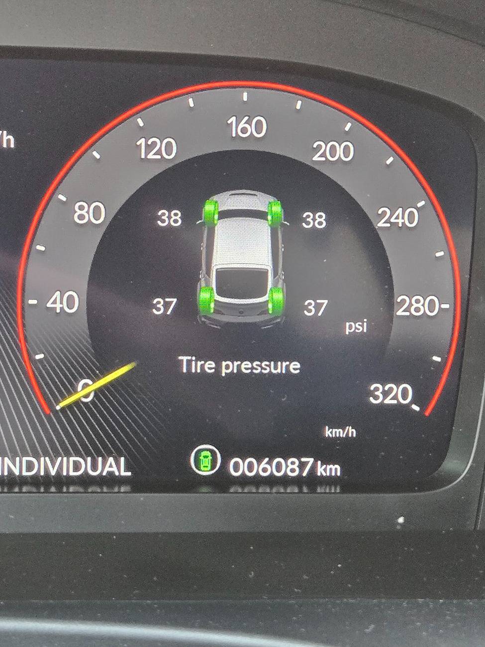

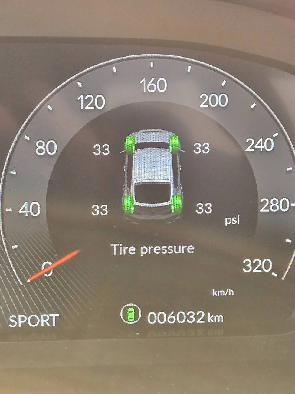

For normal.street use, I would just put them within your normal range and forget about it. In routine street use, you will not notice the difference caused by ambient temp change or driving. A seasonal adjustment from summer to winter temps is normal, but otherwise I don't believe there is any benefit in micro-managing it.
Agreed, I just keep in range. We have a large ambient temp swing where I live.
