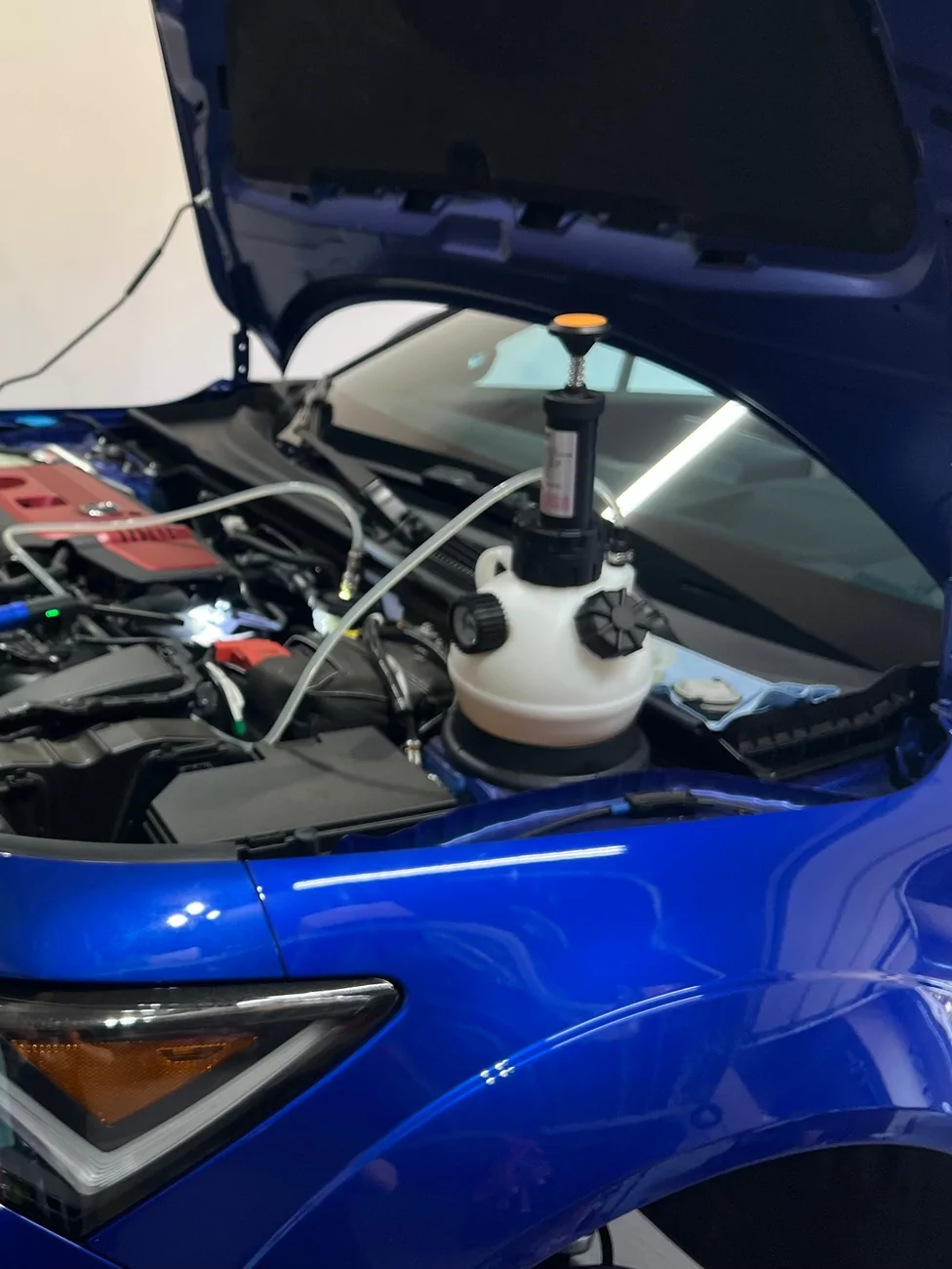

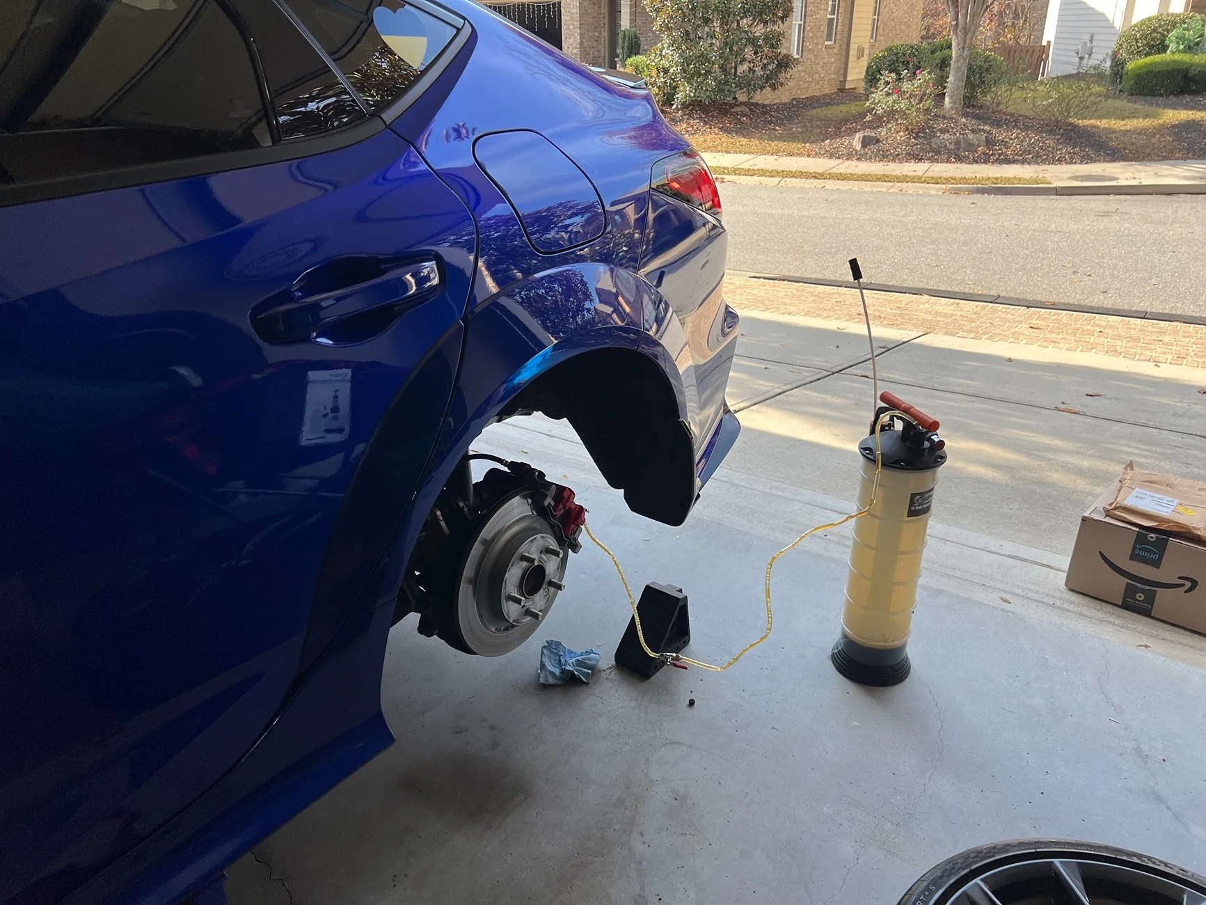

I just bled my brakes on Type S using a break bleed pump. It was pretty simple doing it yourself.
Acura Integra Speedbleeder Recommendations IMG_2751
Acura Integra Speedbleeder Recommendations IMG_2750

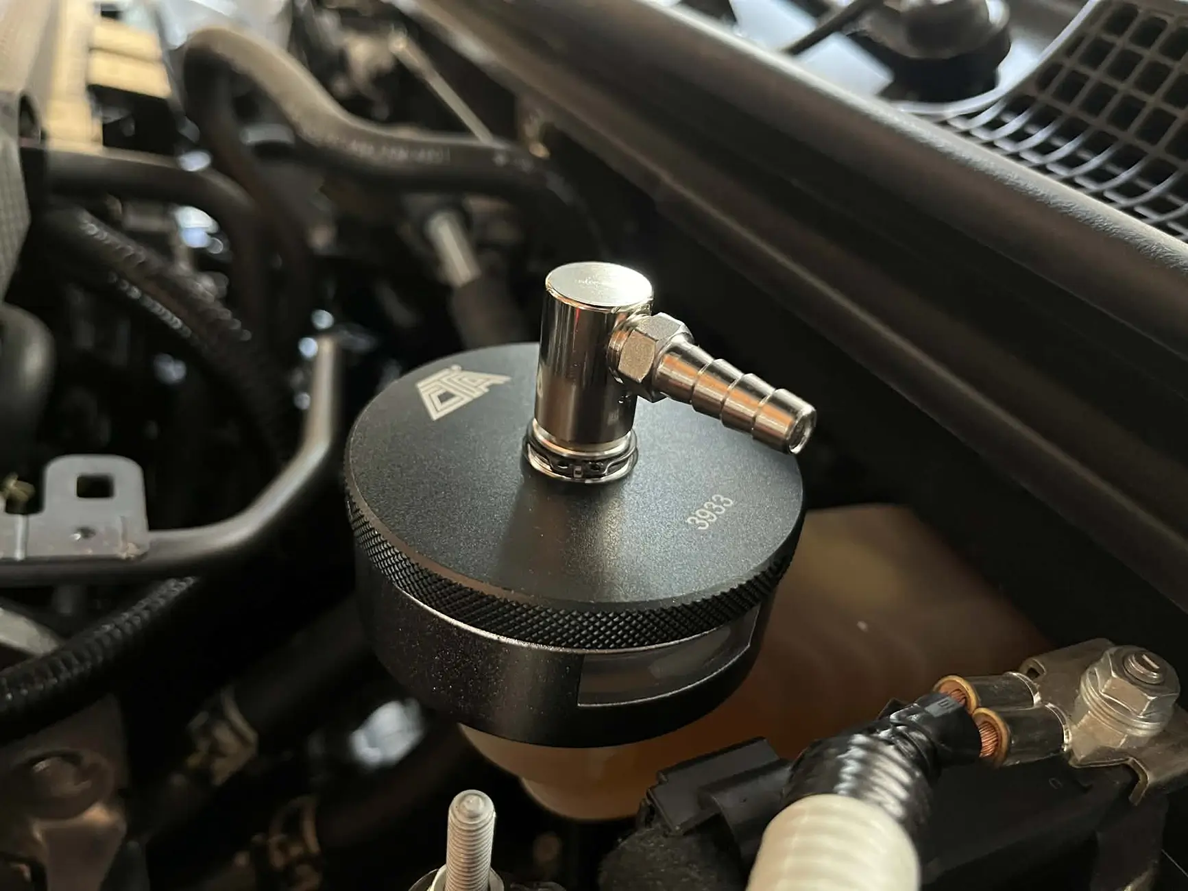

This is the adapter that I use, it works very well:
Acura Integra Speedbleeder Recommendations 1766256736608-0
I have more info about this adapter (and how I modified it to work with a Motive power bleeder) here:
https://www.civicxi.com/forum/threads/adapter-for-motive-power-bleeder.58885/
