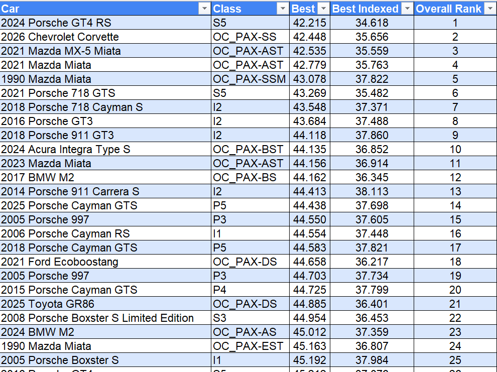

Limited sample size I know, but here are the Top 25 results from that day out of ~80 cars; 10 was me. The two Miatas ahead of me (one was co-driven) were also on RE-71RZ and SCCA coach-level drivers and configurations- and FWIW those two GT3s just above me ROUTINELY take FTD at most of these local events. The Ecoboostang down there is a Nationals-level driver. I feel like I left time on the course.
Acura Integra So "god spec" is it REALLY not rubbing? 1777749640080-wm
TL;DR, it "wakes the car up" from a suspension perspective the same way a tune does from an engine perspective. The tires helped, clearly, but the DSC plays no small role. I could NOT get the car to push or run out of grip. I finally feel like I have a ceiling left in the car again; where things left with the last event I did, I felt like it was easy to "overdrive" the car. No longer.
