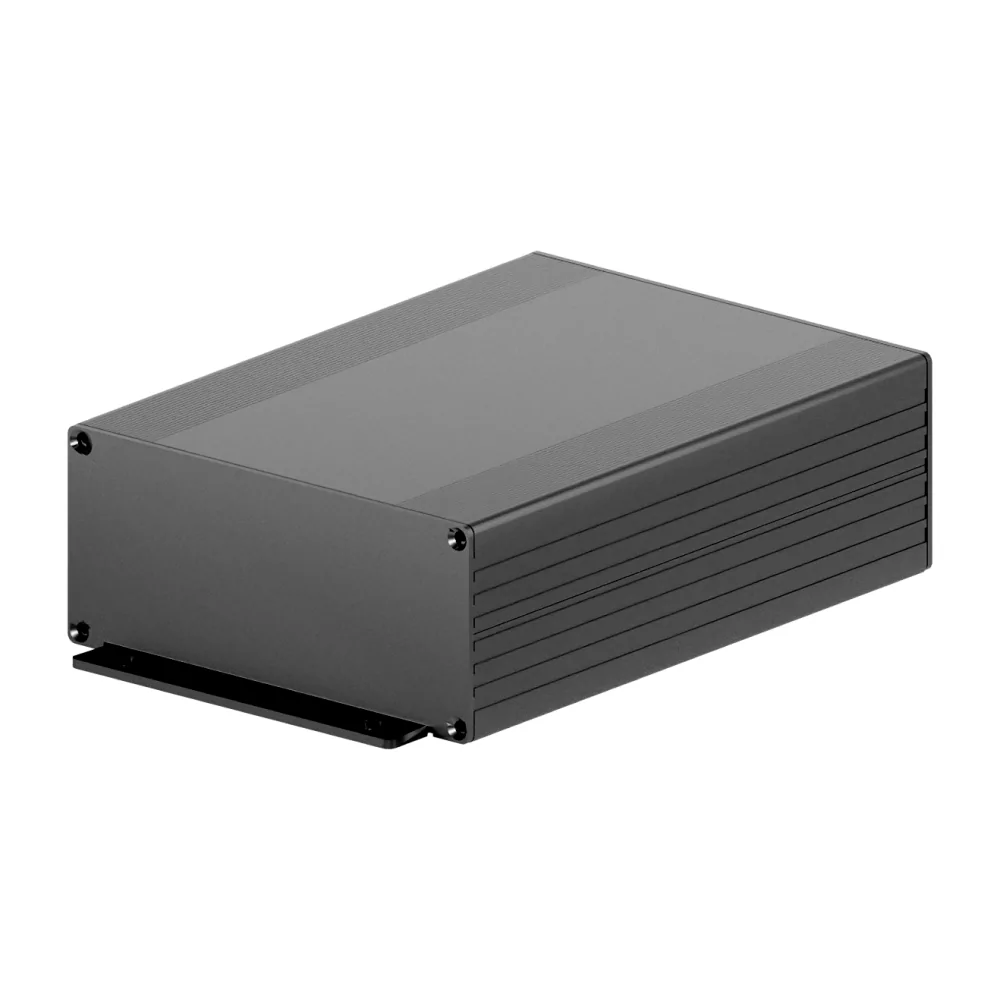

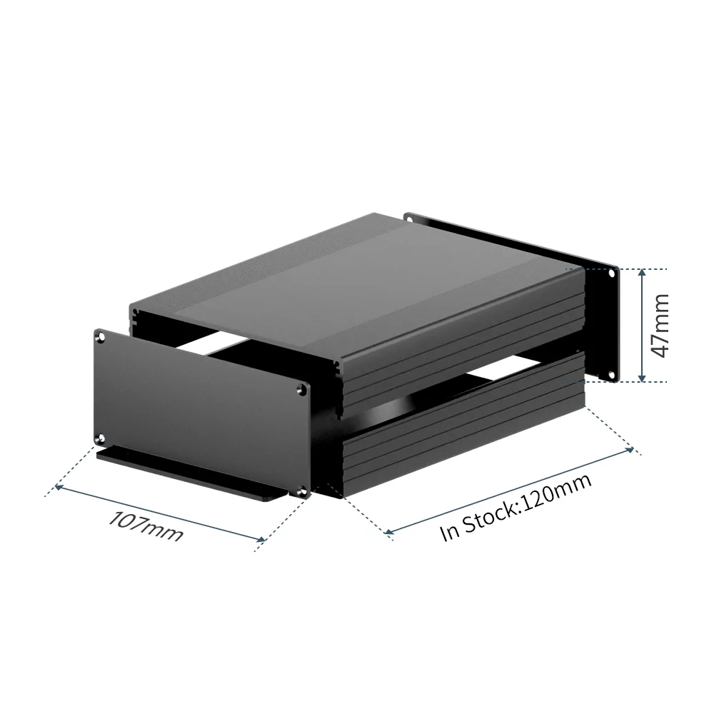

Oh, and by the way, the dimensions of the enclosure are 4" x 4.75" x 1.85", and the end caps have integrated mounting tabs for surface mounting if you like. I anticipate this unit will simply replace the factory amp, which is much larger than this is, so it can probably be secured into place inside the kick panel with zip ties, but the tabs are available to anyone who prefers to fabricate a custom bracket for a pro-level install.
Let me know any questions you may have. Talking through stuff gives me more to think about and helps me catch issues I hadn't considered. I appreciate your enthusiasm about this project! It's a ton of work but it's also extremely satisfying and fun.
Now for some pics - the enclosure, and the daughterboard. For the daughterboard, one of the OEM amp's connectors is so new that the manufacturer has not yet released a 3D step file for it, so it is missing from the 3D render pasted below. I've emailed them asking if they can send one - we'll see!

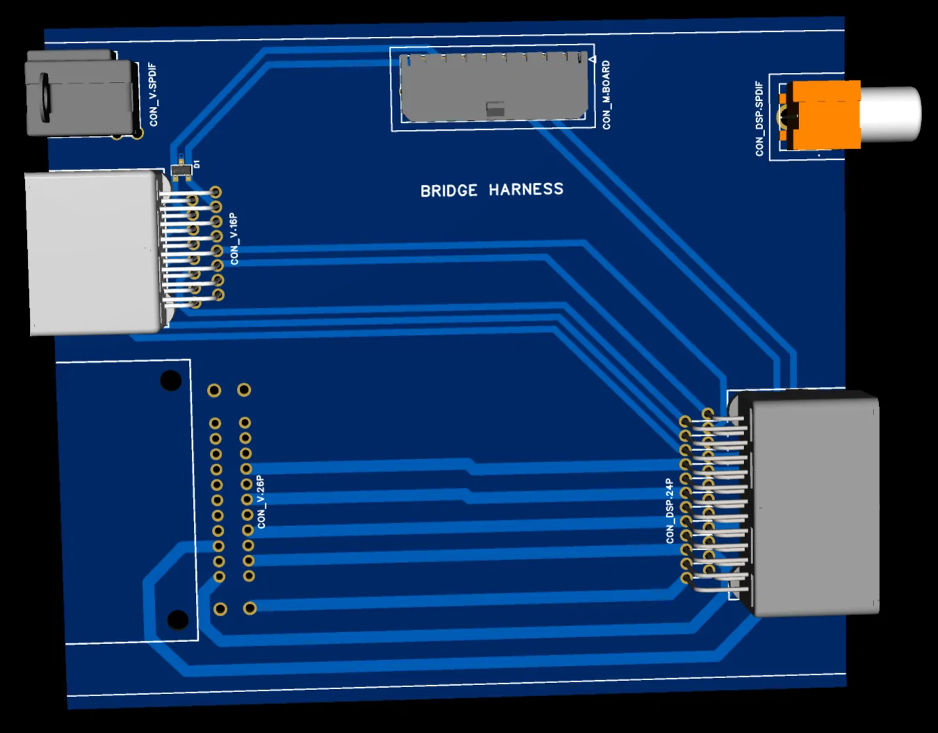

The motherboard contains all the logic for the volume control while the daughterboard houses all the power, I/O and passthrough signals, and consequently all the vehicle harness connectors too. Why does this matter? Well, I've learned that current gen Honda/Acuras do not all share the same pinouts across models. Even the Civic with Bose is slightly different from my Acura with ELS. So, to add new cars, I only need to develop a new daughterboard, which is much less complex than rearranging the logic circuitry just because the I/O has changed.

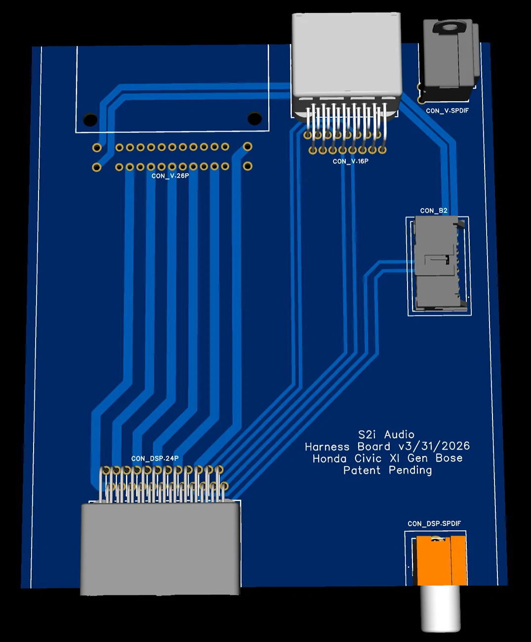

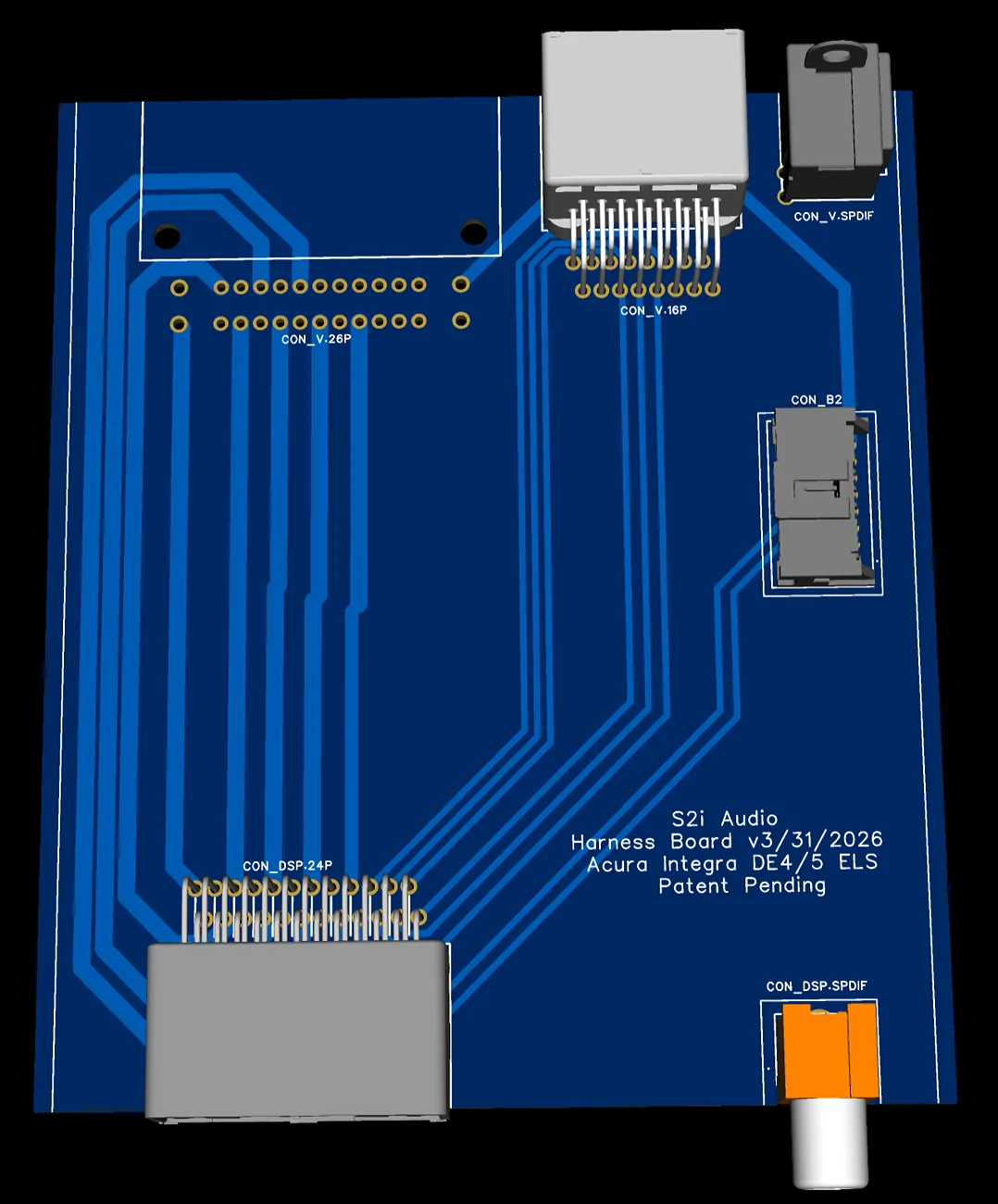

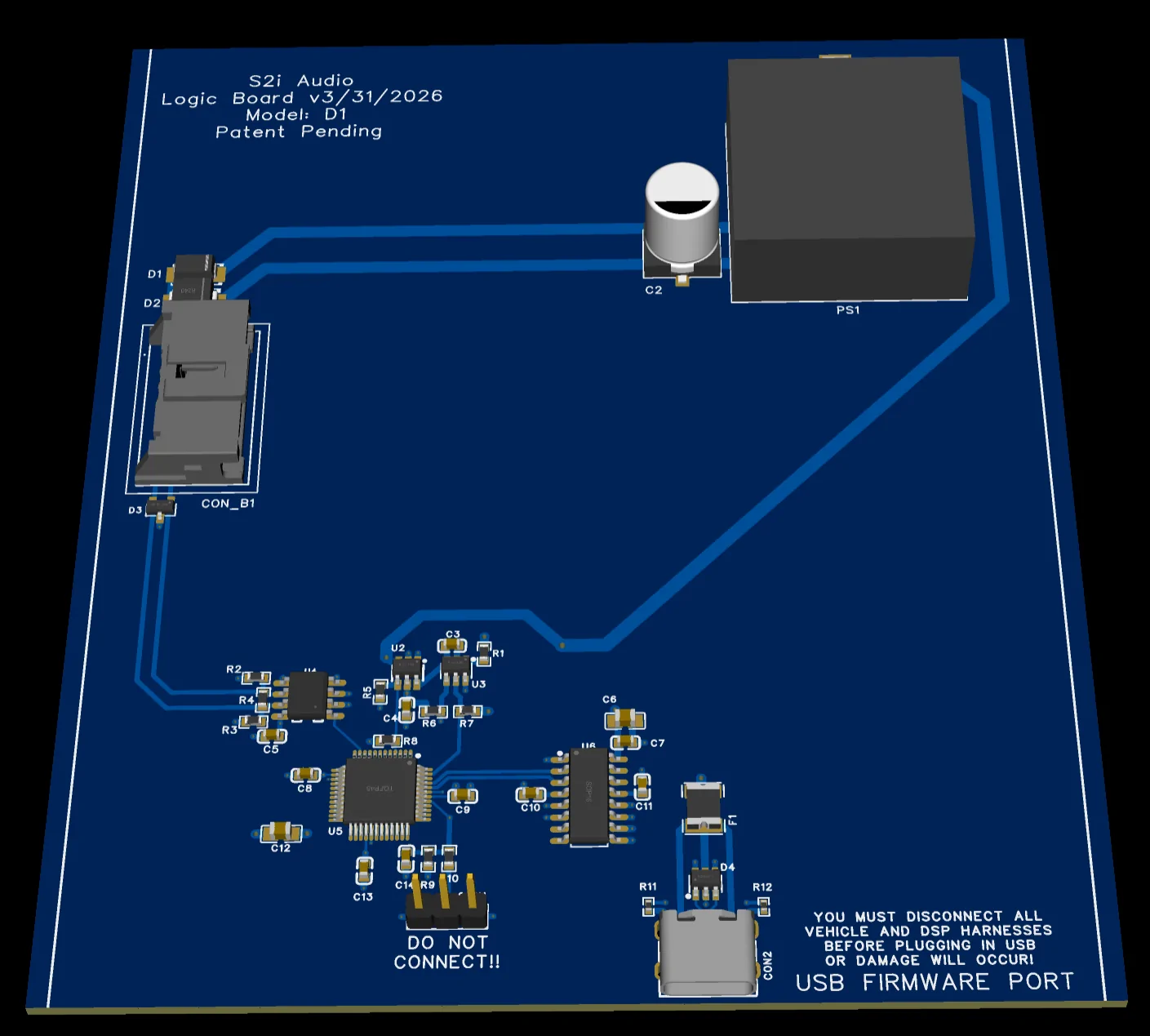

Including some glamour renders for giggles. On the daughterboards, there's one connector missing from the render because there's still no 3D model from the manufacturer, so you'll just have to imagine it's the factory 26-pin connector from the OE amplifier :ROFLMAO:
Logic Board (likely will be a standard part for all late model Honda/Acura cars):
Acura Integra PURE Digital Factory Infotainment Integration for ELS Studio 1775016232685-hh
Integra-specific daughterboard. Notice it only has connectors and no solid-state devices. This keeps the cost of adding new models down, and even allows the end user to side-grade to a different model if they change cars (to another supported vehicle). You'd just need a new daughterboard and a new harness if the pinouts differ.
Acura Integra PURE Digital Factory Infotainment Integration for ELS Studio 1775016243778-i
And the Honda Civic model. Note how the traces are markedly different. This is because of the different pinouts on the OE 26 pin connector at the upper left (the missing one, lol)
Acura Integra PURE Digital Factory Infotainment Integration for ELS Studio 1775016252281-dc
Note "CON_B1" and "CON_B2" in the two boards - that is where there will be a bridge connector between the two boards. All connectors and devices are automotive grade for longevity and reliability.
