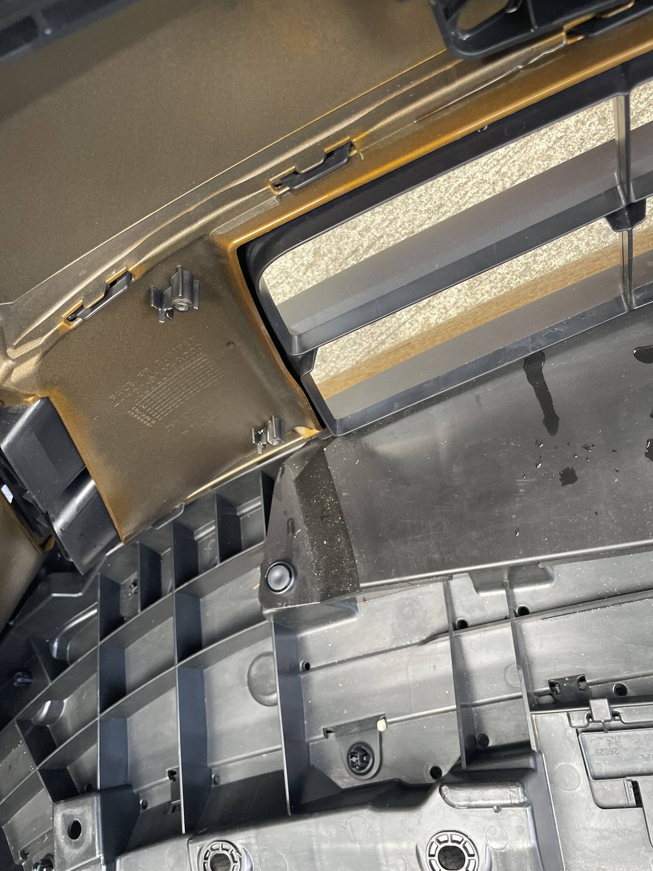

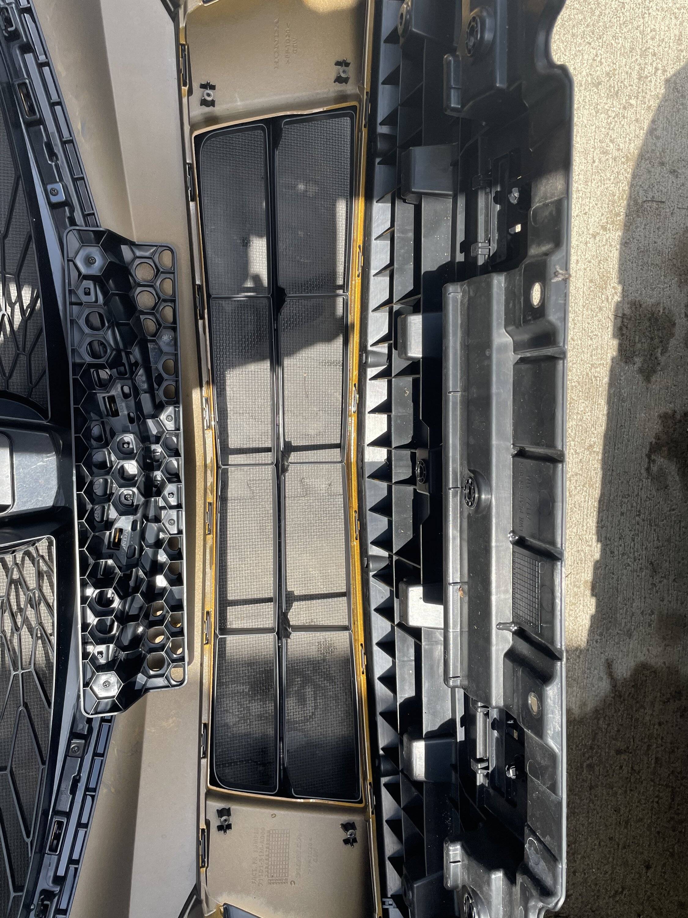

Everything you mentioned is fine to install on the DE5. Just note for the Downpipe you will need to order the TSP version instead as PRL no longer produces it (TSP bought their design to replicate).
I am interested to see someone installing the PRL intercooler though. I know for the FL5 you have to remove some of the air guides, hopefully that doesn't dramatically impact aero.
I did have to remove the air guides when installing the PRL Intercooler. The new Intercooler fills the opening edge to edge so I’m not sure there’s a big loss.
How's the drive with the new intercooler?
@Trajectory009
Thank you VERY much for the post and PICS... not many pics online that will show me exactly what my TEP will look like.
what method did you use to blacken the integra embossing on the bumper?? Looks super tight!
