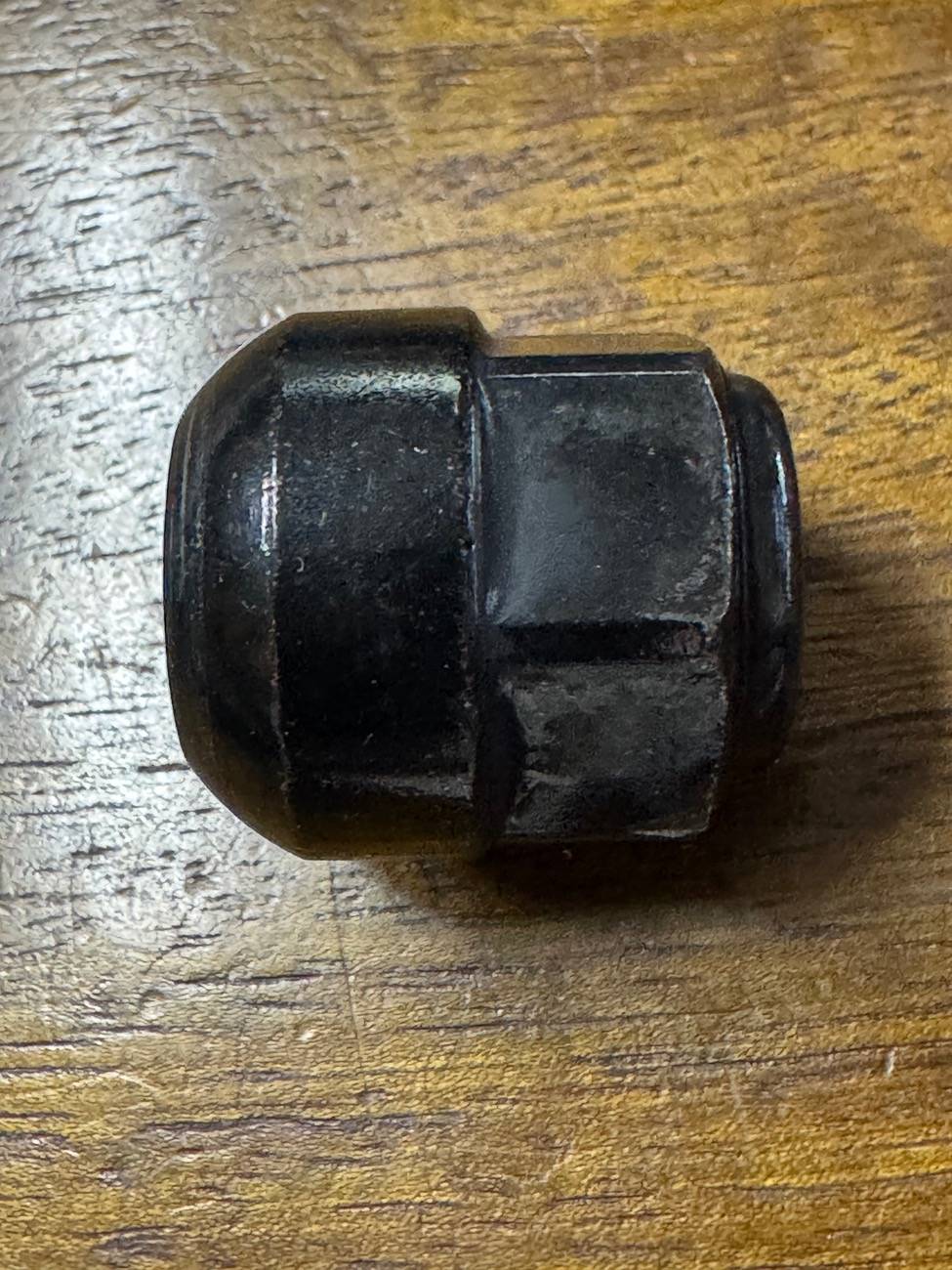

I just measured the oem lug nuts. They are 25.25mm at the seat, which makes them a 12.6mm radius. The better fitment would be an r13
1,869
1,310
Actually I take this back. The ball section is pretty shallow on the oem lug nuts. R14 is appropriate. You could fit an r13 without any concern as well, especially a deeper one.

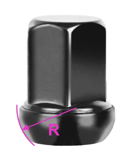

What did you measure? The radius in question is the radius of the ball and that is not something you can easily measure without a gauge or template:
Acura Integra OEM Lug Nut/Rim Ball Seat Specs rad50
Correct, you trace a path of the curvature and make a circle. The curvature of the ball area on the oem lugs is very shallow in this case, and most curved lugs I've seen are a fair bit deeper, to where you can easily measure the radius since it falls into the size of the lug max width.
In any case, this is a hub centric car. As long as you're not using a cone, any 14mm rounded ball will fit. Whether that's r13 or R14 won't make the biggest difference, but 90% of the lug nuts out there align the bolt size to the curvature size, so a 12x1.5x34 will be typically r12 and a 14x1.5x34 will be an R14.
The game is different for lug bolts... They must match the correct seat in every case because if they don't the bolt can wiggle back and forth. Studs don't wiggle like bolts.
