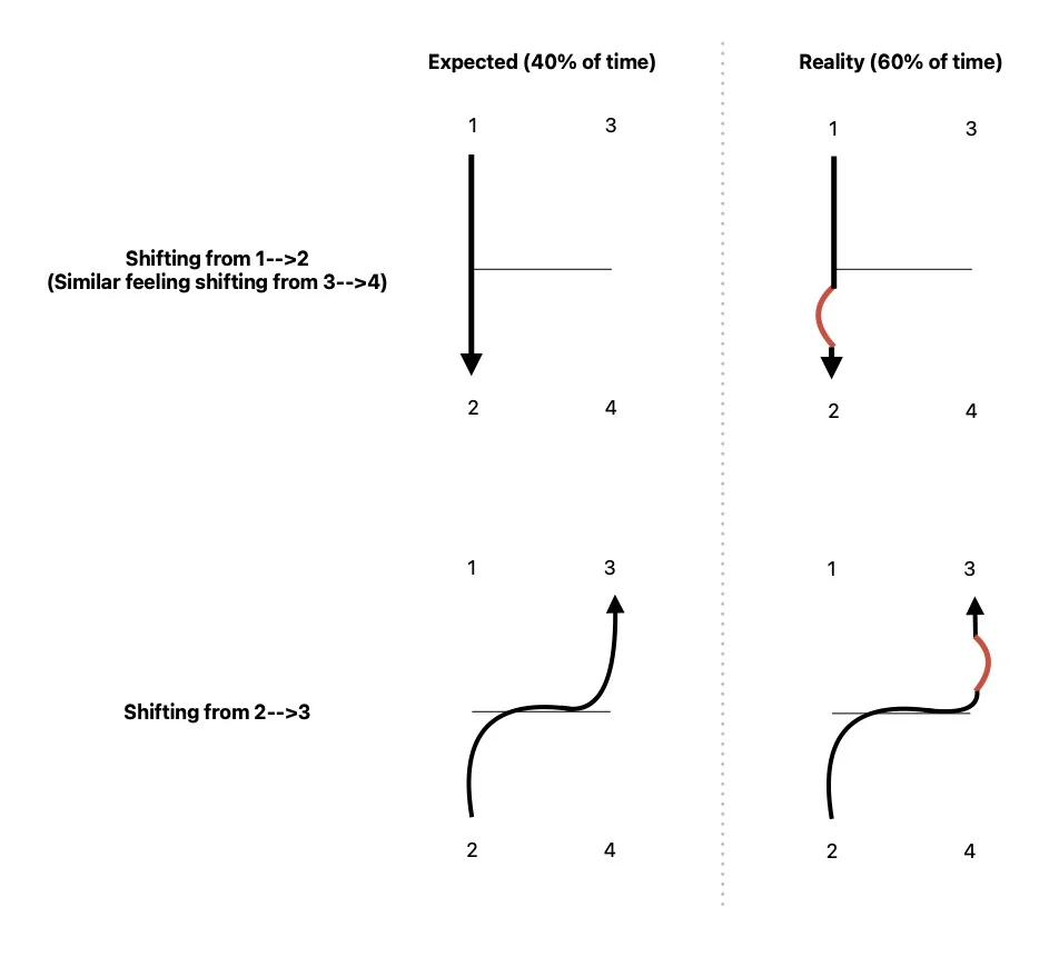

I just want to clarify, what I am experiencing is the "bumps" in motion of shifting while the clutch is fully engaged. I am talking about the feeling in my hand. It's not about gas and my foot motions to connect the clutch and engine (but I get your comments.)
Attached is an illustration of what I experience. See the "red" bump. I would expect when I shift the gear, the movement of stick should be straight and smooth. But about 60% I feel like "metal" bump in the motion.

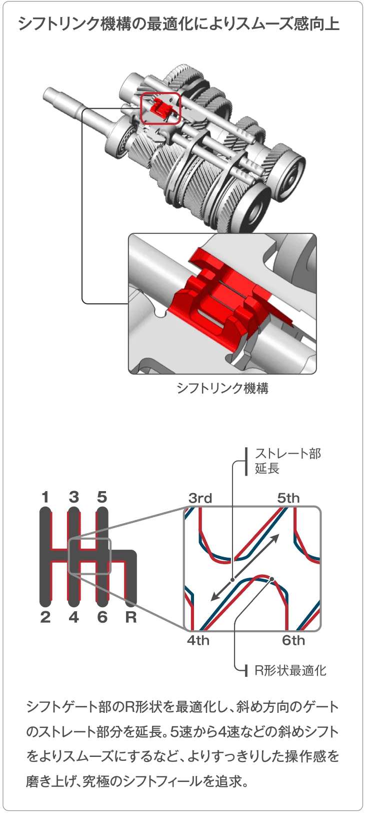

Fyi. There were improvements made in the shift gates for smoother shifting.

Yes - I experience the same bumpy feeling when the car is off. By changing the motion I can make it smooth. The problem when I drive, I cannot always craft perfect motion and hence I experience the bumps.
No grinding. If I push more to the left and down from 1-->2 I can feel the bumps all the time. If I more or less in the center, it's perfect and I do feel pleasant notch. It seems like this is how the gear was designed because the bumpy feeling doesn't come with grinding or crunchy feels.
Maybe something is too loose with cable (or else) and I have a higher probability shifting the gear near the edge causing the bumpy feeling.
