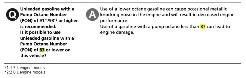

So the real question is will knock occur. Knock is when the fuel detonates prematurely while piston is still compressing and not at its lowest point. This is BAD for any engine. lower octane fuel combusts ALOT easier than higher octane fuel and a lot of variables come into play here.
SO, you COULD probably run 87 if you drive easy keep the RPM's down so the internal cylinders temps stay as low as possible and probably won't knock. if you use 87 and run in continuously to redline and have the higher temps for premature ignition you will definitely have knock and could cause damage..

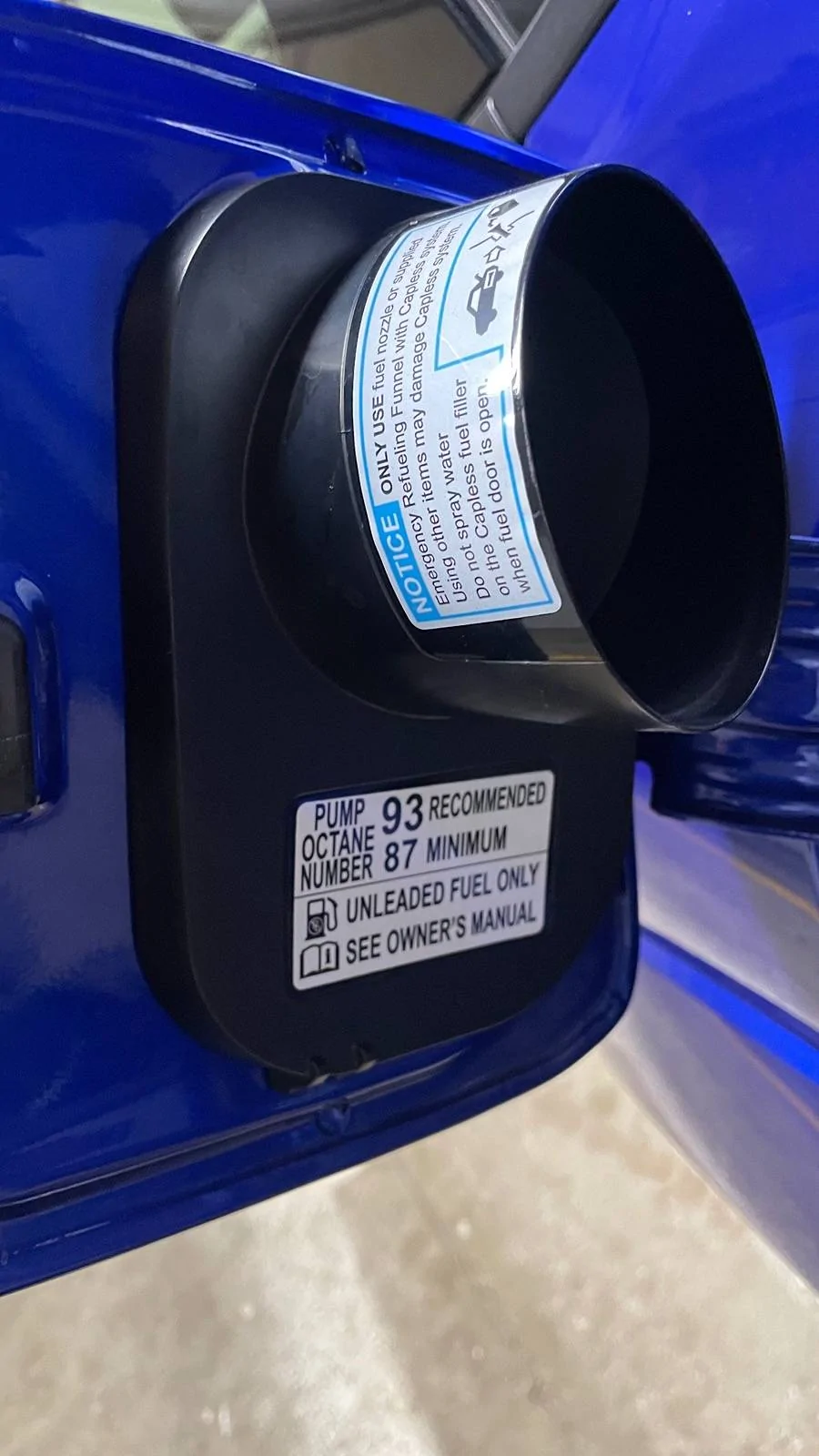

This question has been in my head for a while now. I’ve been putting 93 and the car and only 93, and it isn’t like it is hurting my wallet since it is still an efficient car (29mpg combined for my daily commute), though I would like to know if putting 87 in the car is possible. I’ve heard that ecu’s adapt to what octane is being used after watching a video on the new Elantra n, and it sparked my interest to know if my car did that. I learned that the type r does that so I assumed my type a does the same as they are the same car practically, but when I went to look to see if anyone had acted on my thoughts and put 87 in a type s, I found nothing except people talking about putting 87 in non type s cars. So, would I be safe putting 87 in my type s, and would I actually benefit in fuel economy by putting 87 in my car?
I only use 93, I think you get better mileage, performance and overall health of the motor buy going with the higher octane and can slow or even prevent the carbon build up that comes in time.
You can technically run a lower octane gas, but you then enter into the equation engine performance and potential issues including engine failure over time.
I wouldn't go any lower than 91 personally.
I bought this car for the Honda reliability and K series engine; I have every intention of preserving that engine as long as possible.
For me, the added cost of gas and oil is well worth it in the long run when you consider the cost of replacing or rebuilding this motor.
I like to use Amsoil full synthetic whenever possible in all my vehicles and I have had very good luck using it over the years, it is more expensive but gives me peace of mind.
To each his own, you certainly can run cheaper gas, do oil changes every 10k with Acura services and still enjoy your car, but to me, it is way too risky.
