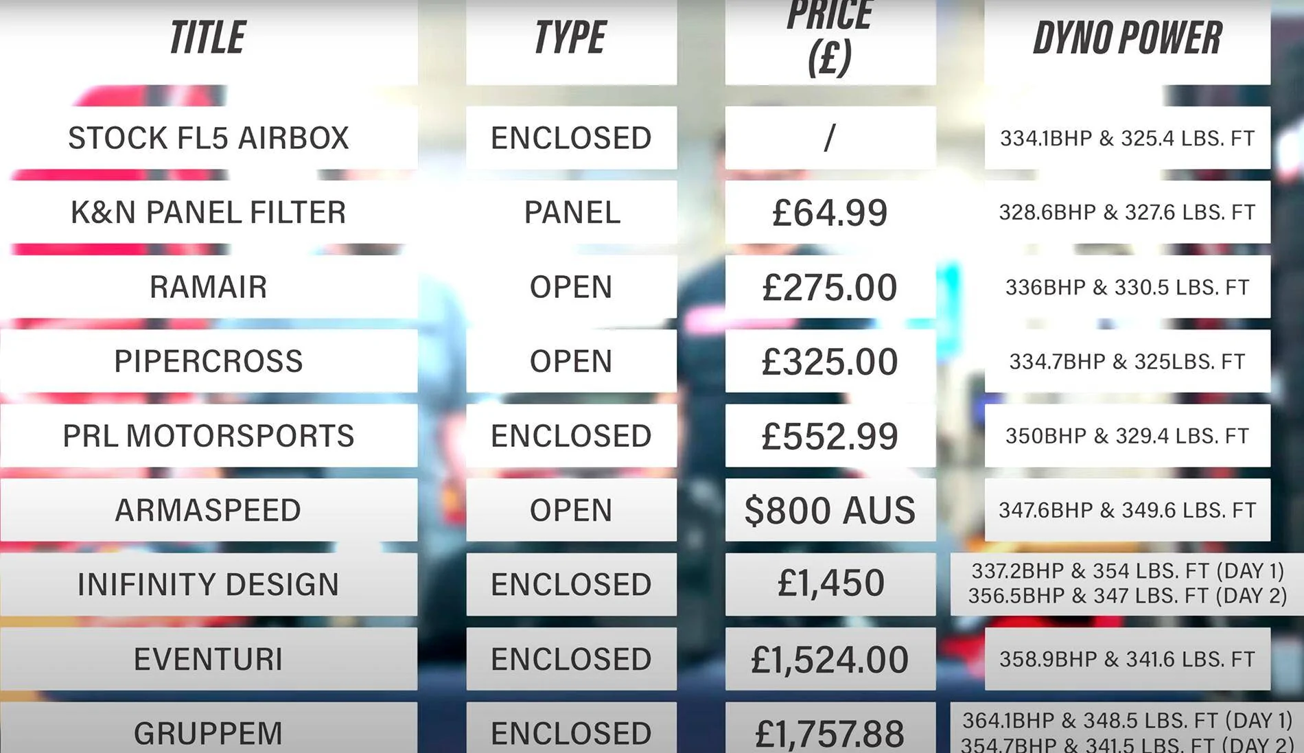

Are you hour-long YouTube video interested?
This link should take you directly to the point where they talked about the challenges with the first pre-production unit infinity design sent them, and the comparison with the other top performing intake in their test (GruppeM). It's not exact science, but the tests were done in the same general timeframe so it's as close as we're gonna get to empirical evidence. TL;DR, once a pre-production flaw was corrected with a second unit, the Infinity Design outperformed all other intake options across the entire rev range (GruppeM had higher peak numbers though).
And a screenshot table of their results (forgive the HDR washout, should still be legible):

All these intake numbers are also within a rough 5% of factory power range per their dyno. From what hondata reviewed, it looks like power is dramatically affected by temp on this platform (it's a turbo so that makes sense).
I'd be curious how comparable these numbers really are and if they drove the car for 200 miles between changes to ensure the ecu relearns the new air flow. The limiting factor for airflow is the turbine intake sizing, so as long as every pipe north of that is the same or larger, there's not a "flow" issue. Factory air box does accomplish that and it's capable of pushing more power, so how are all these intakes fooling the ecu into making power? Does that go away when the ecu relearn airflow?
In any case, it sounds good and that's worth the money imo! Considering the exhaust options are both cheap and expensive at the same time, more noise from something even cheaper is worth it.
I guess we could just follow the tcr car front as well... Just custom make a simple SS tube curved and matched to the factory turbine inlet and use a silicone pipe to get a filter somewhere in the bumper with fresh airflow. Nothing fancy, nothing expensive, and instead of getting heat soak by going over the turbo, you can go around. Might take a little plastic trimming, though.
https://hondata.com/technical-information-hondata-fl5-civic-type-r-basic-bolt-ons
