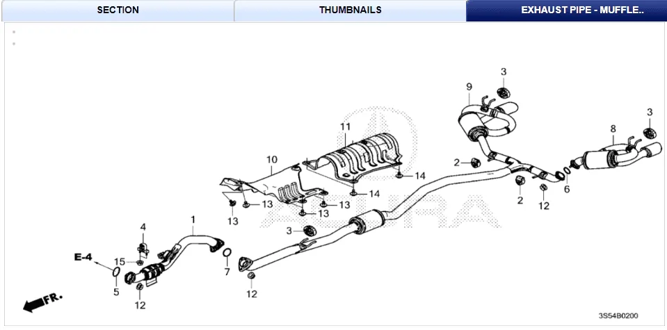

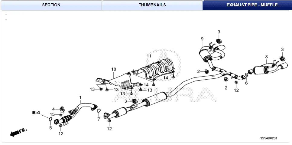

The B (mid) pipes are different between CVT and 6MT transmissions. Everything else is the same...
There are 2 resonators in the CVT model as opposed to one smaller one in the manual vehicles...
Check out the diagrams where you can see a noticeable difference in the mid pipe...
CVT

6MT
Acura Integra Inconsistent exhaust sound between base and a spec models? 1689704517914
So, the audible differences you're hearing are coming from those components being different, not the trim level of the vehicle but the transmission. You can see where Joe has a manual in the first video, a CVT in the second and another manual in the 3rd video. Hope this helps,
