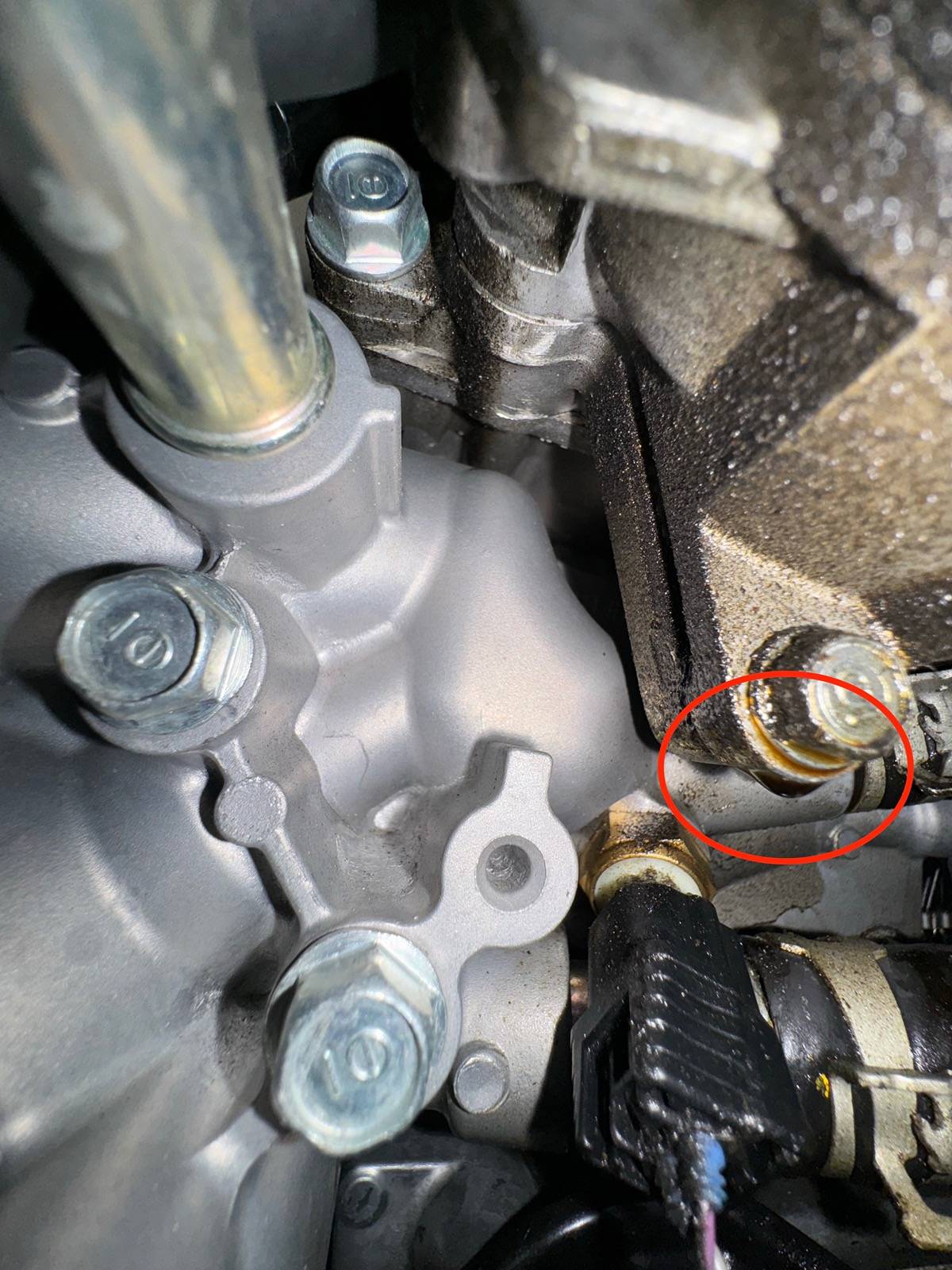

I'm with the camp that prefer to avoid going to the dealer for service but I was tired of my wife insisting that I take advantage of it. Unless it is for warranty work, it won't happen again, ever.
Last week, I decided to replace the oil with a premium one for my peace of mind. After removing the aluminum pan, I noticed the same signs that "Que the Chaotic" had seen on his car. I followed the trail, consulted a K20C engine diagram, and discovered that the leak seemed to be coming from the vacuum pump area.
I took the car back to the dealer on Saturday. They cleaned the area and added a dye to help identify the leak. They returned the car to me to drive for a week or so, and I will need to bring it back later for them to properly identify the source and order the correct parts. I'm okay with that approach.
One thing I will make sure to do next time is to record a video of the exterior of the car right before handing the keys to the service technician.
Check your engines as a couple of FL5 and DE5 models have been experiencing issues with valve cover/vacuum pump oil leaks.
Yeah. That's depressing, but thanks for the validation. It does appear to be an issue on these cars.
That's a bummer to see. I stuck my cell phone camera down in the same spot on mine and its all clean, no signs of oil there yet. ? Would you mind sharing your build date?
I noticed Que's car in the youtube video had an "in service" date of July 2023, so he was probably in the very earliest batch of cars. I picked my personal car up at the end of September 2023, a day after it was delivered at the dealer.
Maybe we can figure out if its just a narrow range of engines that were assembled with a bad part or bad gasket/o-ring?
Bought mine the first week of August so no doubt is July 23 too.
