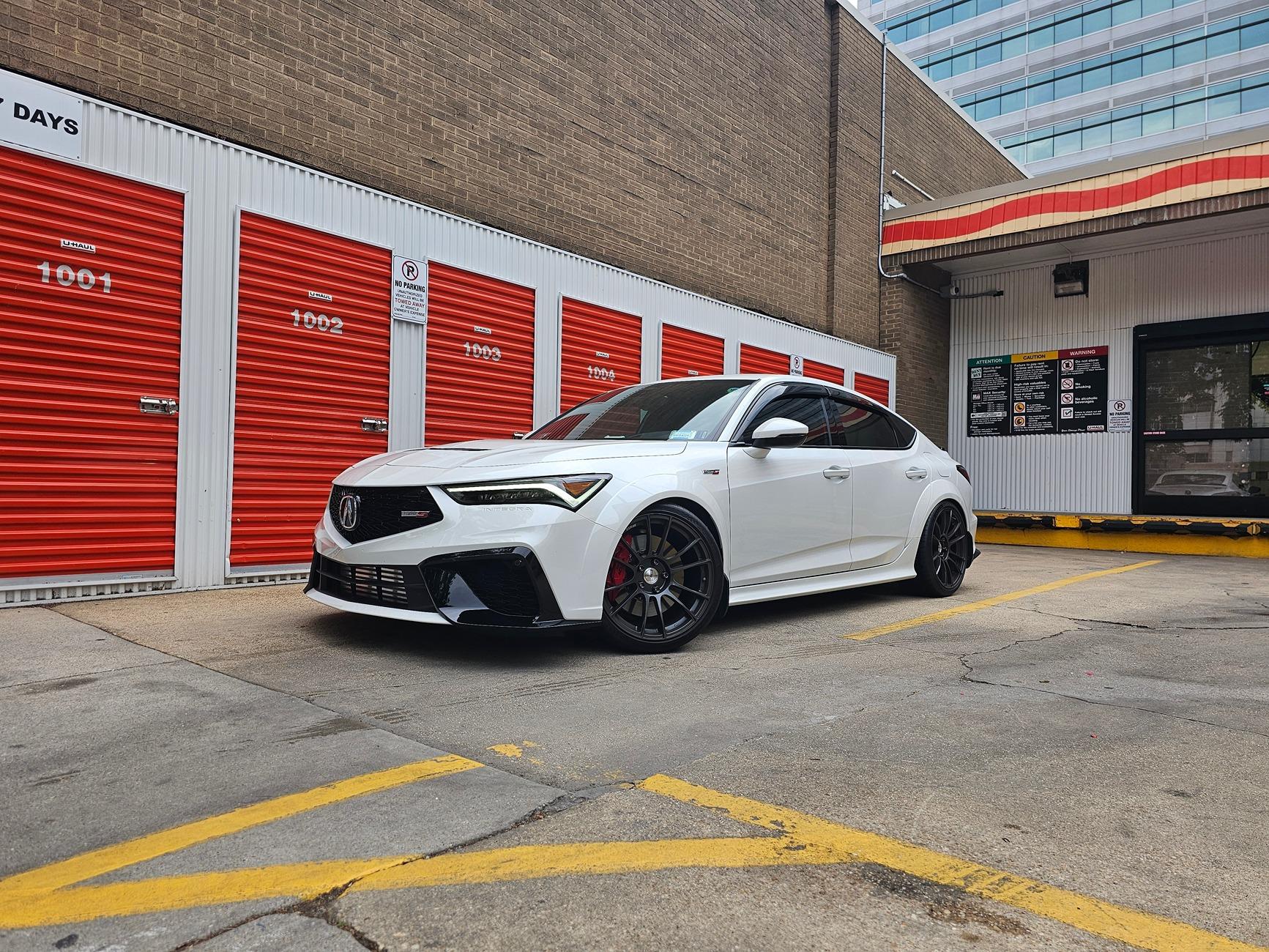

IMO as well as others, the closest you'll get to stock ride comfort but lower height will be these h&r springs ?
Acura Integra H&R lowering springs with Bonoss Spacers on Type S 20240704_163604
