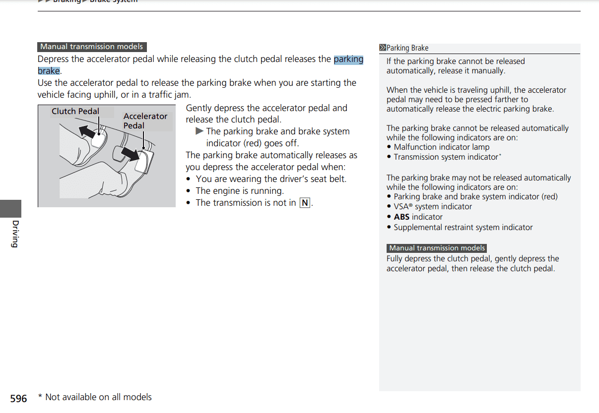

Not the parking break.
I have to disengage mine manually or it will not move.
This is straight from the owner's manual.
Reasons it wouldn't work (assuming everything else is working as it should):
- You're not buckled up
- You have VSA turned off
- You're not pushing the gas far enough when you're uphill

This morning with seat belt on, the engine running, and tried to start moving on first gear with a little of gas. Even tried it with a more aggressive start and the P Brake doesn't automatically release.
No warning lights, no VSA off, no ABS indicators, etc.
The only time I see the parking brake automatically doing something is when "brake hold" is on and I turn off the car.
Is it possible you're not pushing in the clutch all the way to the floor? For example I've heard things like Tuxmats can get in the way of it going all the way down. I tried this morning to start with the clutch pushed most of the way in (but not all the way) and the e-brake did not disengage.
That's the last thing I can think of that would cause yours to not disengage. If that's not it then it's probably an issue for the dealer to look at.
I have to give it more fuel than I usually do.
I will keep disengaging by hand in a flat surface. Uphill isn’t a problem.
