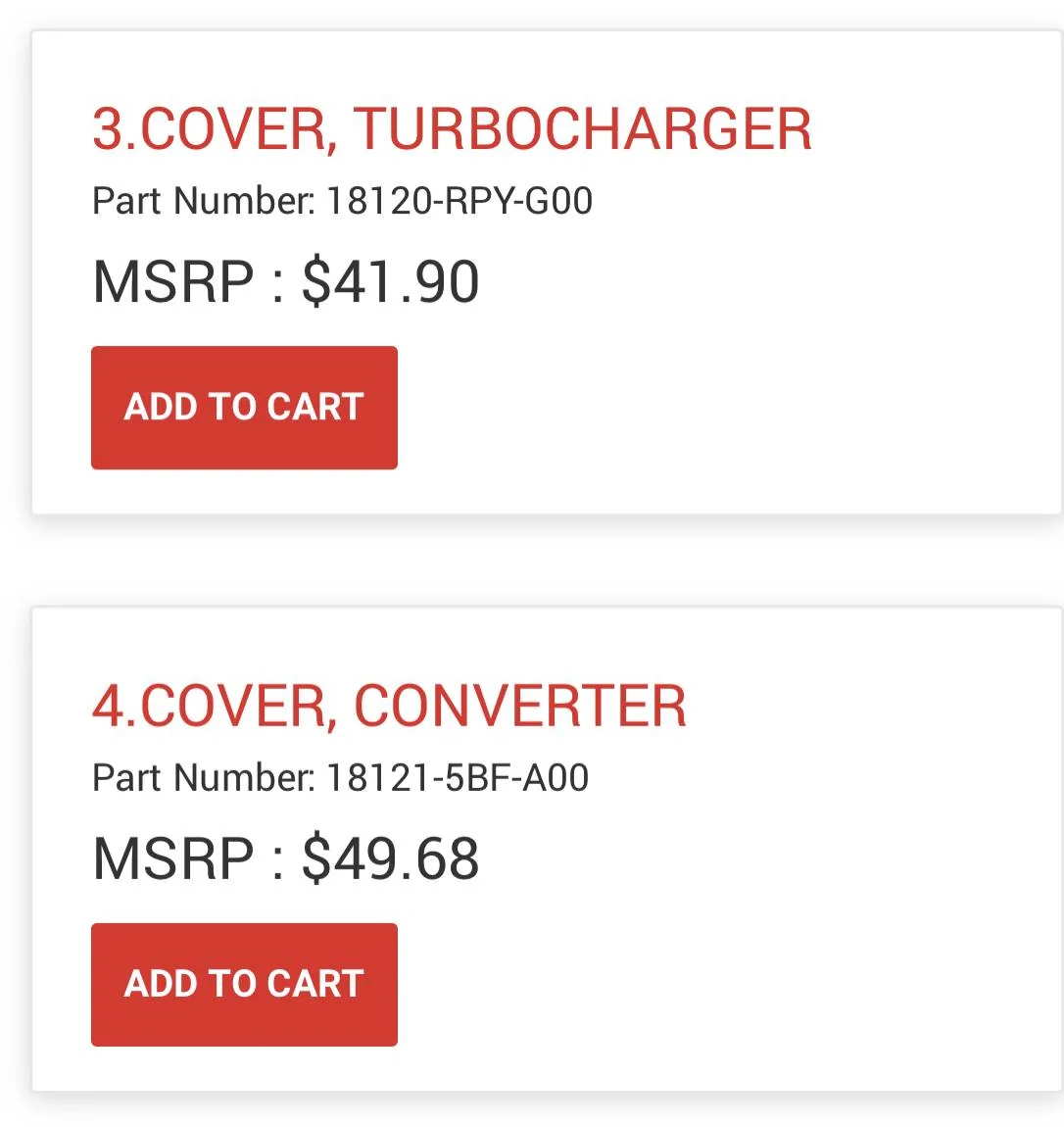

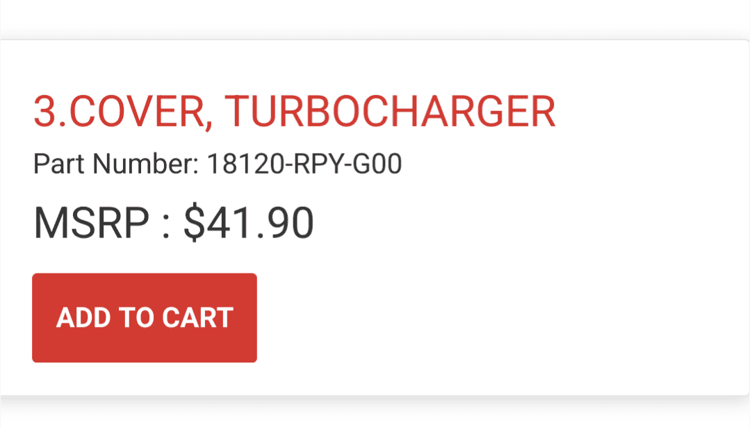

Has anyone been able to find the part #s for the turbo and downpipe heat shields?
I was trying to find these on Dreamshop, and maybe I'm just blind, but I can't find them :/
2,862
2,469
Here ya go. Dream shop has it listed under converter
Can't believe I missed that... sometimes their categorization leaves a lot to be desired, but I know I looked under "Engine" first. Thanks!

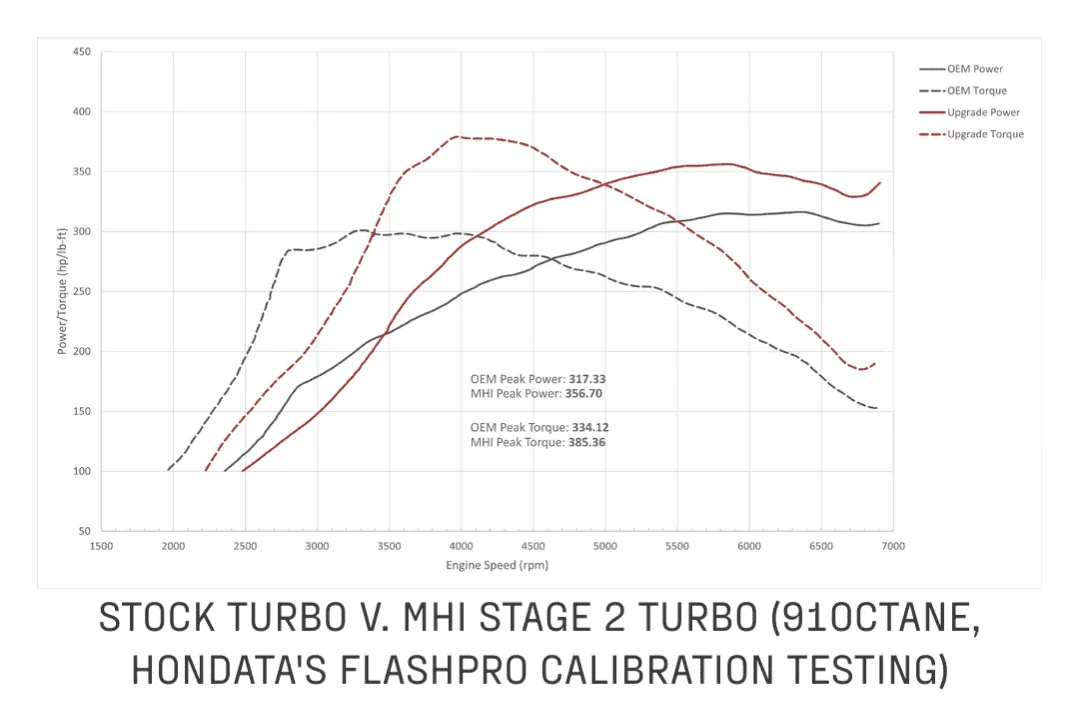

Yeah, to reduce heat radiation.
MHI does have a stage 2 turbo for this platform. My understanding is that it has a good reputation. Last time I checked, the price was similar to the RV6 660, which has a higher performance ceiling, though.

Not sure I like the graph on the MHI Sstage 2. This of course compares it to the FK8. I don't think our stock turbo drops this hard on the upper rpm like the fk8 does
This is a good example. Maybe ITS doesnā€™t drop off quite as hard but we do have a drop off. Acura has done a nice job tuning for smooth power delivery after 4krpm. We see it evidenced in how well ITS pulls hard in a straight line vs CTR.

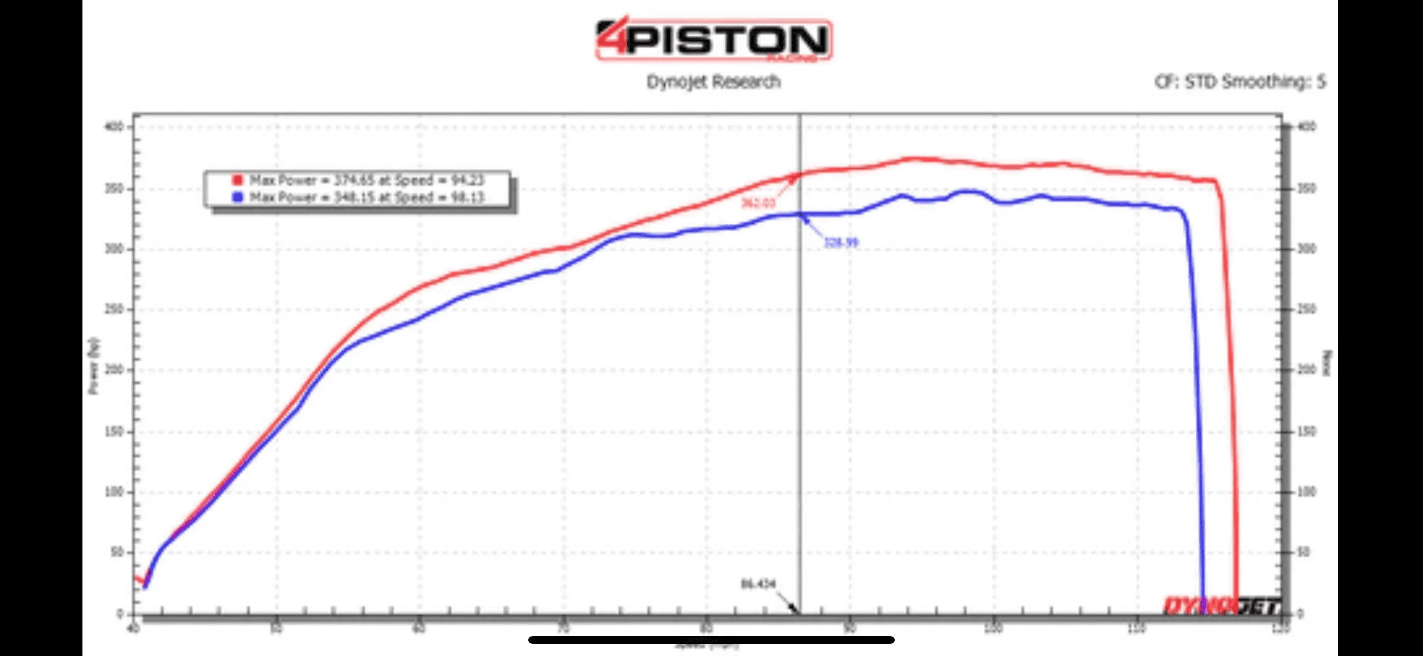

Yep. All these OTS tunes spike that low-end torque. I know they are working around factory turbo and fuel pump limitations, but I'd prefer to invest in some 4P cams and a HPFP and target the high end over putting such a high load on the rods below 3k.
2,862
2,469

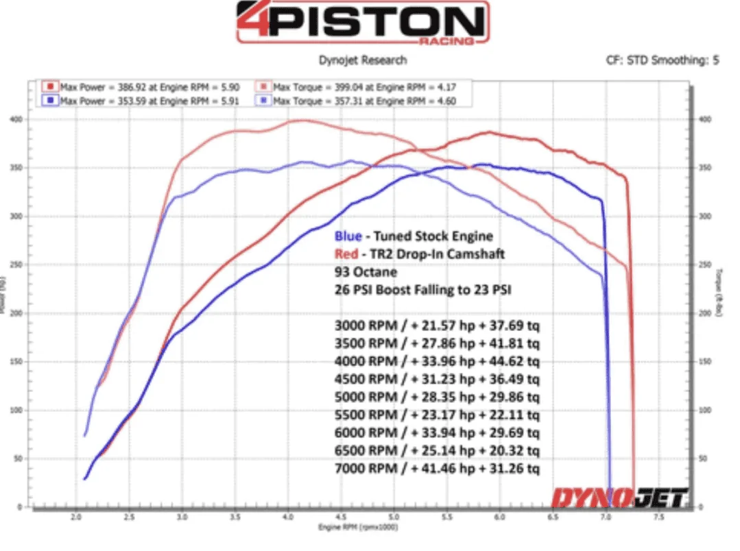

FL5 with TR2 Cams
Cams alone get you beyond what the MHI gets ya. It would be interesting to see both

FL5 with TR2 Cams

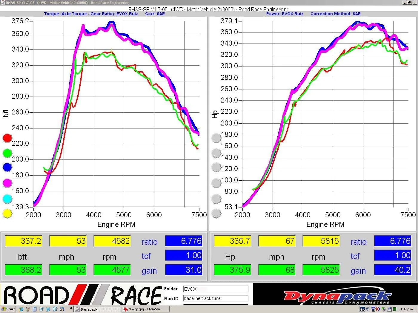

This is their best dyno showing smooth gains across the powerband.
two other examples Iā€™ve seen and on stock FK8 with just a camshaft upgrade:
These give an idea of what a fully tuned camshaft upgrade can do on the stock turbos. Not a lot of change in the top end, however, the mid range is a whole different beast.
goes without saying, we will not get high peaking numbers without turbo upgrades. At the same time, we will get much more and more frequently used mid-range power. Which is why ITS is so fun in the first place. This is more important without sacrificing any torque and low down power.
One thing to note as case study, the FL5 turbo is smaller than the FK8. Smaller compressor and runs out of breathe early. Yet, both the CTR-FL5 and ITS is more responsive on the low end. Maybe that has to do with how MHI turbo is designed with better turbine exit to reduce back pressure. That is something we have to investigate and consider between RV660-P700-MHI stage 2. Having a well built bottom end approach first seems to be ideal rather than high end and working our way down.
