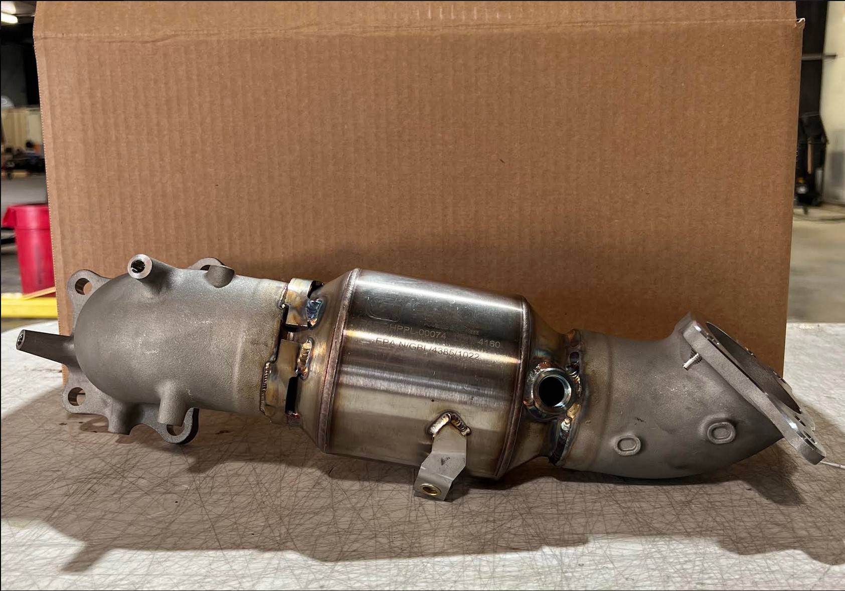

I have been incredibly excited for this product to release. This is the TSP Gesi Catted Downpipe for the 23+ Acura Integra. It started with a simple email and slight nudging to be one of the first to be able to purchase the downpipe directly from TSP. Corey over at TSP reached out and let me know they had inventory trickeling in and ofcourse I had to jump on the opportunity to get one purchased and installed.
Why this downpipe is important?:
1.) Guaranteed No CEL ( 5" GESI EPA certified catalytic converter).
2.) I wanted a freer flowing exhaust.
3.) I wanted the sound that this should produce to emanate from the economy L15.
4.) This design is similar in characteristics to the PRL that has been discontinued.
6.) Solid platform for any additional modification that are made to the vehicle.
7.) Replaces the gaping hole of PRL pulling out of the market.

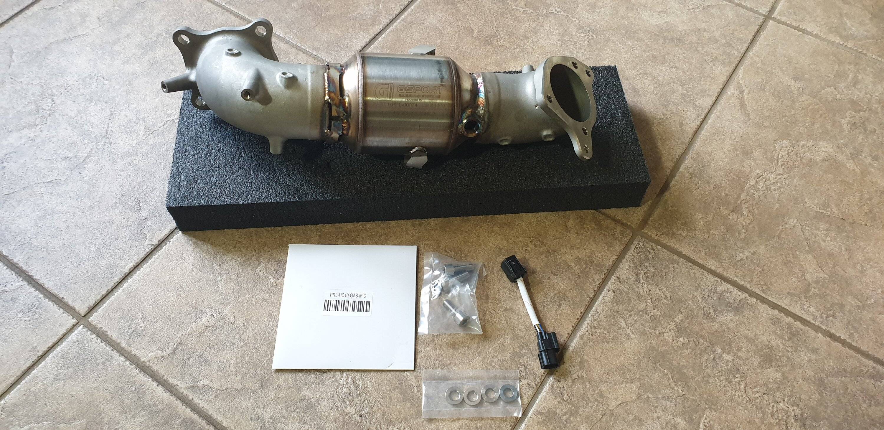

Pt.1 - Unboxing:

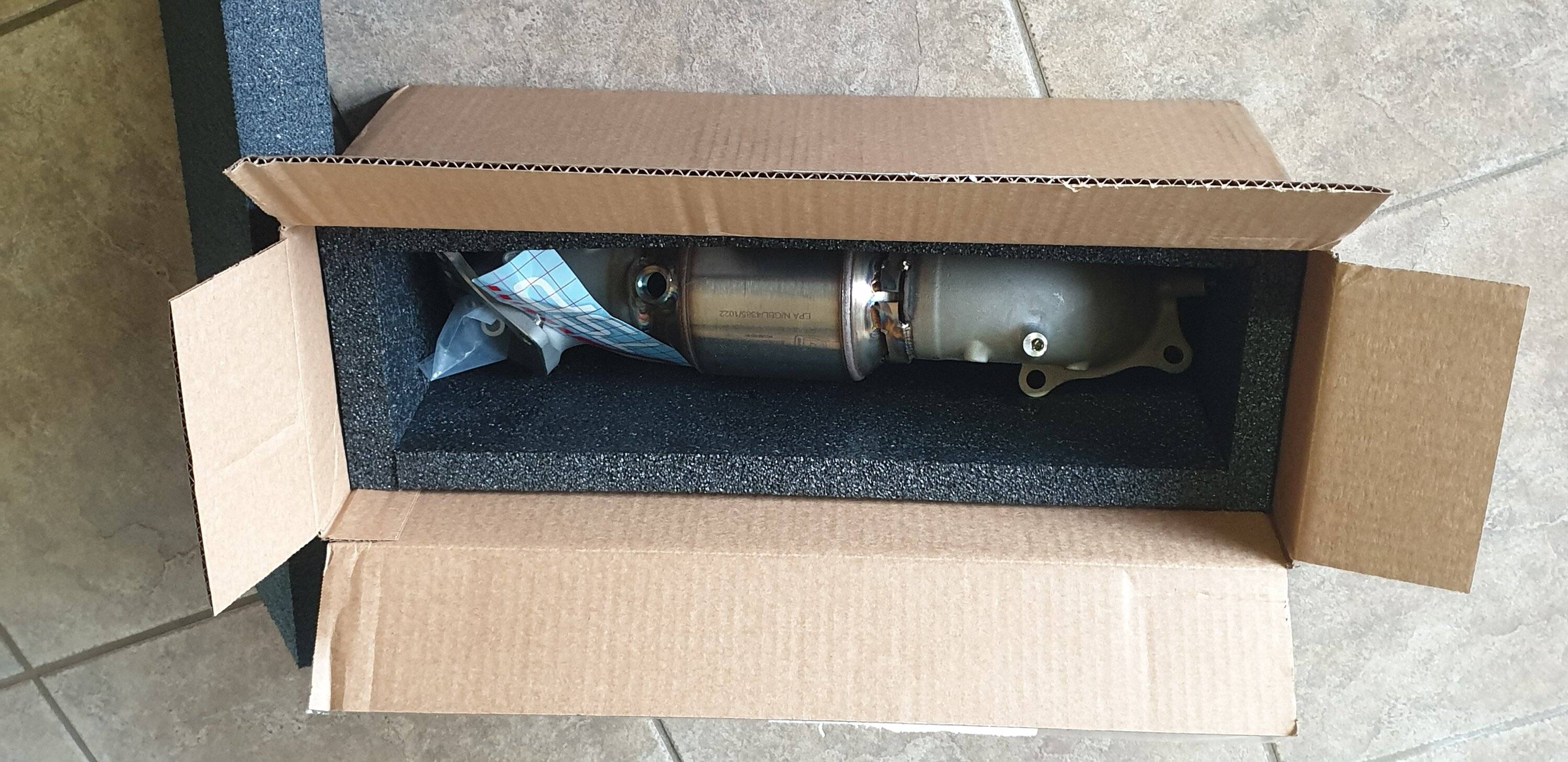

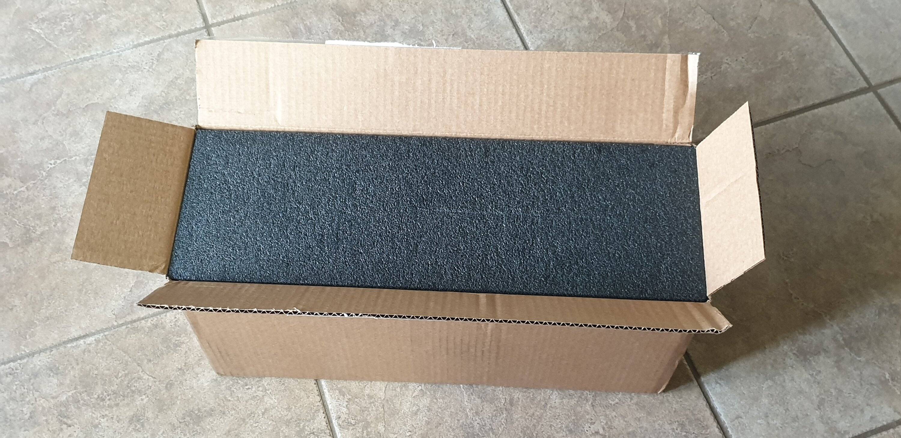

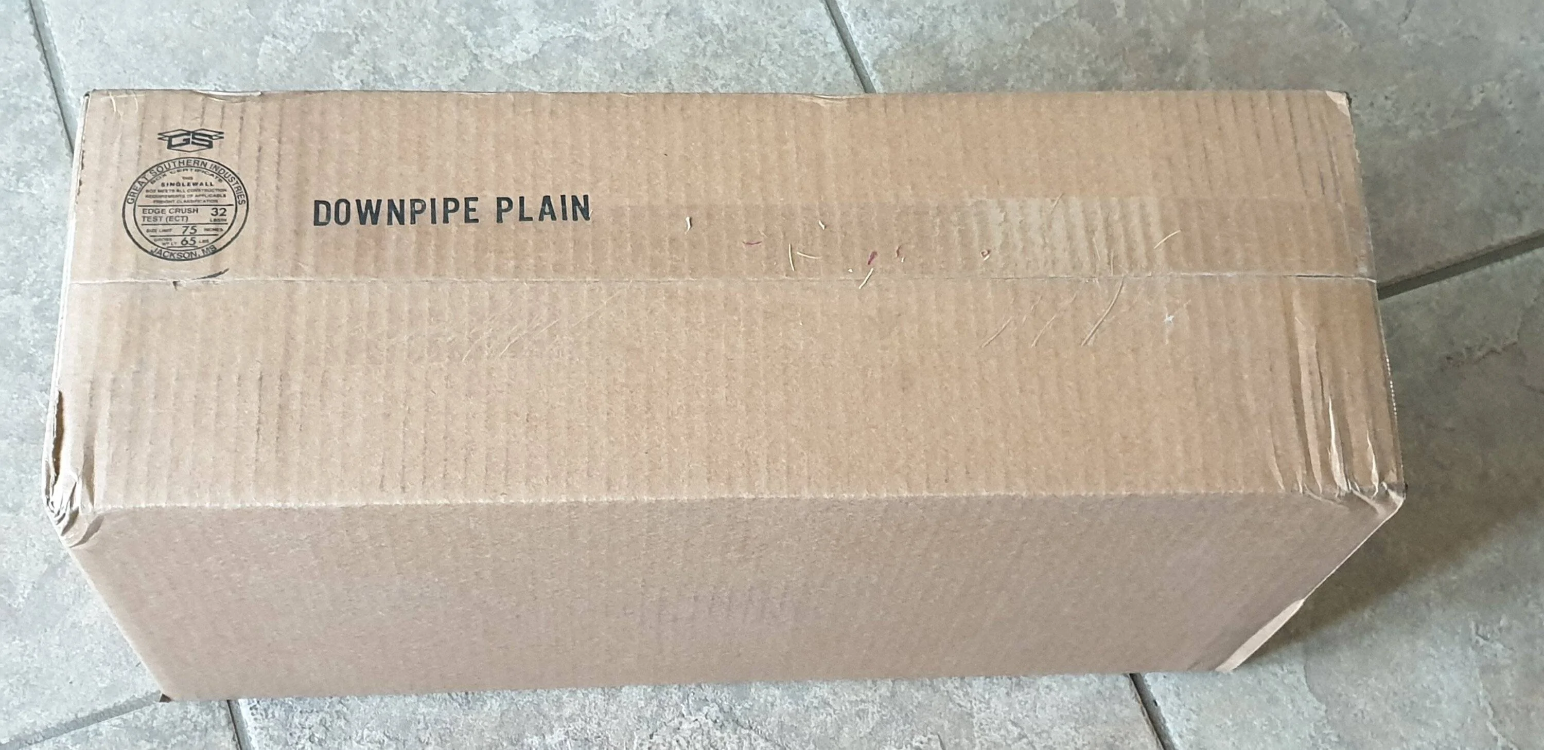

Downpipe was well protected and shipping took two (2) days to get to my location. Nothing appears to be damaged and came delivered via FedEx. The package contains the downpipe, bolts, nuts, gaskets, wiring extension and TSP sticker/decal (At least 5+ HP).

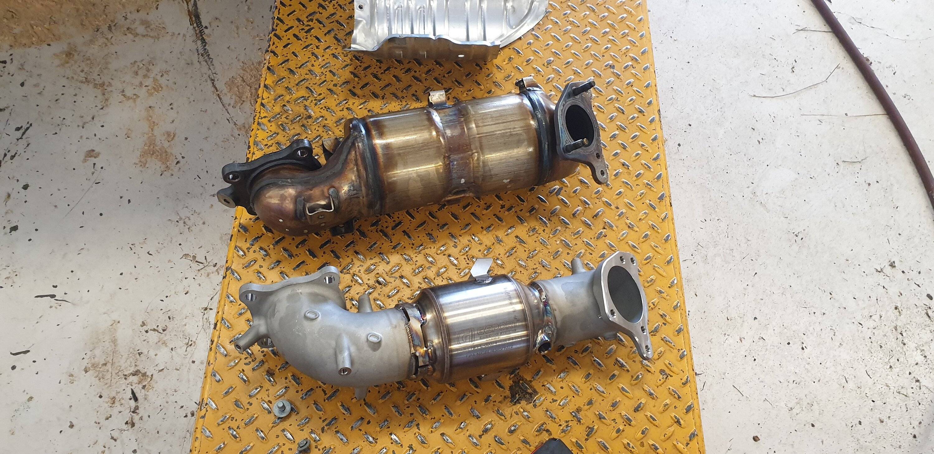

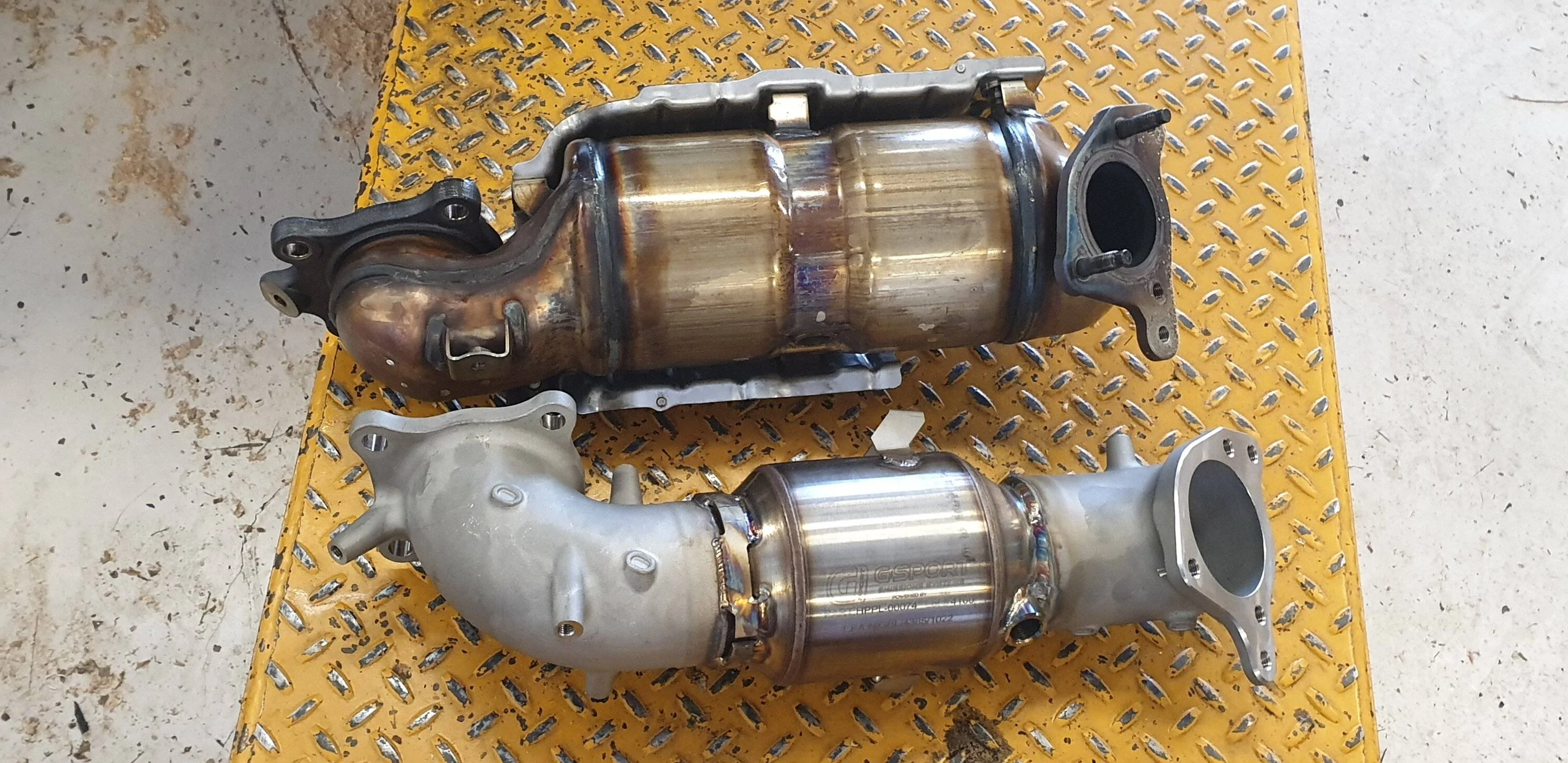

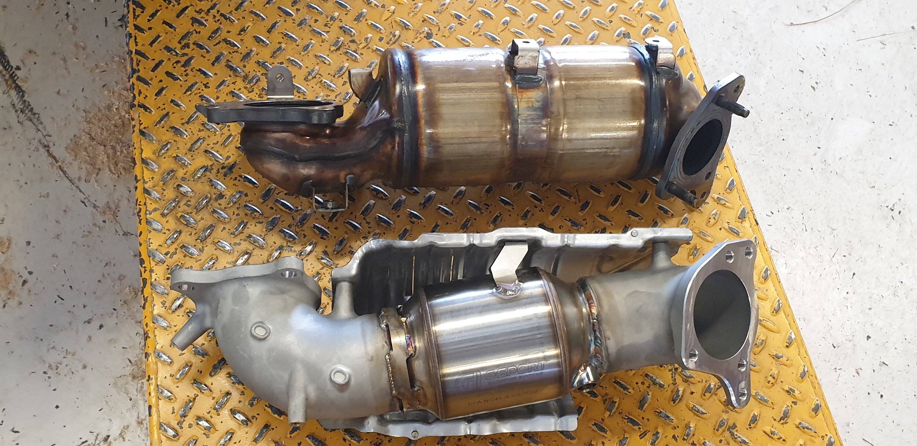

Admittedly, I do not have as many pictures as I would of liked of the install. I remembered to get a couple, but it was of the downpipe comparisons once the oe was off of the vehicle. I went to a local rent a lift location and was able to get the project started. While the installation itself was rather easy I did run into several challenges which required one of the techs to help me troubleshoot the issue. The process ended up taking me two (2) hours. I wasn't expecting it to take as long as it did, if im being honest. The short five mile trip from my work location to the shop required the car needing to be cooled down for at least 30 minutes. I initially wasn't planning on re-using the heat shields but after realizing how effective they are, I would have been a complete idiot to not reuse them.

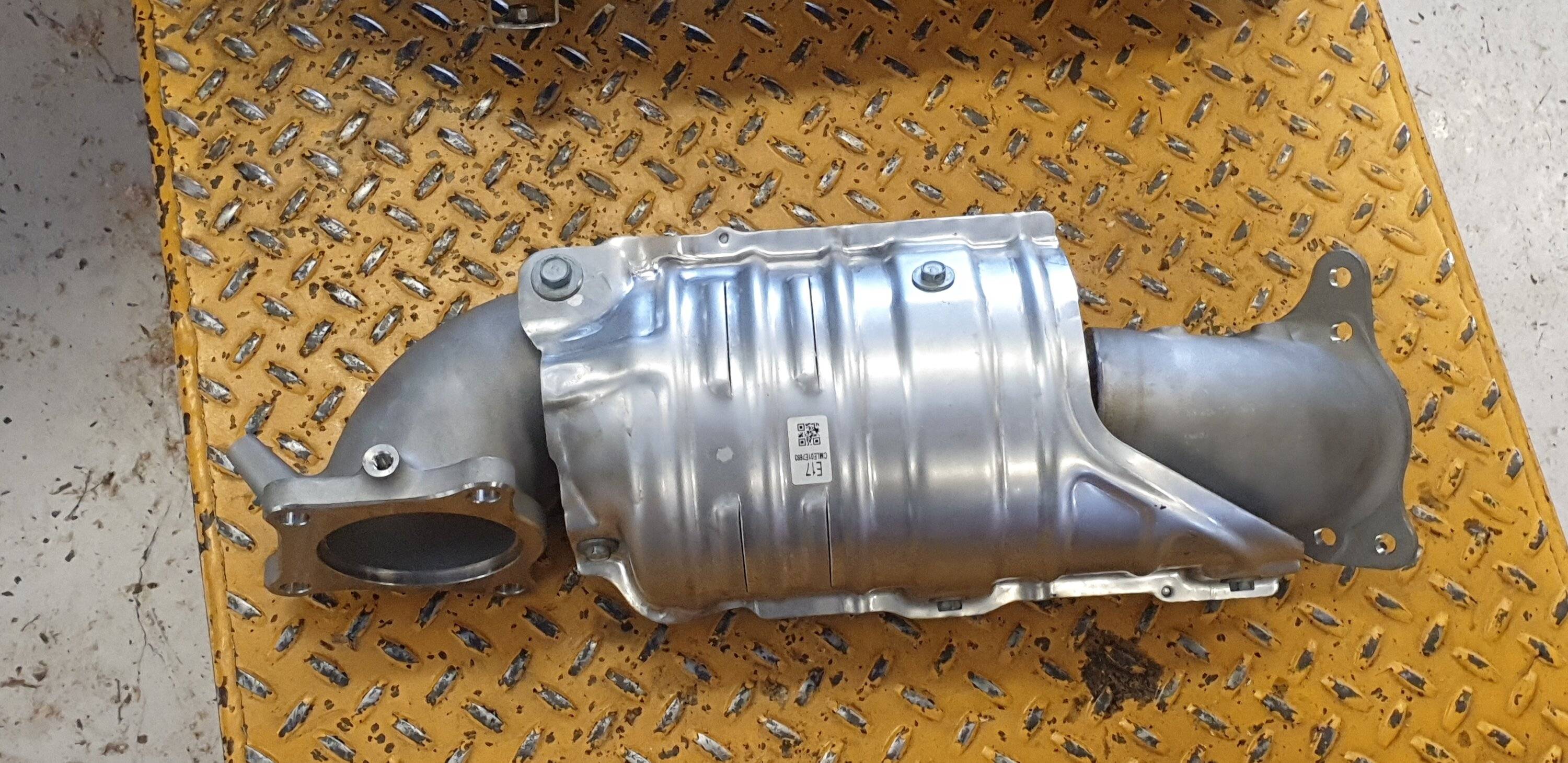

  14. With the oe downpipe removed, go ahead and swap over the heatshield. Oddly enough, there are 4x 10mm bolts and 1x 12mm bolt that secures the heatshield.​
