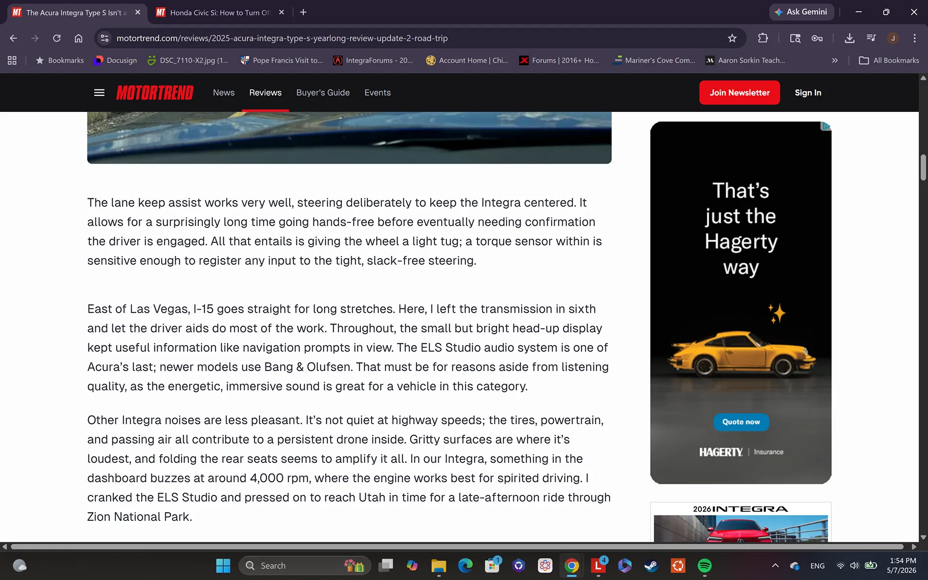

I was reading Motor Trend's 10/23/25 review of the 2025 Acura Integra Type S as a road trip car and in the review it mentions a dashboard buzz when the engine hits 4,000 RPM. I've had the same issue in my 2026 ITS. Given the MT article this is clearly a known issue. Has anyone found what causes the buzzing and how to stop it or mitigate it other than turning the music up?

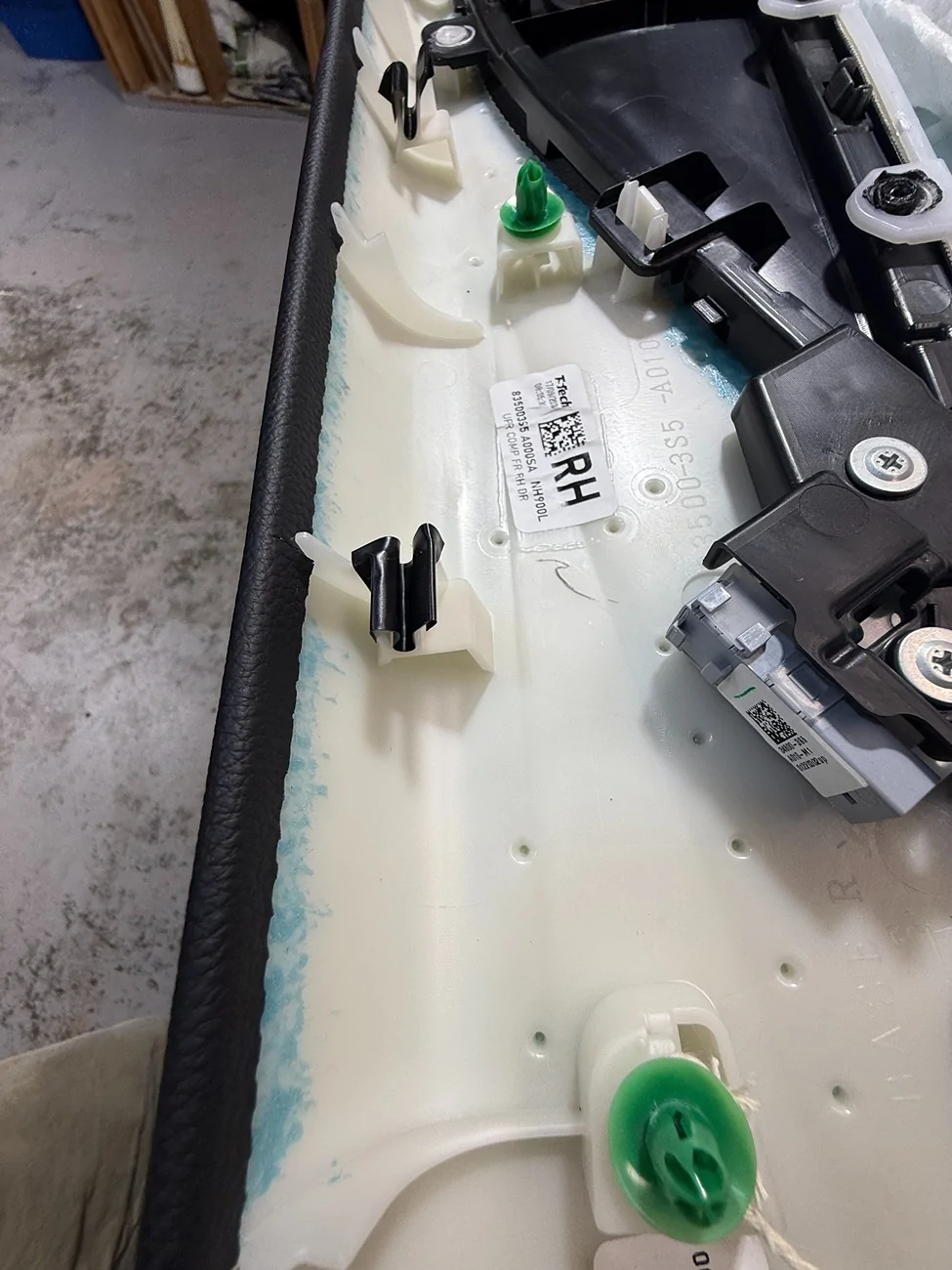

I had a buzzing noise coming from the front passenger door. I noticed it between 3,000 and 4,000 RPM with no music playing. If I pressed on either side of the interior door handle, the noise would stop. I removed the door panel and tightened any screws I found on the door and the inner cover. I have not heard the noise since, although it has not been very long since I did the work.

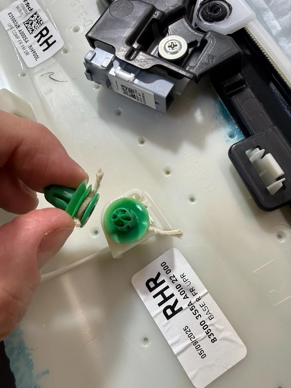

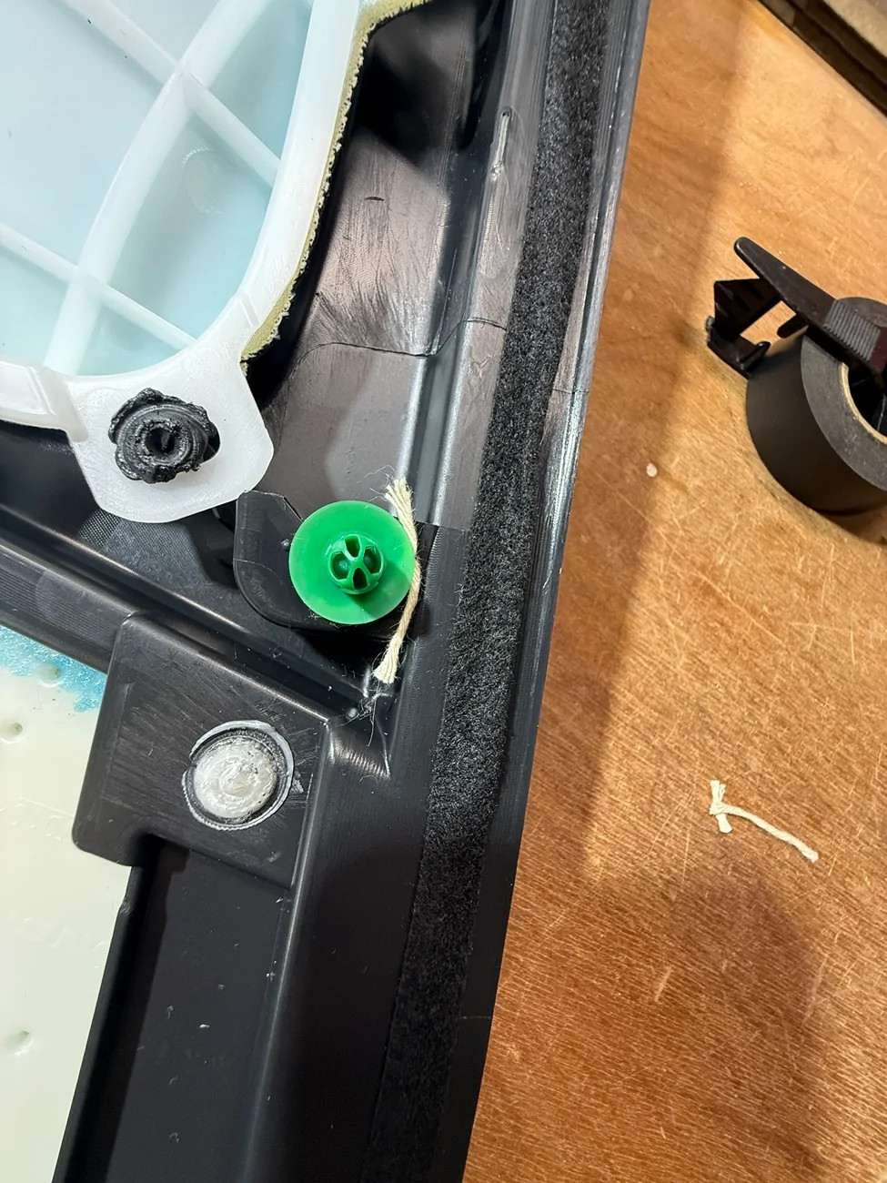

The buzzing noise came back, so this is my second attempt at fixing it. I also occasionally hear the same noise coming from the driver's side door.
This time, I wrapped each positioning peg with a loosely wound string, making two revolutions around the peg. After reinstalling the peg, I wrapped the string one additional revolution between the peg and the trim piece to help hold it more securely.
I also added a strip of electrical tape to the tabs that attach to the trim piece below the window after the interior door panel is removed. My hope is that the extra padding will eliminate any movement between the parts and stop the buzzing noise.
Are you using new green pieces each time?

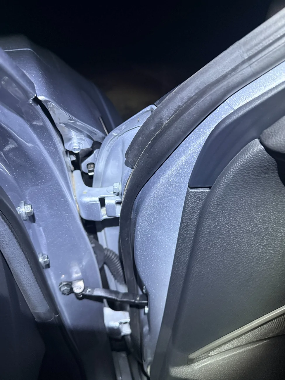

Ah ha, I know where the buzzing is coming from. On the top part of the door panel near the jam, that part will likely lift up. It shouldn’t. It’s because a plastic piece broke (it’s white in color) u can only access it from the outside and not from behind the panel. I actually got around to supergluing it today and there’s no longer noise. I suspect it broke when I was popping off the door panel to do other installs.

No, the current green pegs are working great.
I've found whenever I take the panels off the green clips lose some tension. I've had a number where the green becomes discolored around the base where it snaps in.
With any noise chasing I treat them as disposable since they're super cheap and have a tendency to break or weaken anyway.

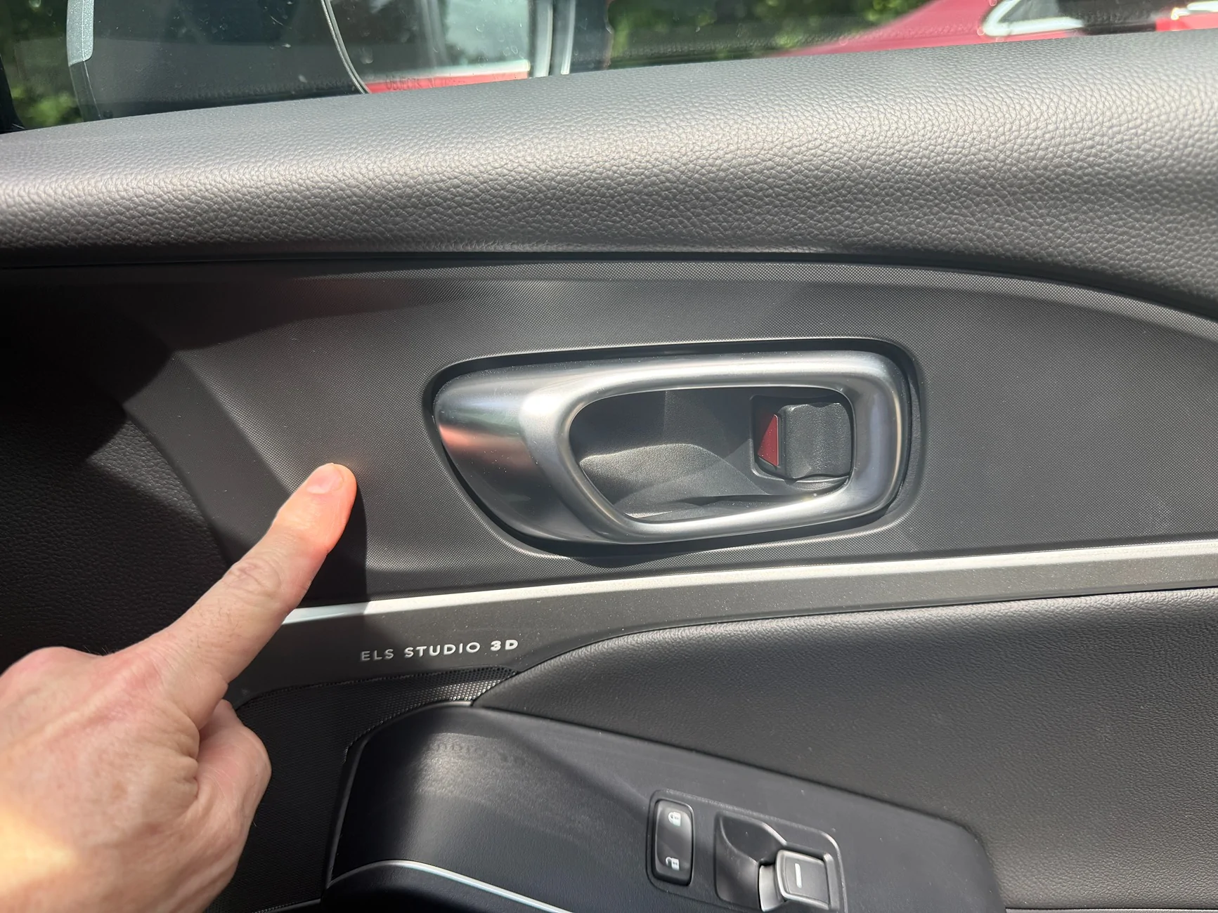

I'm not sure what white piece you are talking about. Is it in this image?

sorry, my explanation sucked. Here’s a pic
Are you talking about a white piece in this area? When you say " access it from the outside and not from behind the panel. ", do you mean it is behind the panel, but not attached to the panel? Is it attached to the door on the inside behind the panel?
