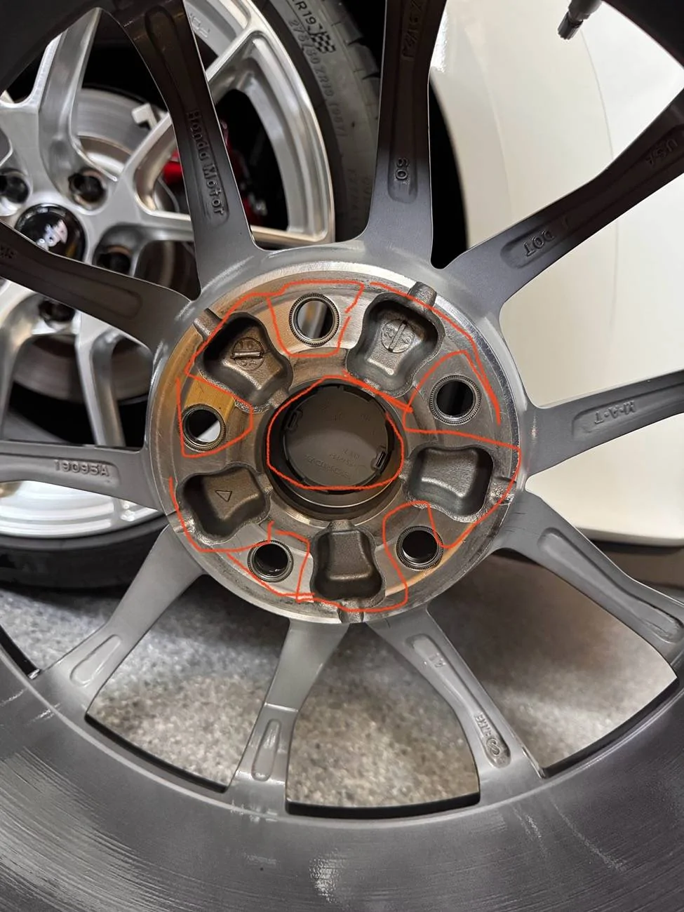

I put and even cost of anti seize on this part of the apex wheels (the mating surface). Picture is back of the oe wheel
This is what I did, and I also cleaned up the crud around the axle ring, sorry not sure what it’s called ?. Been a week and no noise.

Just wanted to bump this and see if the noise has come back for anyone? I thought you all were crazy but decided to apply some anti seize upfront just to see. And damn if it didn't get rid of the noise.... Granted I also did a thorough clean out and rotated tires.

Still no noise… all good. I cleaned everything, there was some junk around the center hub area, not sure what it’s called but the center ring that’s on the axle, which I put the anti size around that And a thin coating on the whole apex wheel hub contact area and inside the connecting area. Been a month now and still good.

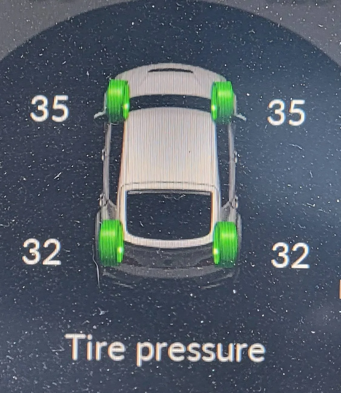

Mine had 1 not seal on initial mounting, remounting fixed it. All 4 hold air for months no problem. But after an AutoX my front tires end up lower psi than rear, so worried they are breaking seal under heavy loading. (Cold before 35/32 after 30/32).
For tomorrow I have one OG Apex and one New Apex rim in front, will see if the new (new logo and knurling) holds air better.

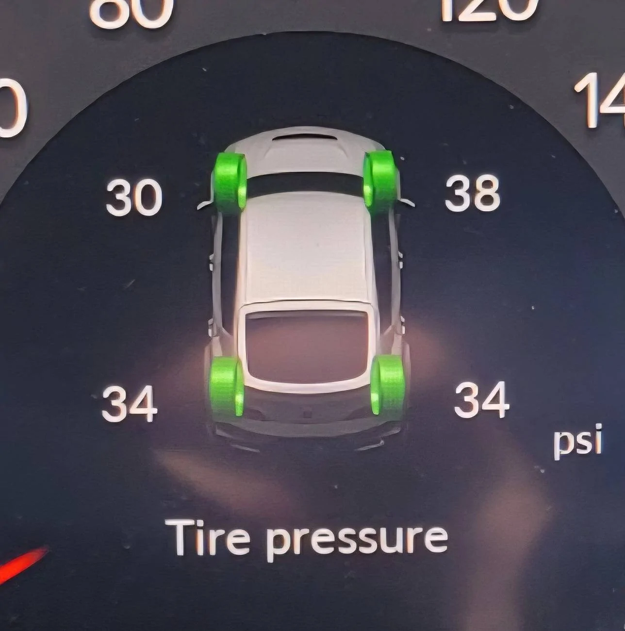

So good news first, still no clicking after a heavy/fast AutoX session. Bad news is as assumed, the OG Apex are losing air under heavy load. All OG except RF = newer knurling.
How it started:
Acura Integra Clicking noise from left front ONLY when turning right... 20250622_112049
How its going:
Acura Integra Clicking noise from left front ONLY when turning right... 20250622_133711
1,818
1,280
