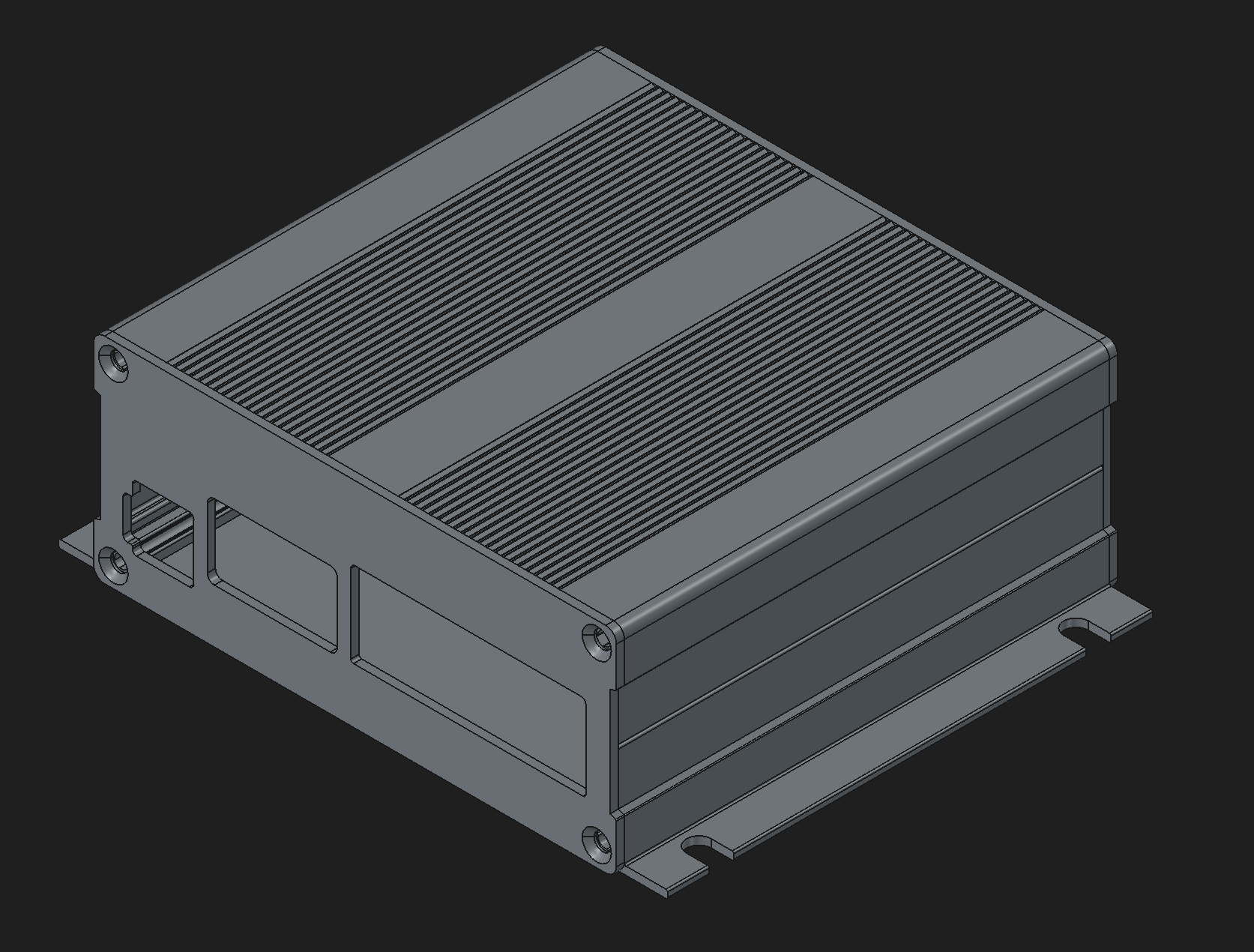

I figured out a way to make a T harness despite the funky factory connector availability. It will be a bit different from the typical T harness as it will be an enclosure that you plug into. It will be a tiny footprint, about 3" square with a height of about 1.75". It should be very easy to bundle in the kickpanel next to the factory amplifier, and then you'll run the provided long harness back to your DSP. It will carry the input and return wires for all the main speakers so all you need to do is correctly wire up your AMP using the provided color-coded wiring diagram. This harness will also carry the car's remote turn on lead, so you'll have everything you need to drop in your DSP/amp other than power and ground of course.

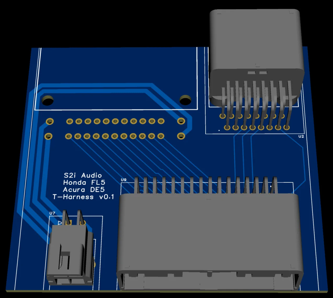

This weekend I designed the prototype T-harness cable and passthrough device and sent the specs to the manufacturer for quoting.

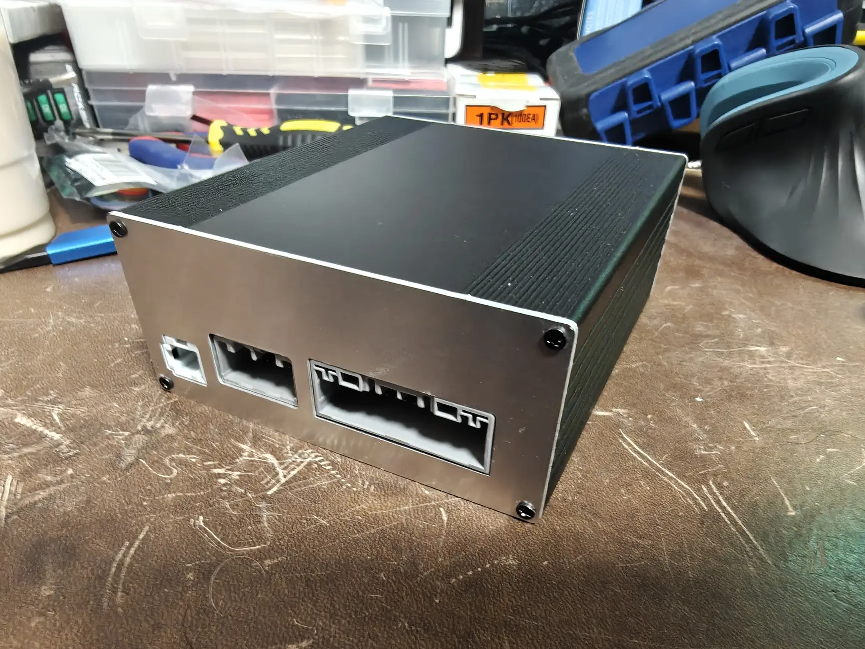

First prototype ready for testing in my car!
This is already defunct design but functionally fine for testing. The final product has been shrunk down to about 1/2 this size and will look much more like an off the shelf consumer product.
Still looking for testers!

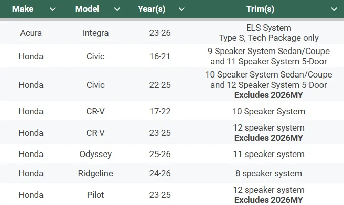

Update for everyone as I near having the first run of production models ready.
I reviewed the wiring diagrams for all Honda and Acura models with 2021 model years and up. I now know which models, years and trims can use the "PURE" digital source integrator device.
These models are compatible with the PURE:
Acura Integra BUILT: Digital Factory Infotainment Integration for ELS Studio 1777946899295-vs
I will be creating pinout diagrams for all these models and providing them with the units, so the installation process will be as easy as possible. Furthermore, I'm going to be designing DSP compatibility harnesses that you would buy separately as a bundle with the PURE according to which brand of compatible DSP you have.

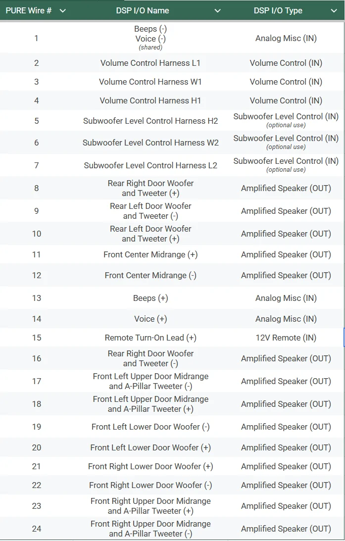

Hey folks! I've been quietly working on getting ready for production and I'm only a few weeks out from going live! There have been a ton of enhancements made to the device as a result of the intensive testing I've been doing, both on the hardware and software side of things.
I intend to provide a detailed update on these enhancements, the delivery timeline, and more soon. For today, I would like some feedback as I start writing the user and installer documentation that will be provided with each unit.
The first thing I'm working on is a wire number table for the single DSP harness that comes with the unit. This harness is what allows the car and DSP to integrate input and output signals to/from the DSP. Each wire will have a wire number label on it, just like this picture:
Acura Integra BUILT: Digital Factory Infotainment Integration for ELS Studio 1779508318436-hn
I'd really like your feedback on the level of clarity of this table - is it intuitive? Would something else work better? Note that this is not the extent of the user manual - it's just one of the pieces that will be part of the larger document. But I'd love to get early feedback as I start working on this. Thank you all!
Acura Integra BUILT: Digital Factory Infotainment Integration for ELS Studio Screenshot 2026-05-22 234100
