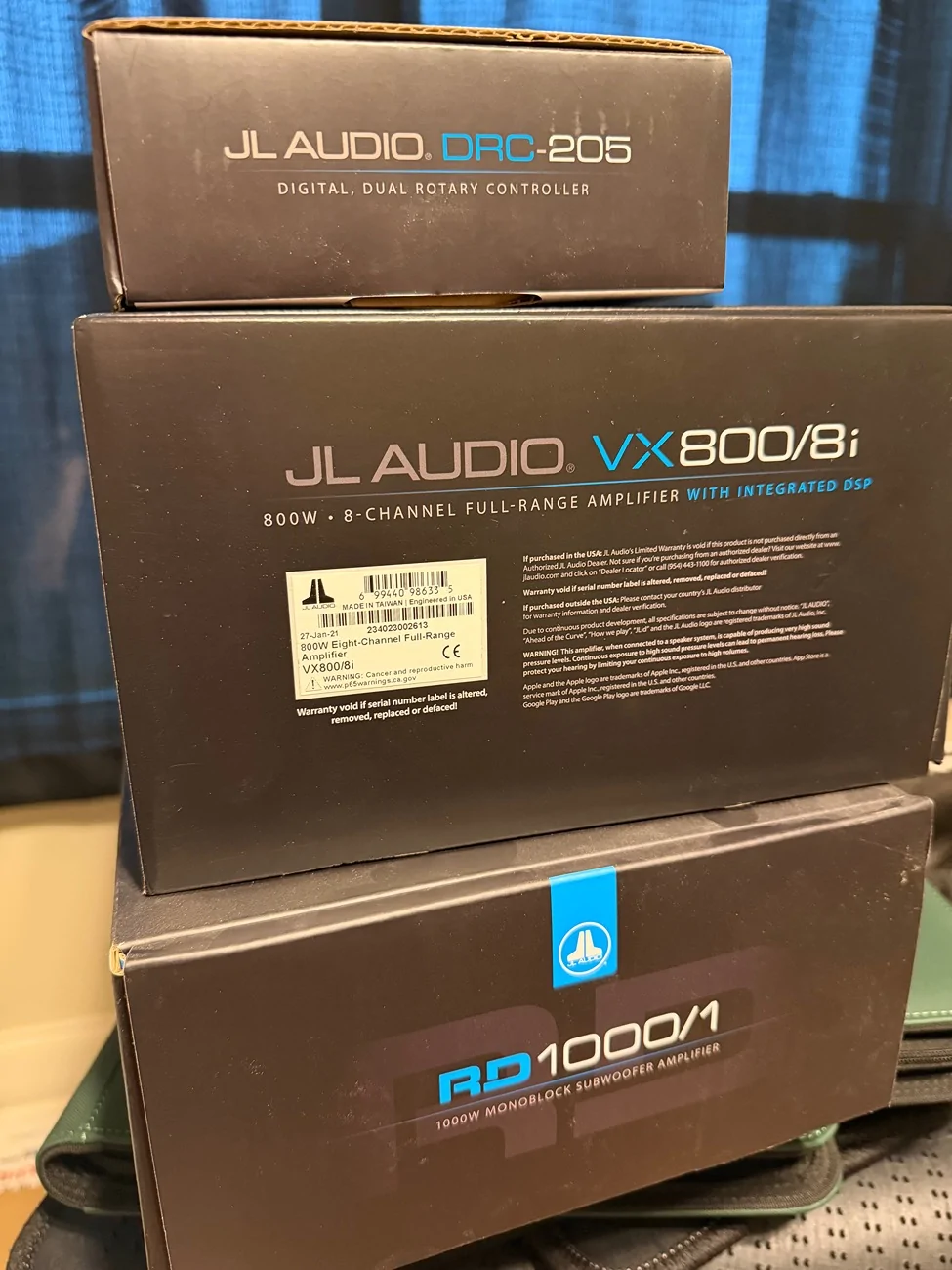

Ok initial research is, as usual with DSP manufacturers, a bit conflicting.
JL calls their compatible remote controller (the DRC-205) a "digital" remote controller which in theory wouldn't work with my device but I think JL might be using some liberties with the naming conventions.
If I had an amp to test I could definitively figure it out. Even better if I had an amp and a DRC-205.

like these? lol, I’ll send a message and we can work something out. I used the knob more for cycling tunes but it can control both “volume” and fade. The volume acted more of a remote gain, if that’s the correct term. I used it to turn the bass down when I wanted mainly.

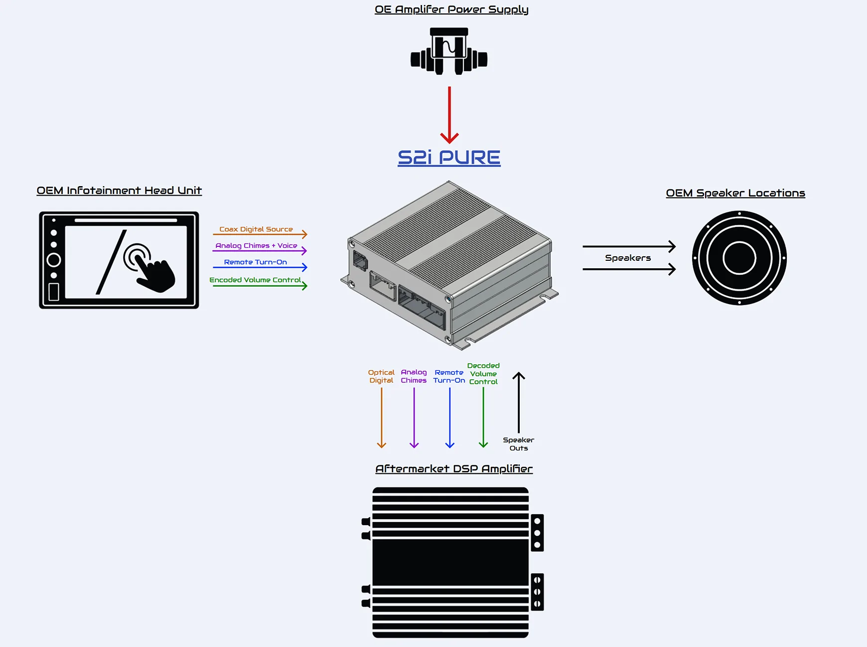

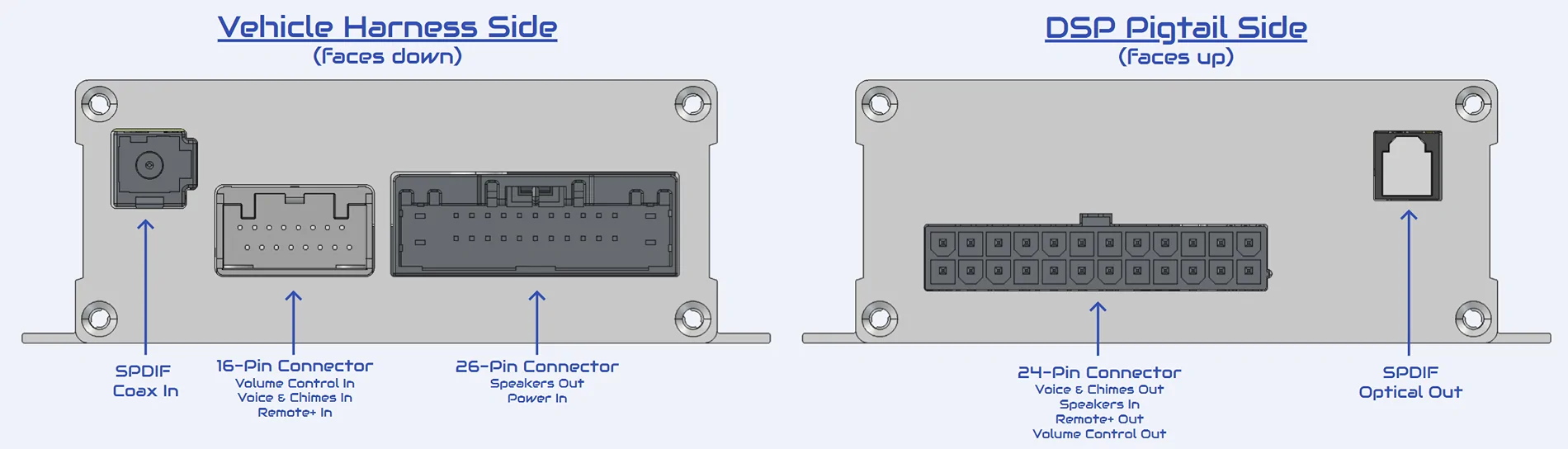

Continuing to build out the website (which is now live, by the way) and one of the areas I am going to be creating a lot of content for is "education" in the form of images, diagrams, FAQs, user manuals, etc.
Here's a taste. Would appreciate feedback of any kind!

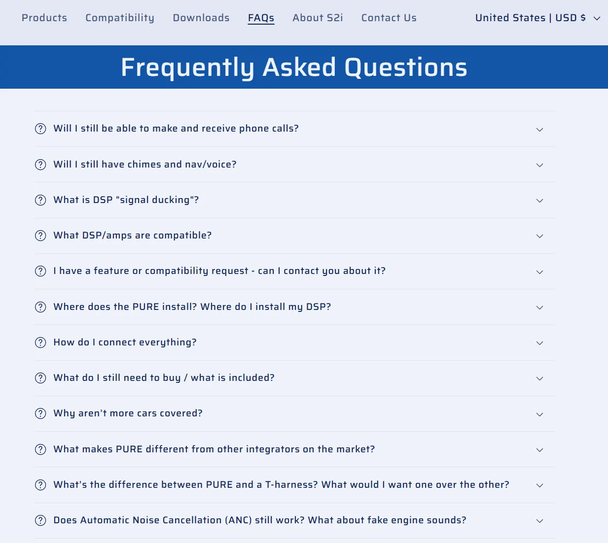

Folks, I'd love some feedback on what questions you have and expect others to have if they are considering the PURE integrator. I started a skeleton FAQ, pasted below:

Seems to be fairly comprehensive in terms of FAQ and covers pretty much all I had questions about.
