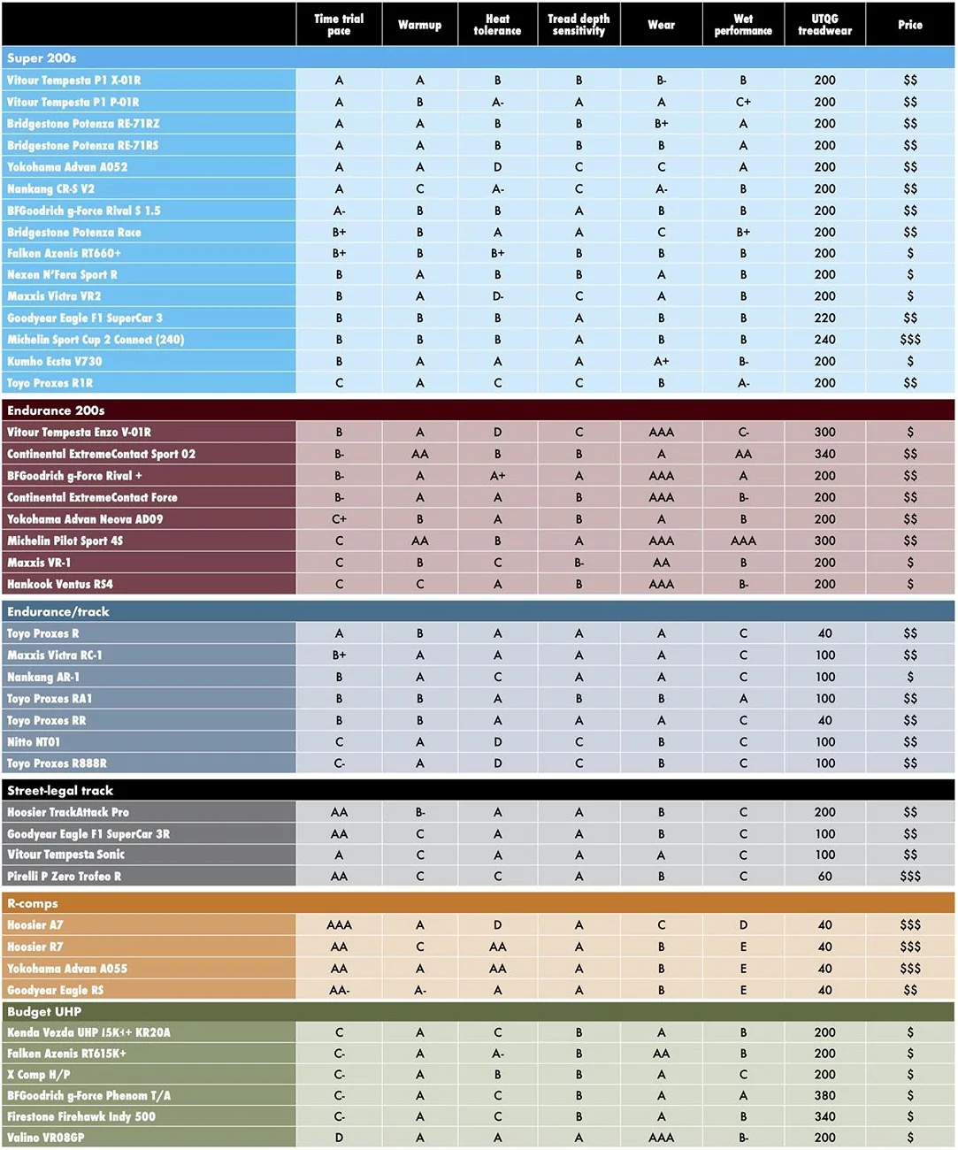

For the stock tires, these are also a wear item. I think the PS4S are fine for the first couple times you're on track, but I would consider replacing them, just so you don't wear them out so fast. For a beginner, I would choose an endurance tire, because they're less peaky vs the super 200's. They also last a helluva lot longer. They won't be the fastest tire, but when you're starting out, you shouldn't be thinking too much about lap times.
I'm running the Conti ECF on one of my cars and it's been very durable. I've tried the RS4 on my friend's car before and it can turn lap after lap without overheating. One of the local shops also recommends the AD09s as a good consistent performer.
This chart from GRM (Grassroot Motorsports) is pretty good:
