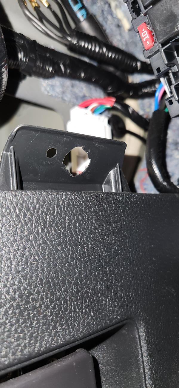

Took a more indepth look at the footwell and door today, seems like there is indeed no plug for the door and no assembly for the footwell.
Some times they hide a plug behind the panel with some electrical tape, but since the wiring harnesses are different, I'm guessing that may not be the case. That said, if you want to wire them in yourself the connector and pigtail/terminal joint part #'s are:
  • 04320-TY2-A00 - Pigtail or 04323-SP0-A01 - Terminal Joint
  • 04321-TY2-305 - Connector
Only pins 1 & 4 need to be wired. Looking at the wiring diagram, 4 is positive and 1 is negative.
Acura Integra Ambient Lighting 234734-2c344448ab387aa73f718ae7287f4daa
Thanks for the help! I think you're right about the electrical tape. I went to my friend who works at Acura parts to order the lights and he said the wiring diagrams seem to all be there and that I shouldn't have to order the pigtails, etc, as it should be plug and play.

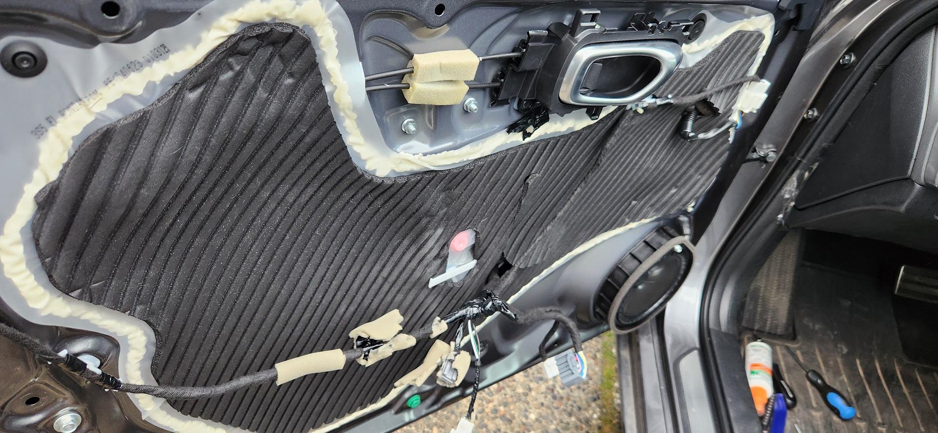

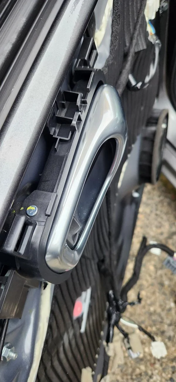

Took a better look at the door assembly. Seems like there's only one power source for the lights. I'm assuming there must be an extender terminal for the light strip and door handle as the one provided doesn't reach either.

I believe that connector is for the projector accessory, but you could probably use it for the ambient lights, just would need to make the harness.
Yeah, I asked the Acura parts guy. He let me know it'd be easier and cheaper to just straight up switch the entire door harness as the A spec non tech doesn't include the 2 terminal joints for the ambient piping as well as the door handle. The entire harness per door is about 90 CAD so it could be worse. Will be ordering and installing soon.

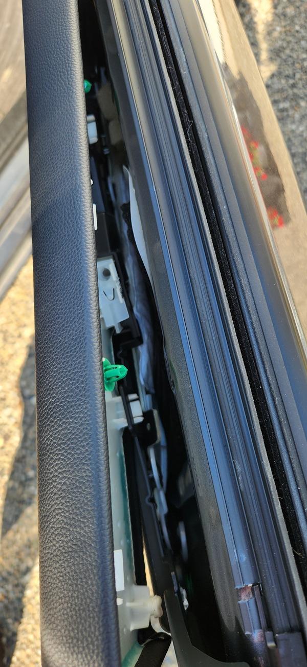

Installed the A spec Tech door harness and ambient lighting. Very annoying process. The 2 lights in the door don't want to turn on which leads me to believe the regular A spec just isn't programmed to supply power to the extra connections

Perhaps there's a fuze or something of that sort to power the 2 ambient lights? The rest of the door receives power as usual but the 2 lights just don't want to switch on
