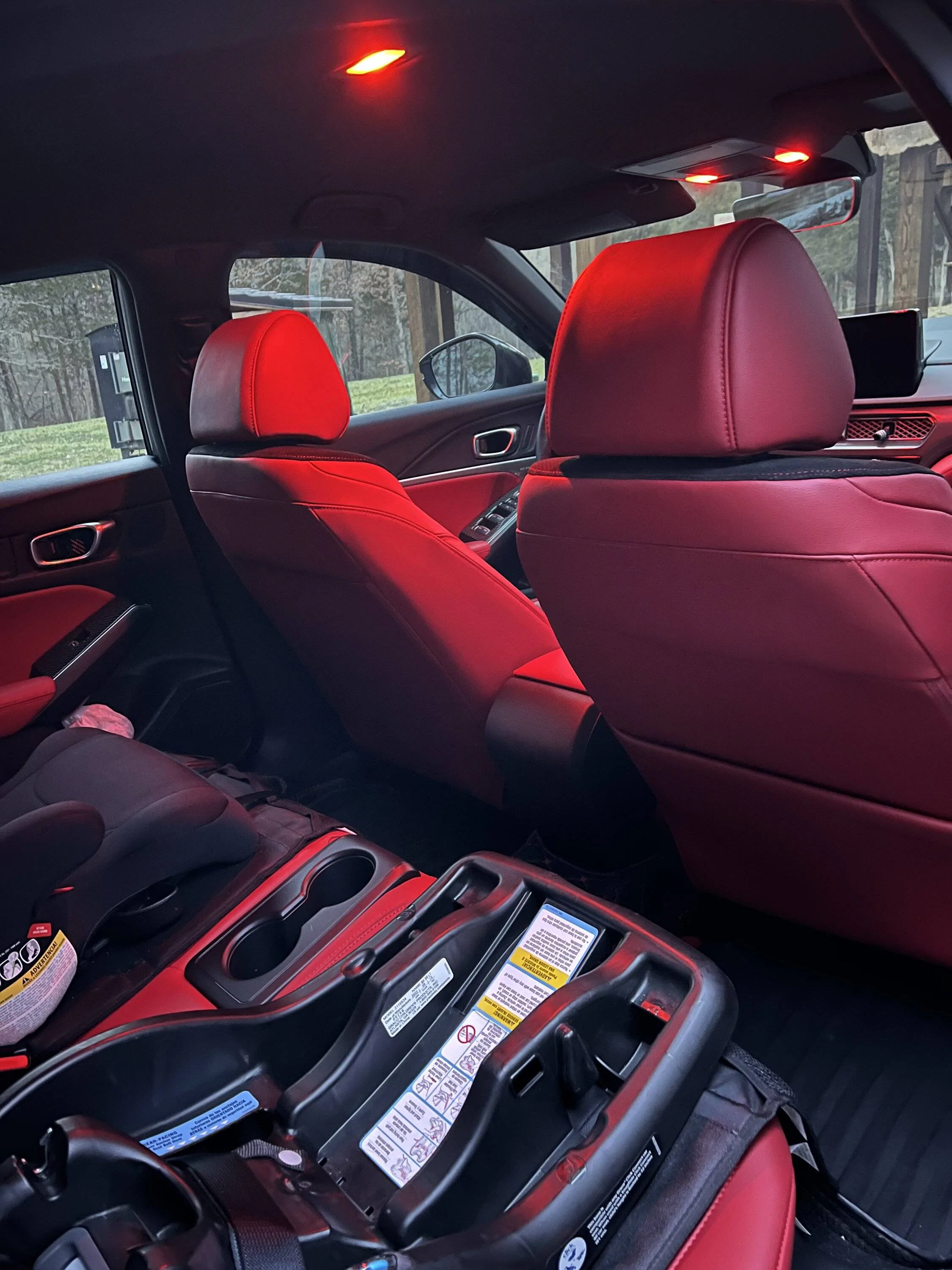

So I took everything out & painted the lenses in the doors, put red brake tape on the charger & overhead lights. I like it! But I agree that it’s rather dim. I don’t like my gauges that bright at night but could use some more red, so went ahead & ordered the red leds.

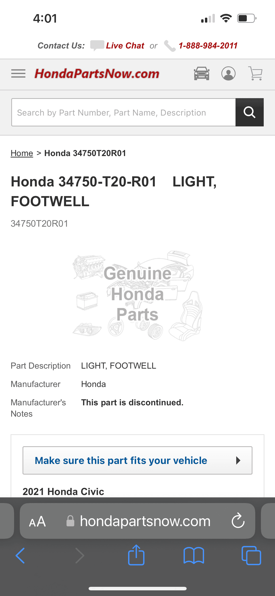

So Honda Parts Now is saying this item is discontinued. Is there another part number to use by chance? I’ve tried ordering two different times so far, a few months ago & a few days ago with no luck.
I ended up going to my local Honda dealer, and I was able to negotiate a better per unit price since I was ordering several. Sure it took a couple months, but it all worked out in the end.
1,477
1,192
You mentioned the 34750-T20-A01 that is only $5. This is the white glovebox light from the CTR.
If you want Red lighting then you need the 34750-T20-R01 part.
The part is a LED module. It is a small rectangle. Basically all the lights on the Integra are the same module. All I am doing is swapping to the 34750-T20-R01 part. They are all plug and play.
The ambient strip is controlled by one LED and the door handle lights are a different LED. But both can be swapped with the 34750-T20-R01 part number. I honestly forgot about the door handle LED until today so I plan to buy two more parts to swap them out with.
Long story short, order 7 - 34750-T20-R01.
