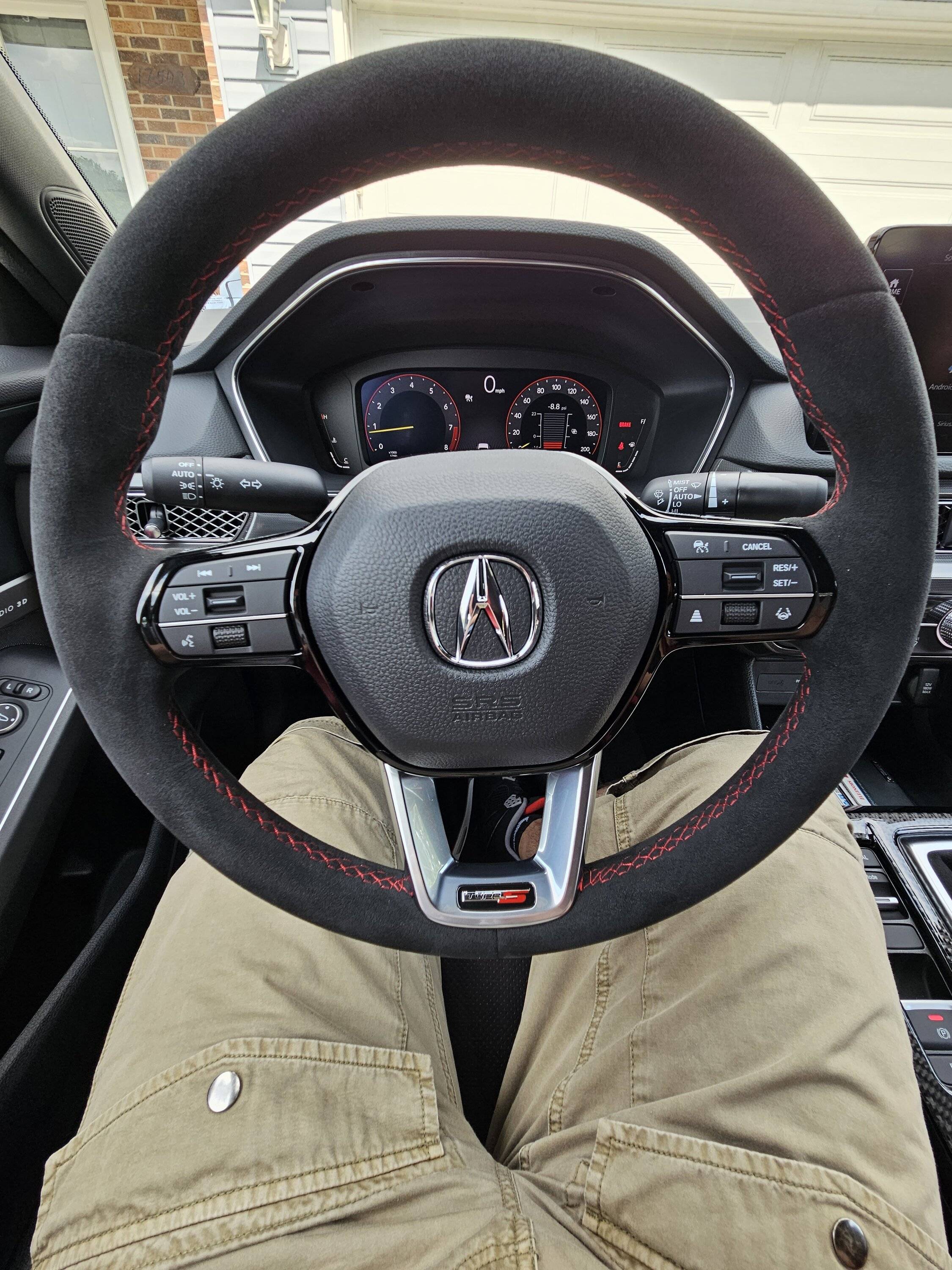

Anyone else notice their alignment is off center?
Never had this happen with a new car (300 miles). Haven't hit any pot holes or even driven it hard yet.

Looks like whomever installed your Alcatara steering wheel didnt have it aligned when they tightened it..
this video could help you fix it or take it back to dealership..

Yeah there's a handful of people referencing this, and it does at least appear to be linked to the steering wheel install.
I think I saw somewhere the issue applied to the OEM wheel though, but I can't remember where I saw that.
2,862
2,469
Steering wheel attaches with a spline. When they installed it they were off probably one tooth or so.

Cars going back anyway on the 9th for the mirror caps to be installed correctly. They can adjust this too.

Same issue for me, could be alignment or steering wheel accessory being off by 1 tooth on the steering column shaft. Easy way to check:
1. Turn the steering wheel all way LEFT and take a picture
2. Turn the steering wheel all way RIGHT and take a picture
Take note of the amount of degrees (visually) you can turn LEFT, against the amount you can turn RIGHT. In my experiments, if said amount is under 1 inch (perimeter-wise) then you're good; and means that you probably need alignment.
