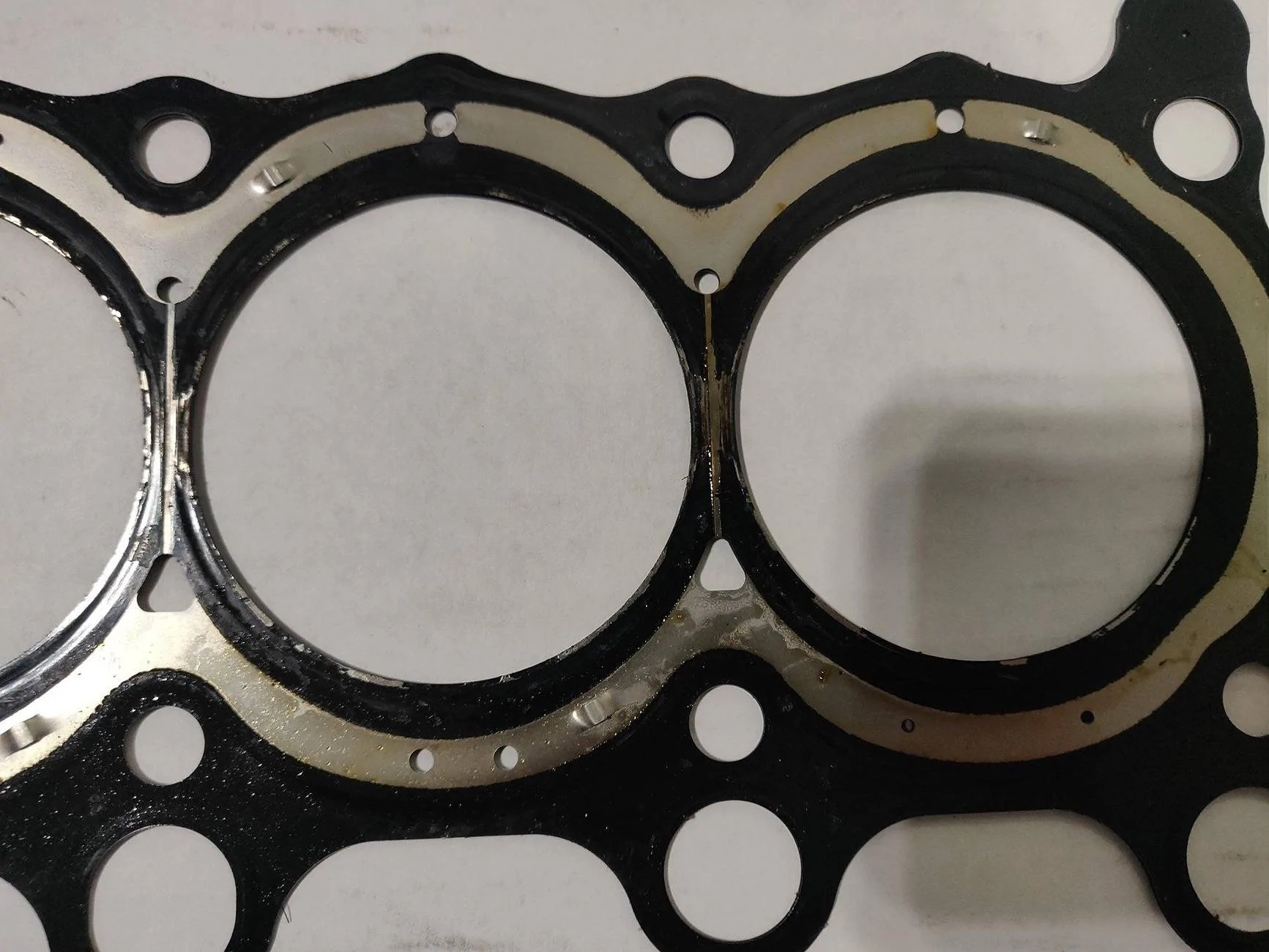

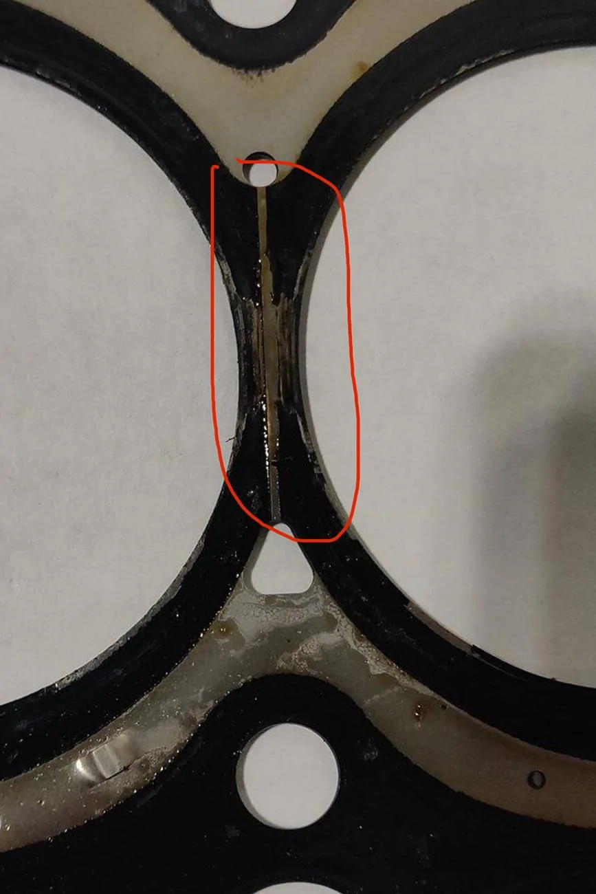

The head gasket issue is because there are a small coolant tunnel between cylinders to get get fluid from the back of the block to the front (circled in the photo) The problem is the gasket itself doesn’t have a lot of meat on it between the cylinders because of that. CYL 2 & 3 being the more common location to leak. There are civic that have had head gasket issues but personally think it’s more exaggerated on the accord/crv because they’re bigger cars than a civic. Also why I think Honda made the accord all hybrid only to avoid the 1.5t issues and probably see them going that direction all together to get rid of the 1.5t in there line up. Hard to tell when or where it will blow since there’s cars with a couple thousand miles and some with over 100k miles. If you ask me, if you need a bigger car like a crv/adx I would avoid the 1.5t for longevity on the bigger vehicles.
