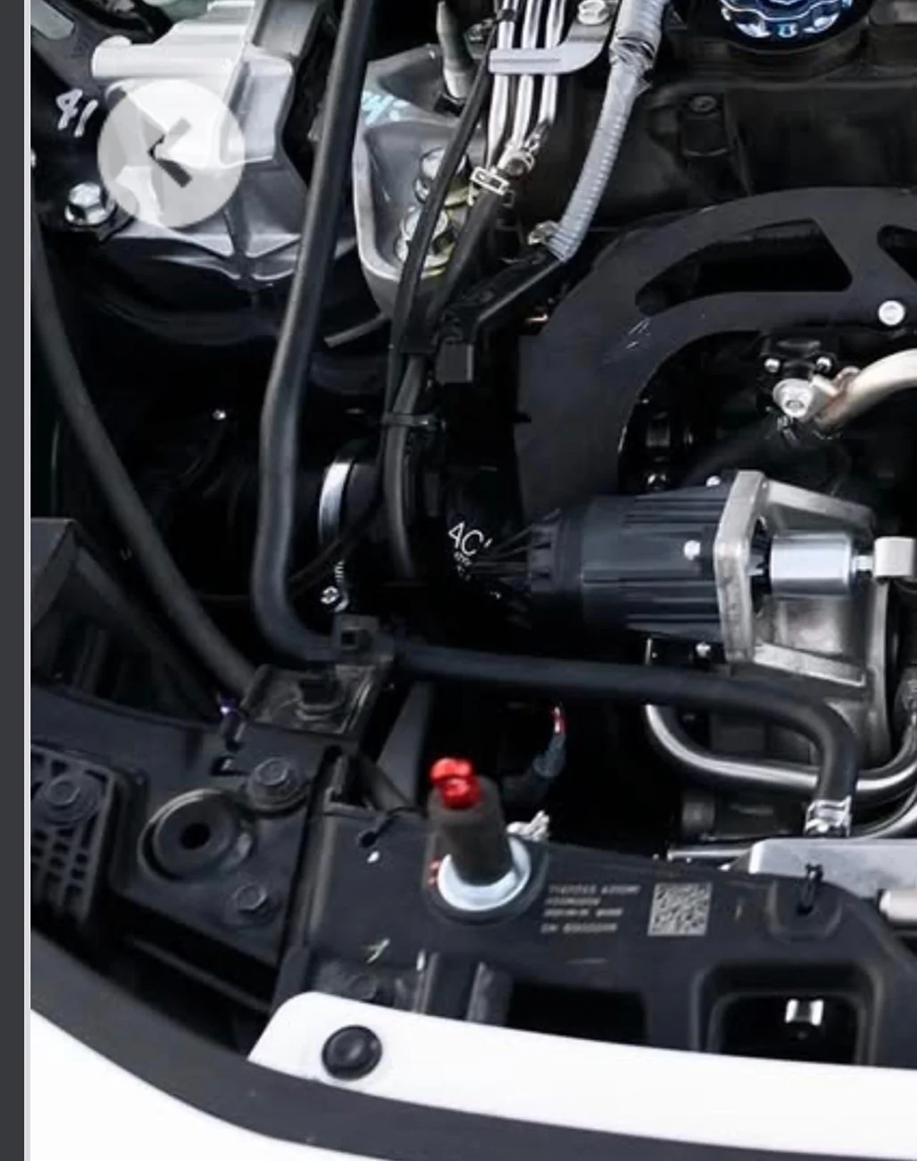

I think the filter is likely to be different. Looks like it routes directly from the turbo to the wheel well, but this is just based off a pic from their socials. They also shared a very short snippet of a pod discussing a bit of the design advantages (efficiency / weight):

I understand it requires more effort and ups the install difficulty, but I am surprised nobody else has attempted a solution that avoids routing over the turbo.
Why didn't Honda just turn the turbo? There has to be some reason they decided to go with this convoluted packaging.
The tc series cars have the intake going shorty to the front, I believe in either the upper grill pocket or the headlight. For a true racecar, going to the headlight is a great move. Cuts all that weight off the nose and no one really needs it. The exception is events like 25hrs of thunderhill, which do require night driving.
I'm looking to shove an oil cooler out of the way and route some air out of the high pressure upper pocket into the fender pocket there. I wonder where exactly they're planning to route since it's not exactly easy packaging there. I also wonder what filter swaps will look like... But I guess that doesn't matter much since I've known a lot of people to just never change their air filter once they go aftermarket šŸ™ƒ.
