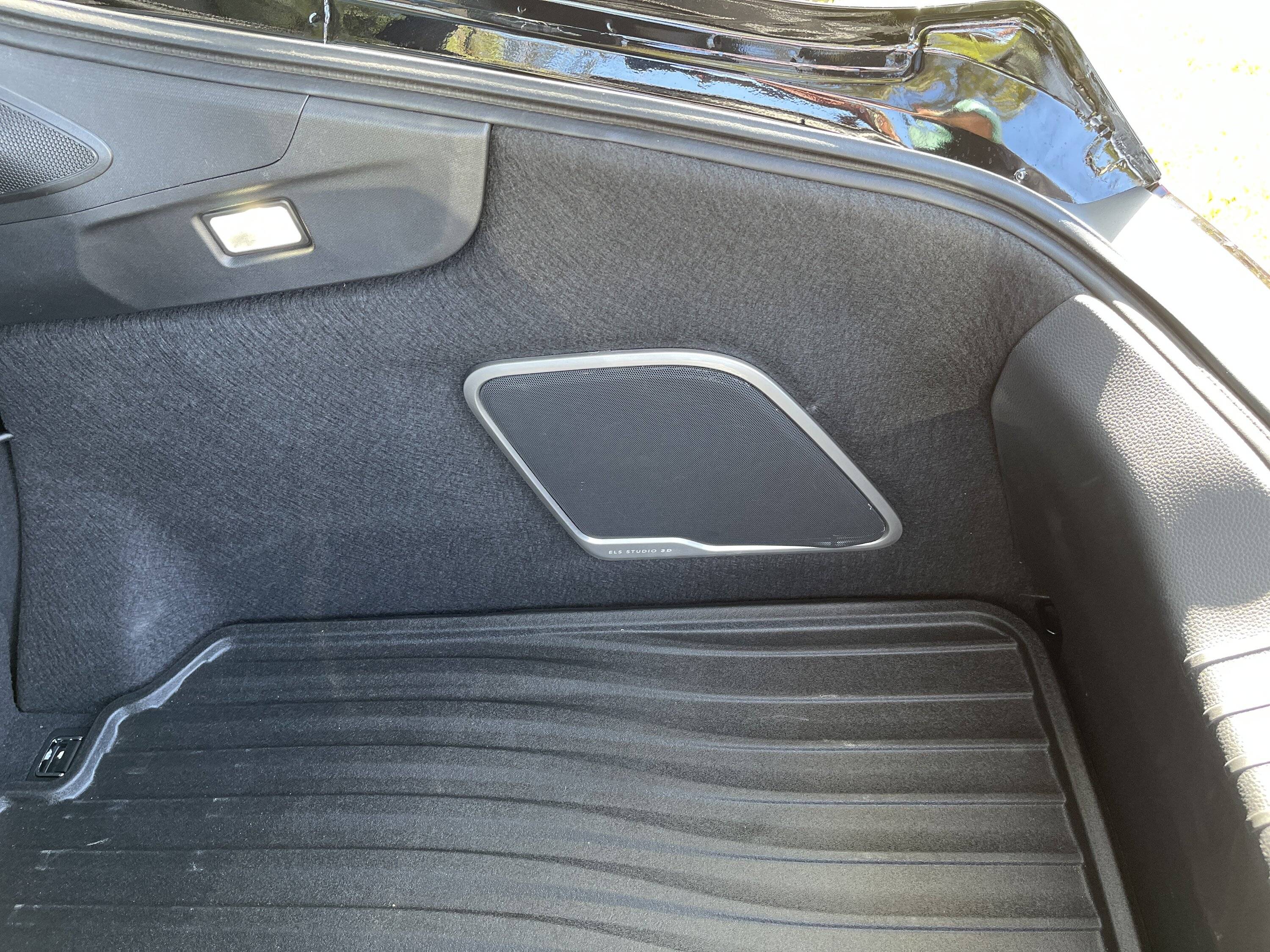

this is awesome. How close is the speaker currently to the grill?

There were these foam spacers between the box and the sidewall panel that allow the speaker excursion room to move. I don't see or hear anything odd so it seems to be ok. I think they were about 1.5 -2 inch. The rockford is much tighter and i don't see it moving as much as that stock speaker.

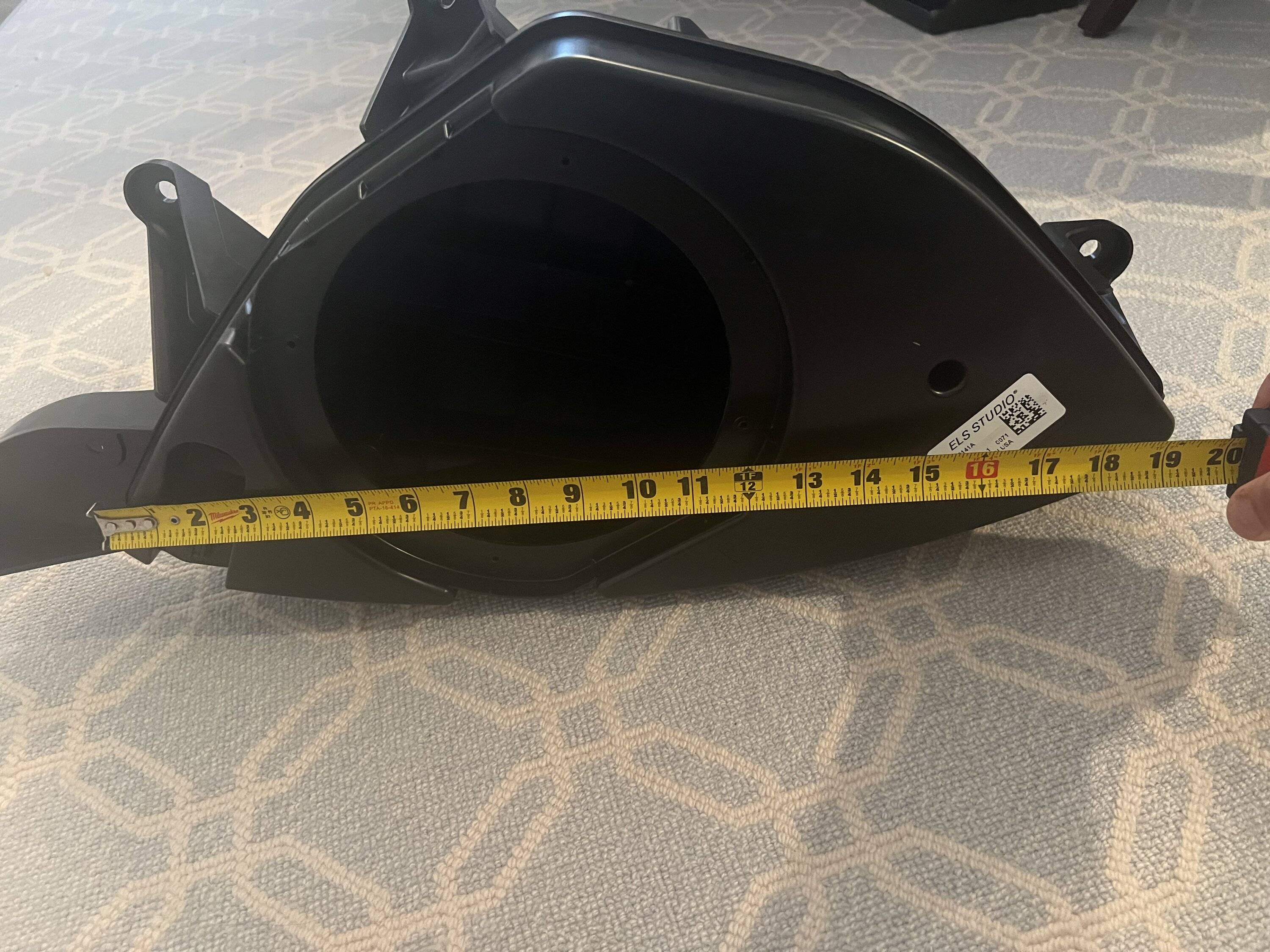

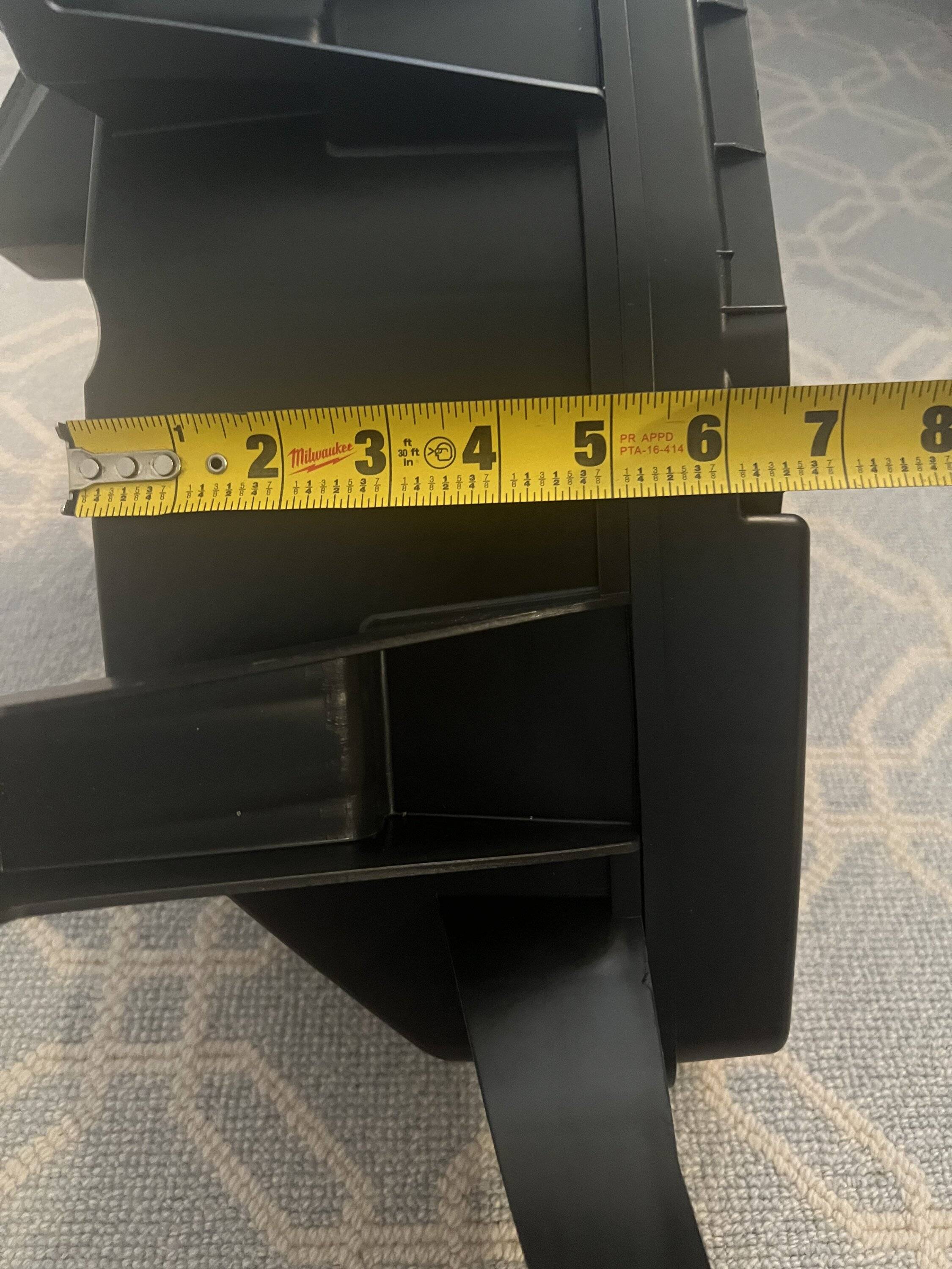

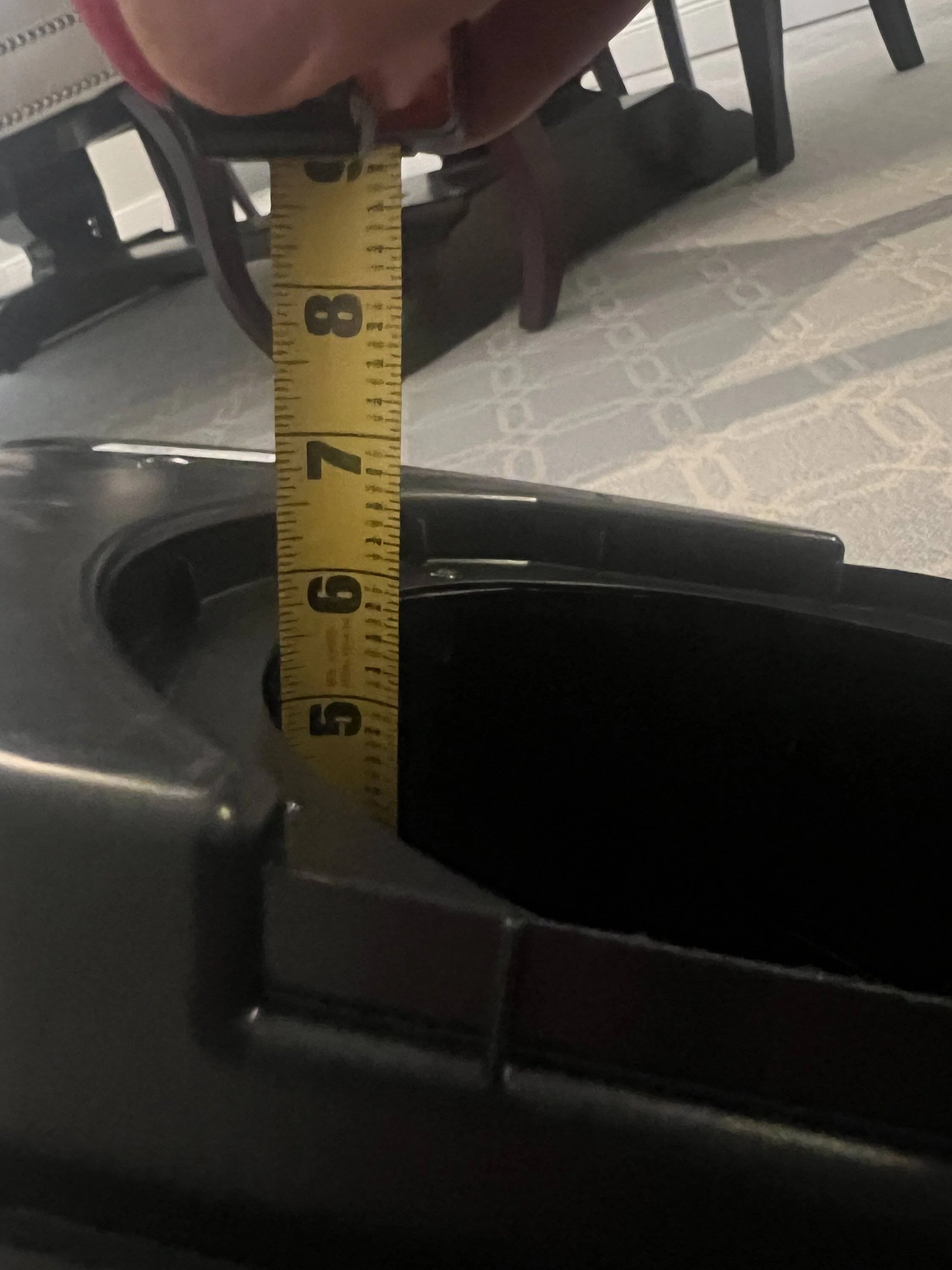

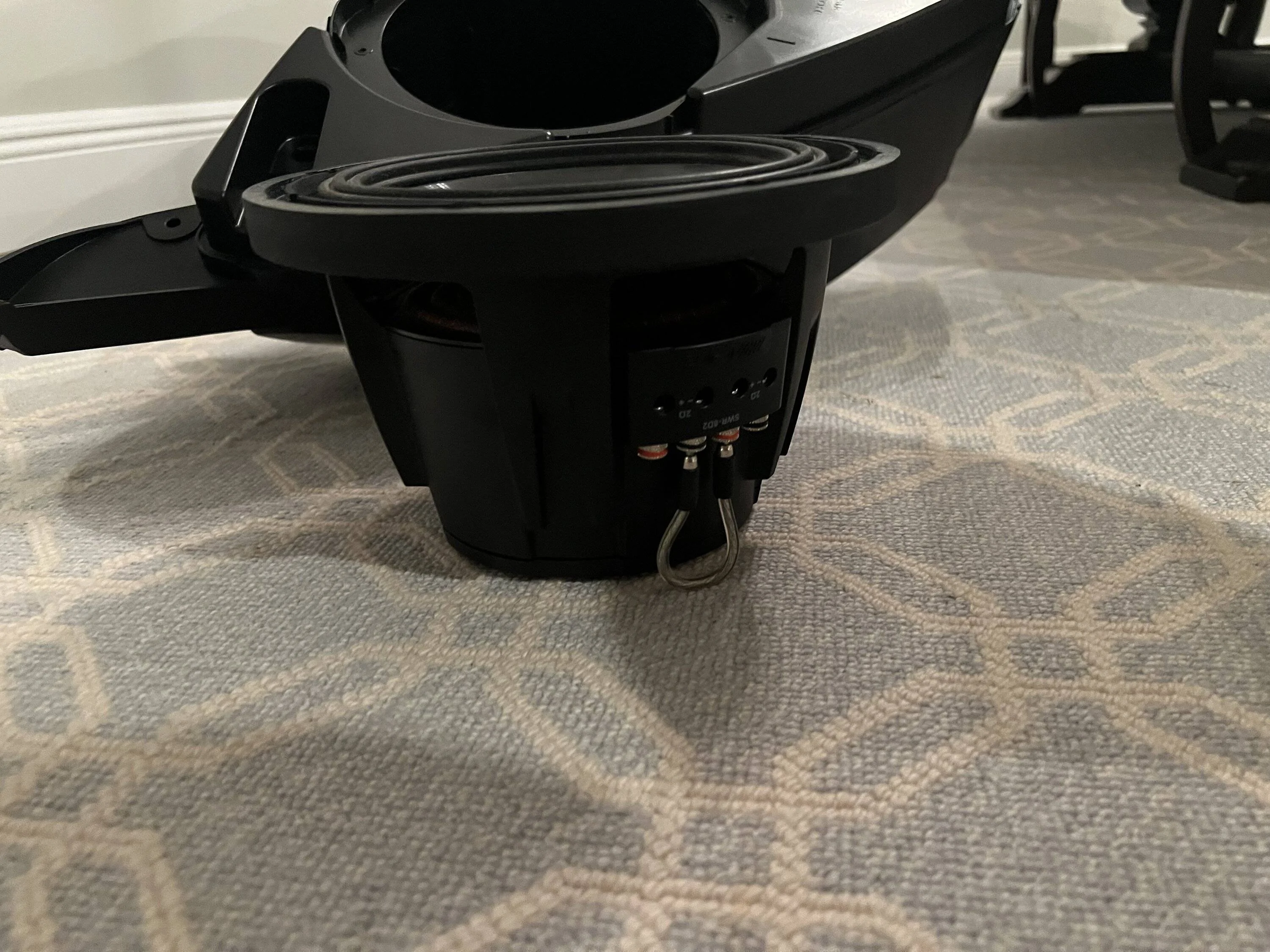

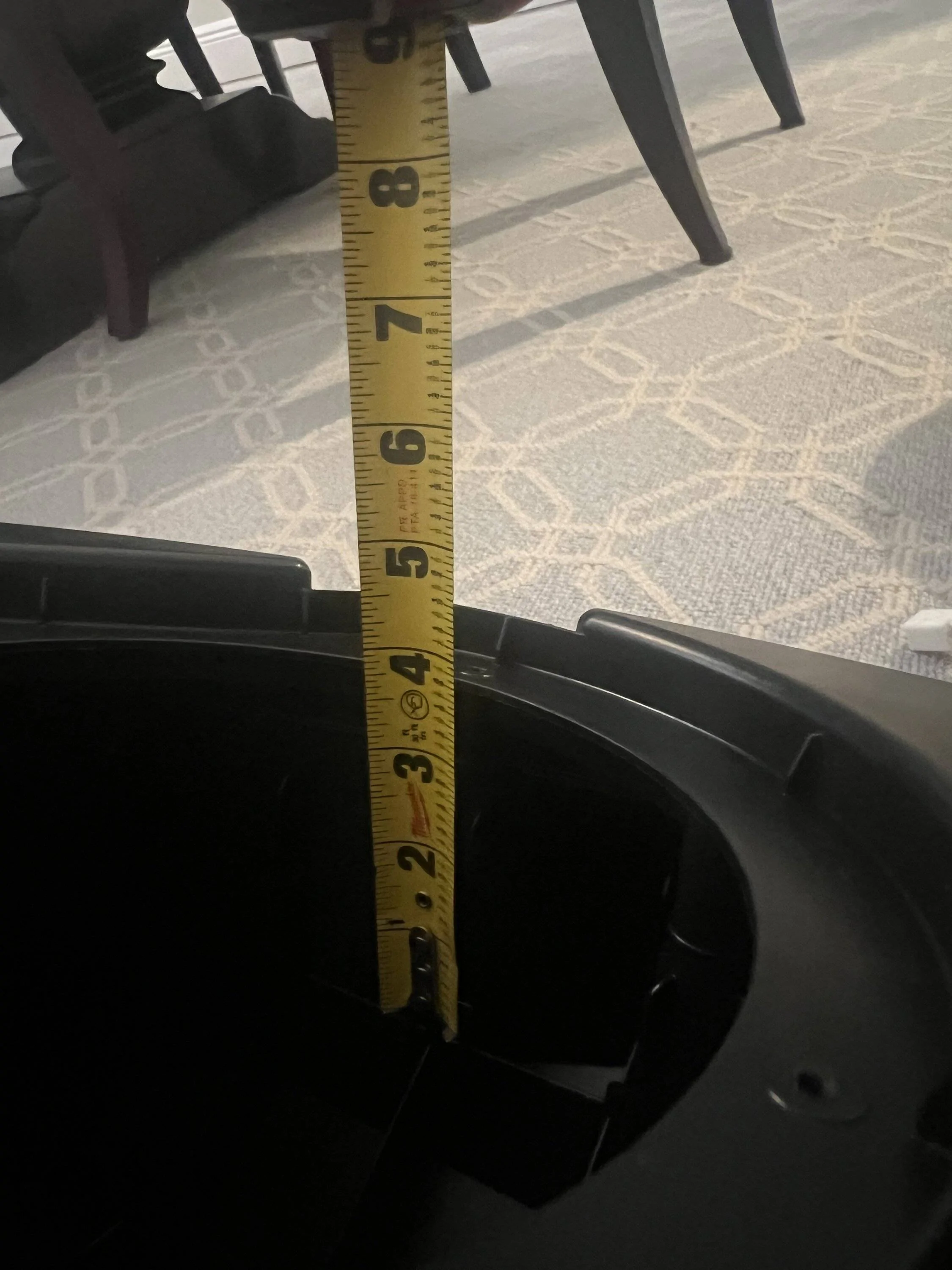

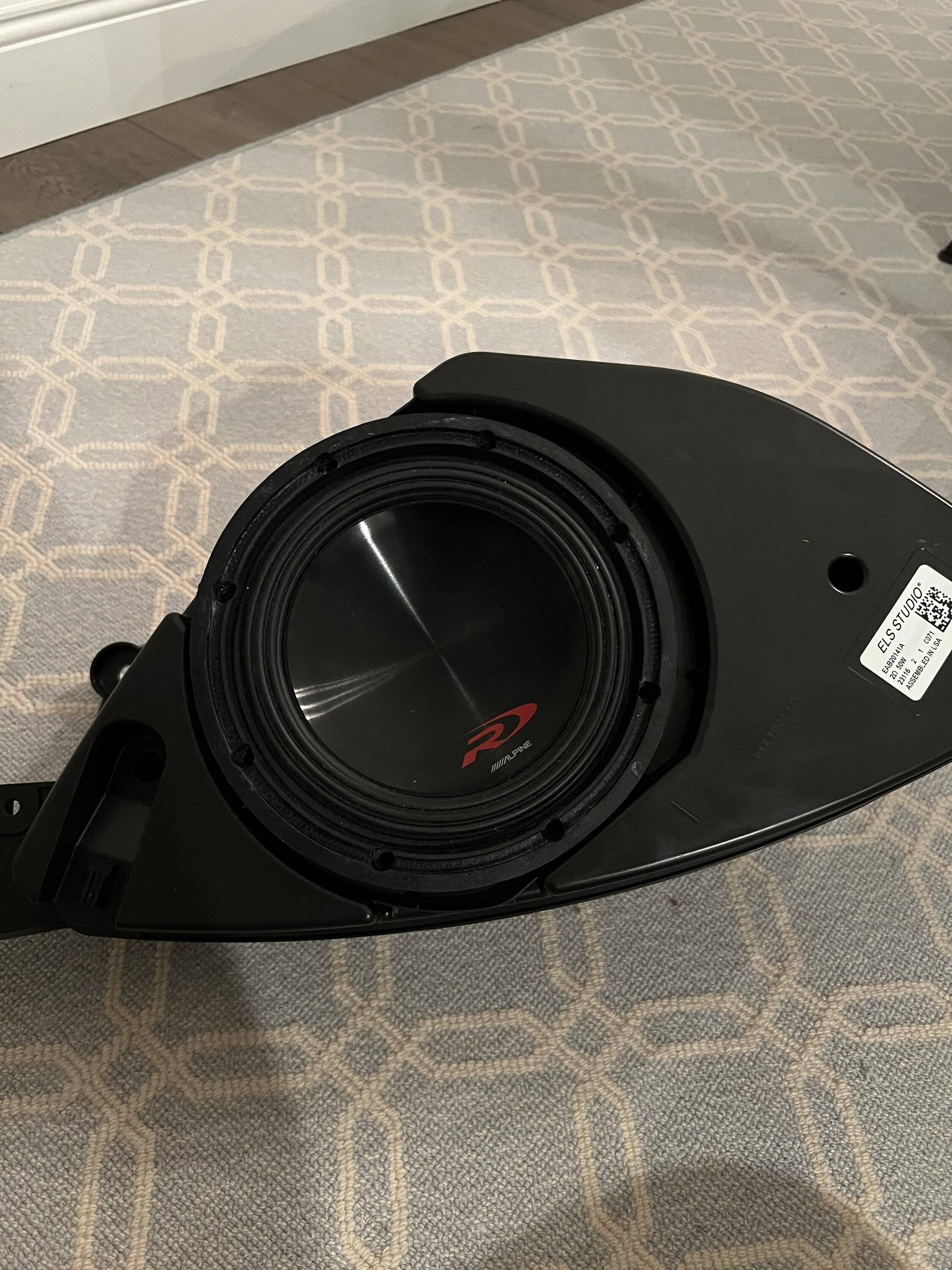

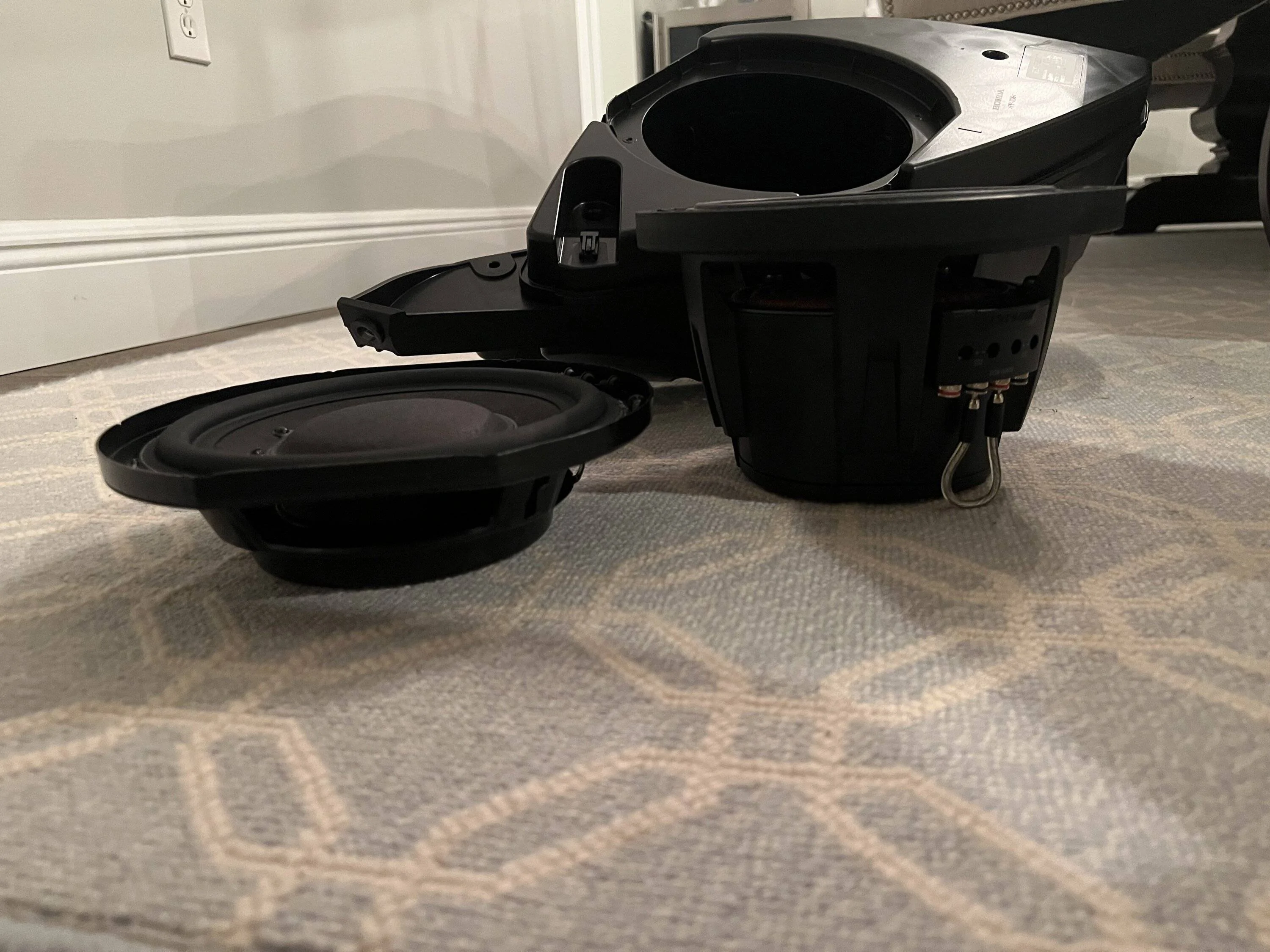

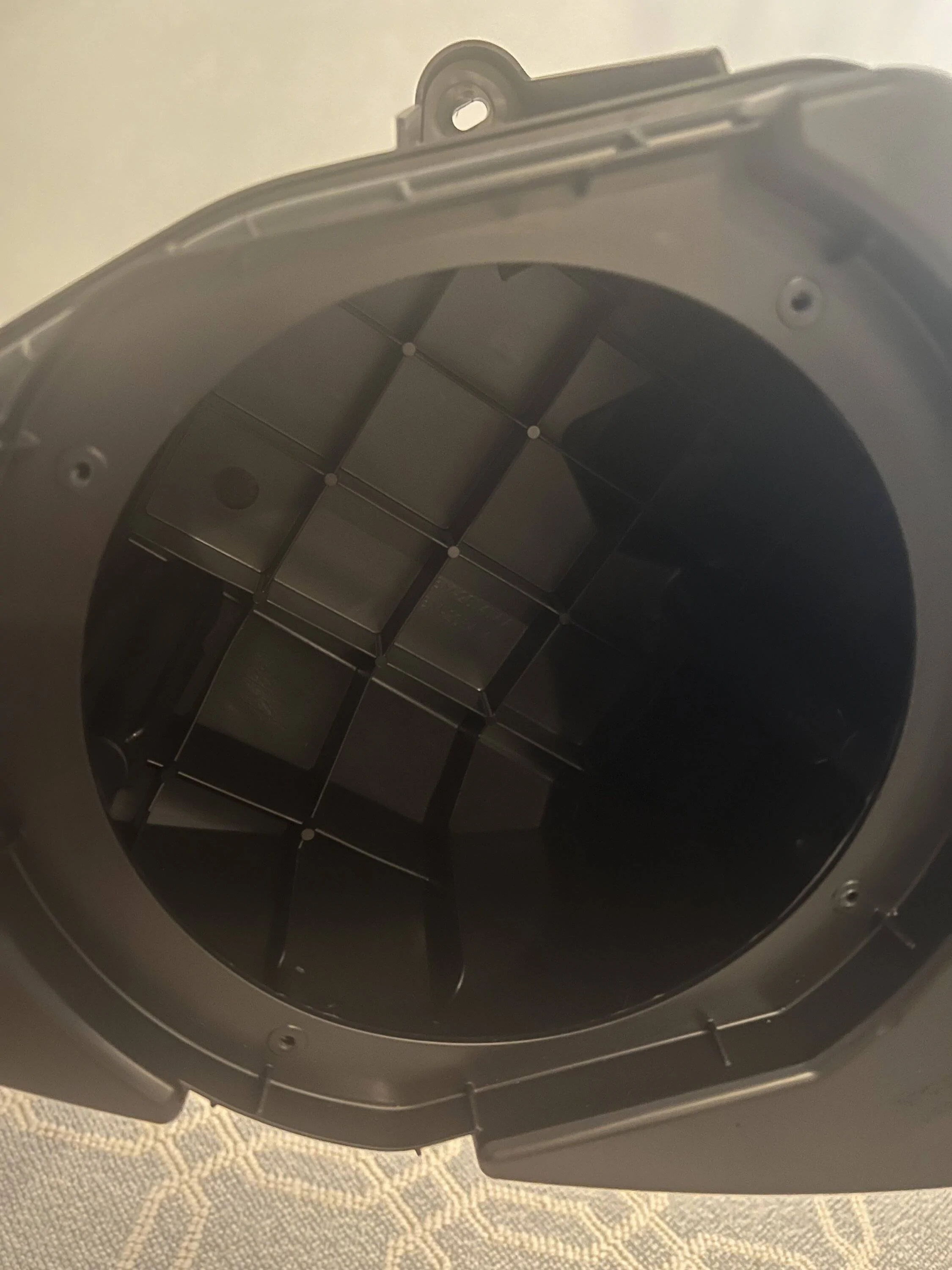

I like the stock look. I’m going to see if I can get away with a small trim ring without chopping up a speaker and the box. The box is relatively big and deep. Here are some pics of it outside the car.

Sorry I should have been clearer. I'm going to see if I can put an alpine type-r in there with an aftermarket amp. Thanks for the inspiration!
Are you trying to fit an Alpine R2-W8D4 in there? Keep us posted, would love to do the same, but it appears a tad too deep from your photos.
it’s an older model but it should fit I just don’t want to cut the box. I’m going to see if I can trim a spacer. You can see the difference in depth of the stock vs the type-r. I’ll keep you guys in the loop.
