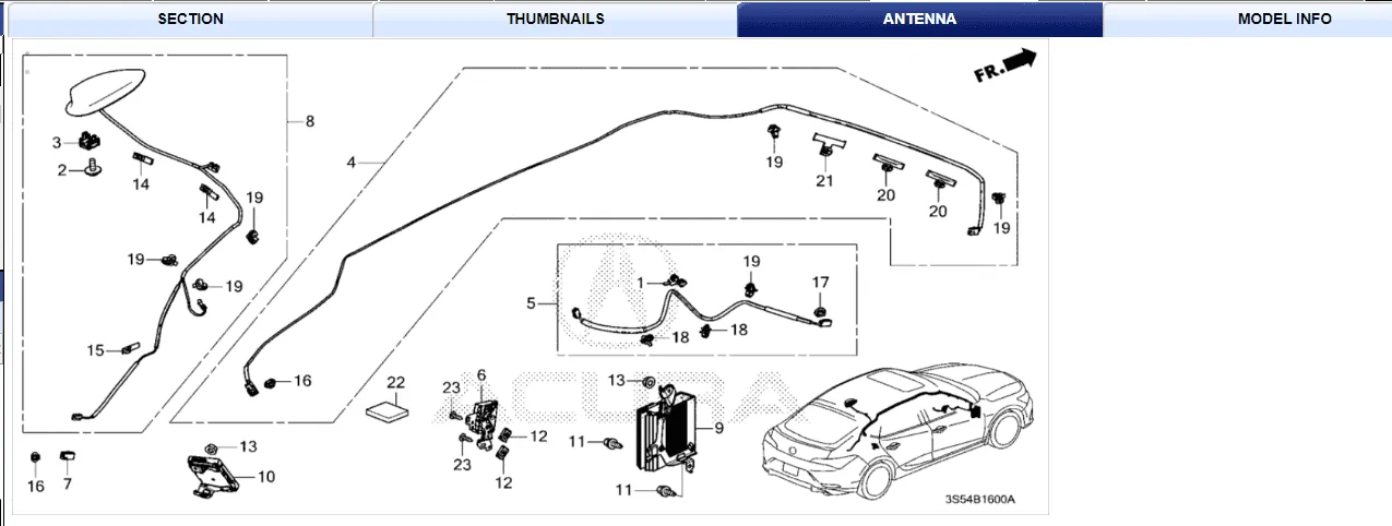

Hello all,
Does anyone know where the ANC is located in the 2023 Integra? It is NOT behind the glove compartment where the Civic Si’s is located. I looked everywhere and nowhere to be found. Or does anyone know how to bypass it another way. I just installed a subwoofer and it makes fake engine noise, and no music at all.
thx

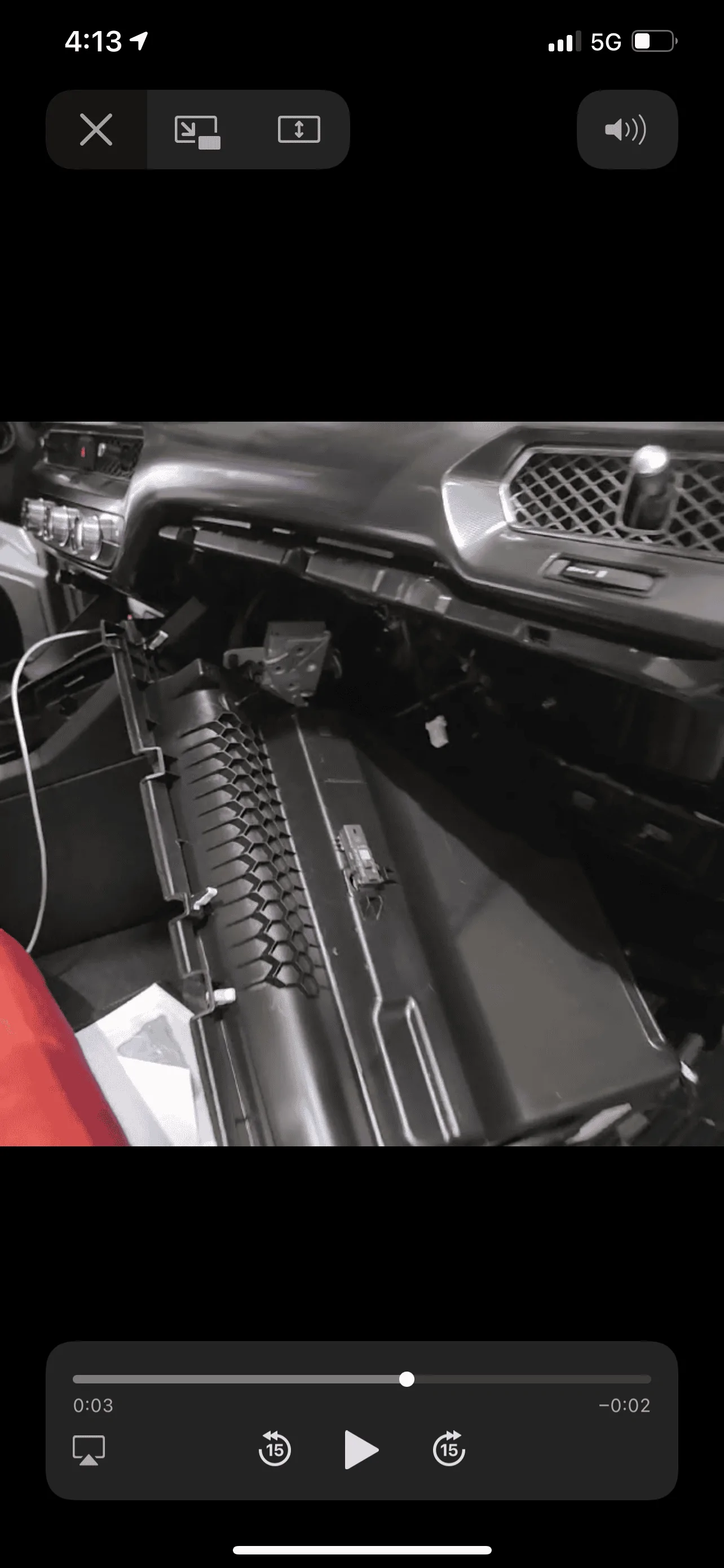

Thx, yeah, I just had an after market amp and subwoofer installed. We watched the Si video, but the ANC was not there. We looked around and did not find anything. There was a larger grey box where the other ANC’s were in other vehicles but it did not look the same at all.

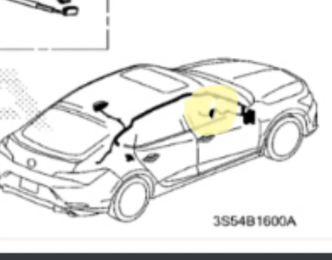

Looks to be in the driver's side kick panel. Reference #6 in the diagram. That's the active sound control unit.
39200-3S5-A11 (6mt Tech)
39200-3S5-A21 (CVT Tech)
-G

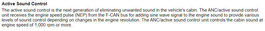

Active noise canceling. It also goes by ASC, Active Sound canceling.

Just curious, in this diagram, where would you say #6 is? Is it’s where I highlighted? If so where would that be ?
thx

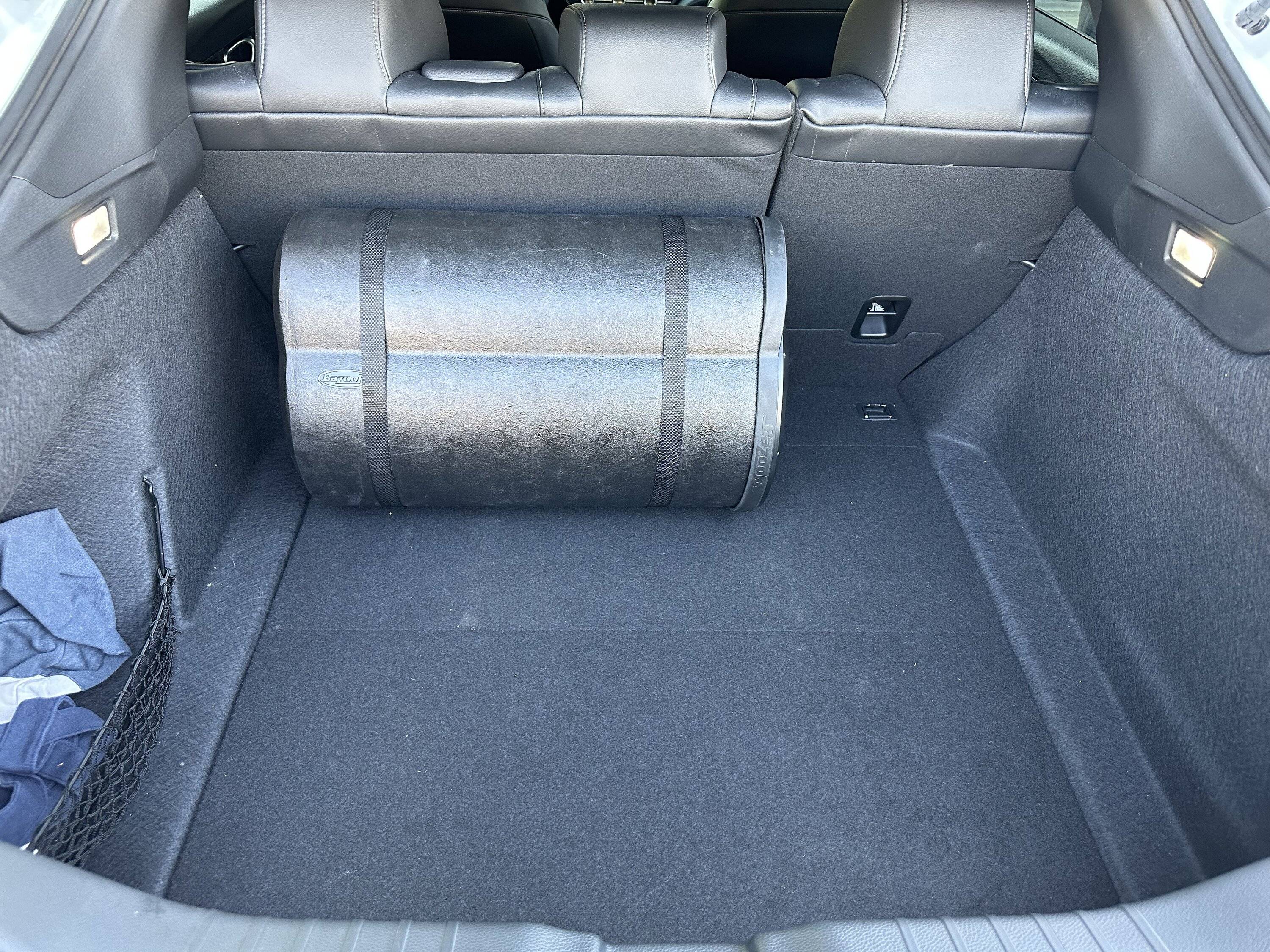

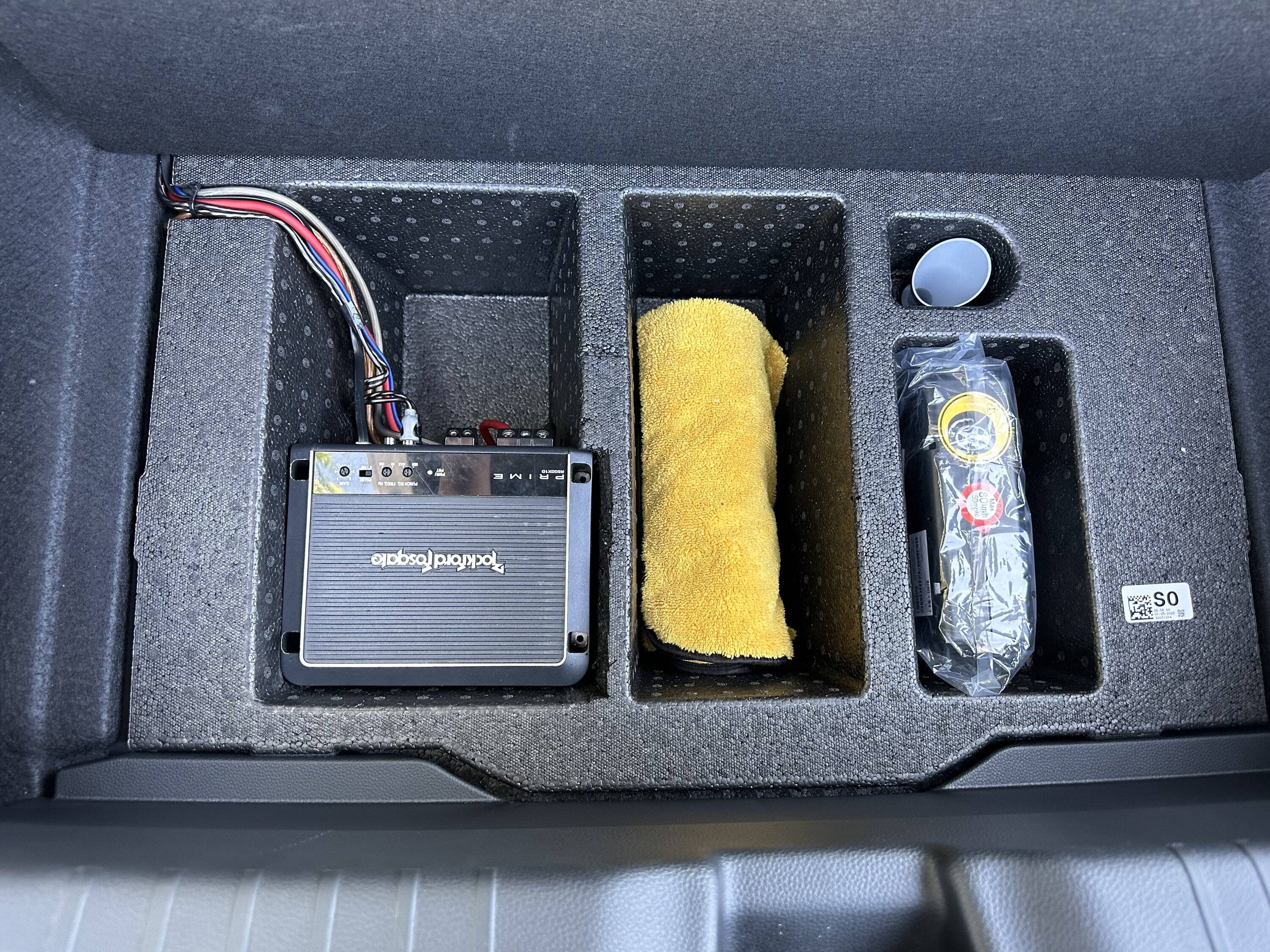

Well, I am waiting to unplug my ANC, but in the meantime I did install a 12”bazooka tube. I’m not getting much ANC interference. 😀

2024 A-Spec Tech 6MT
Should be this silver box. Not same location as civic
