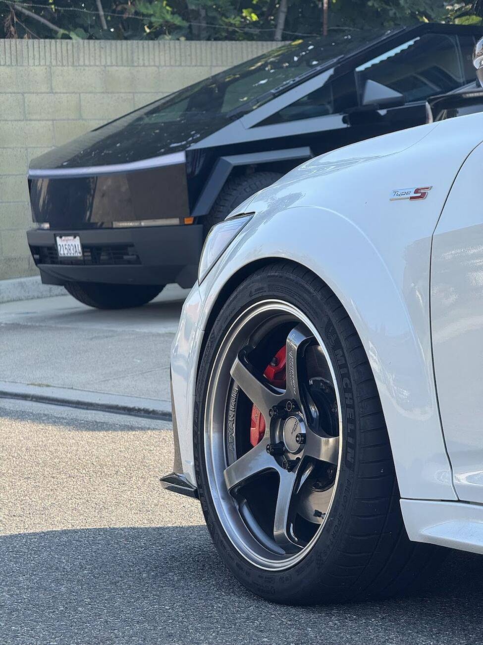

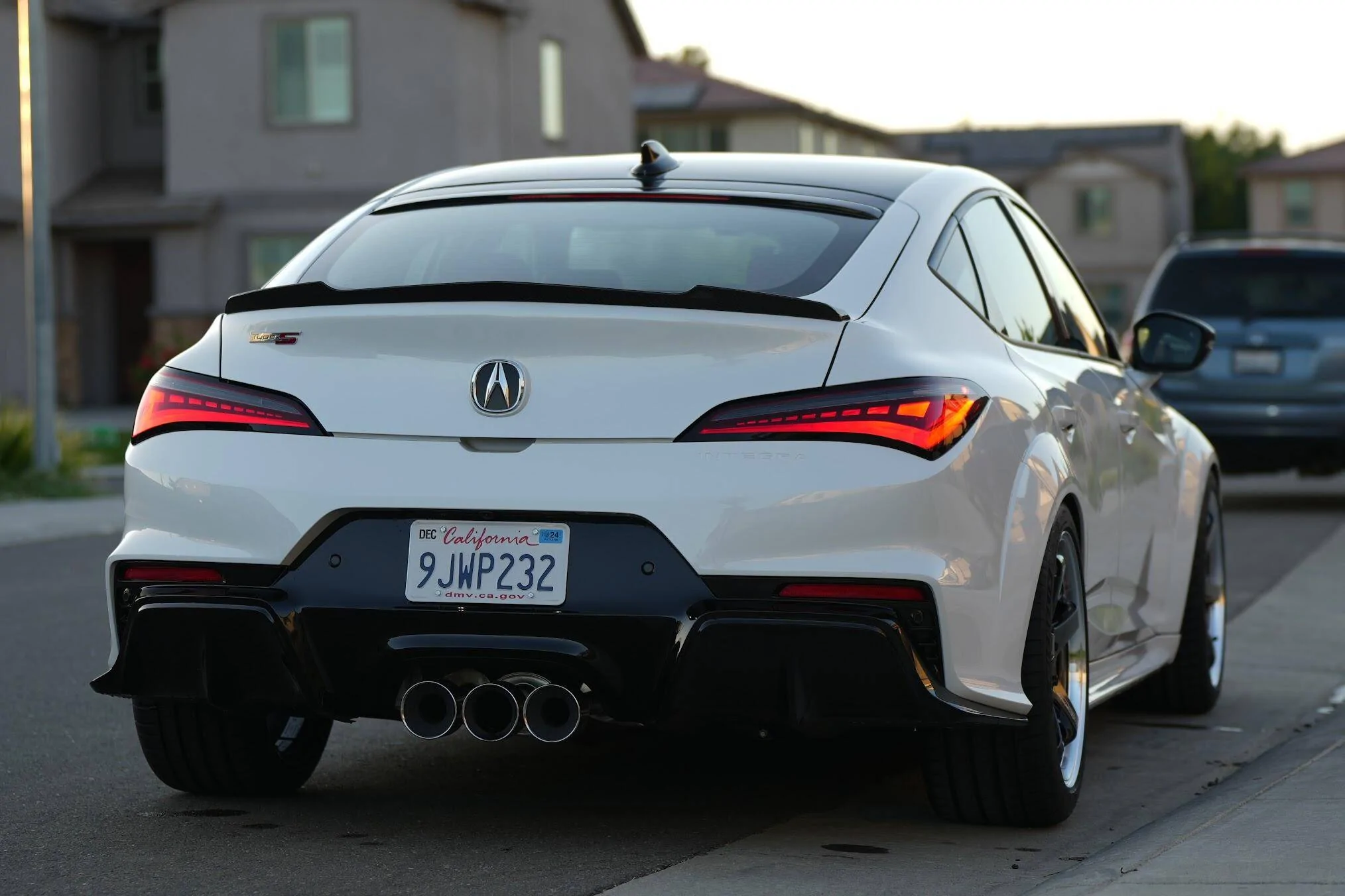

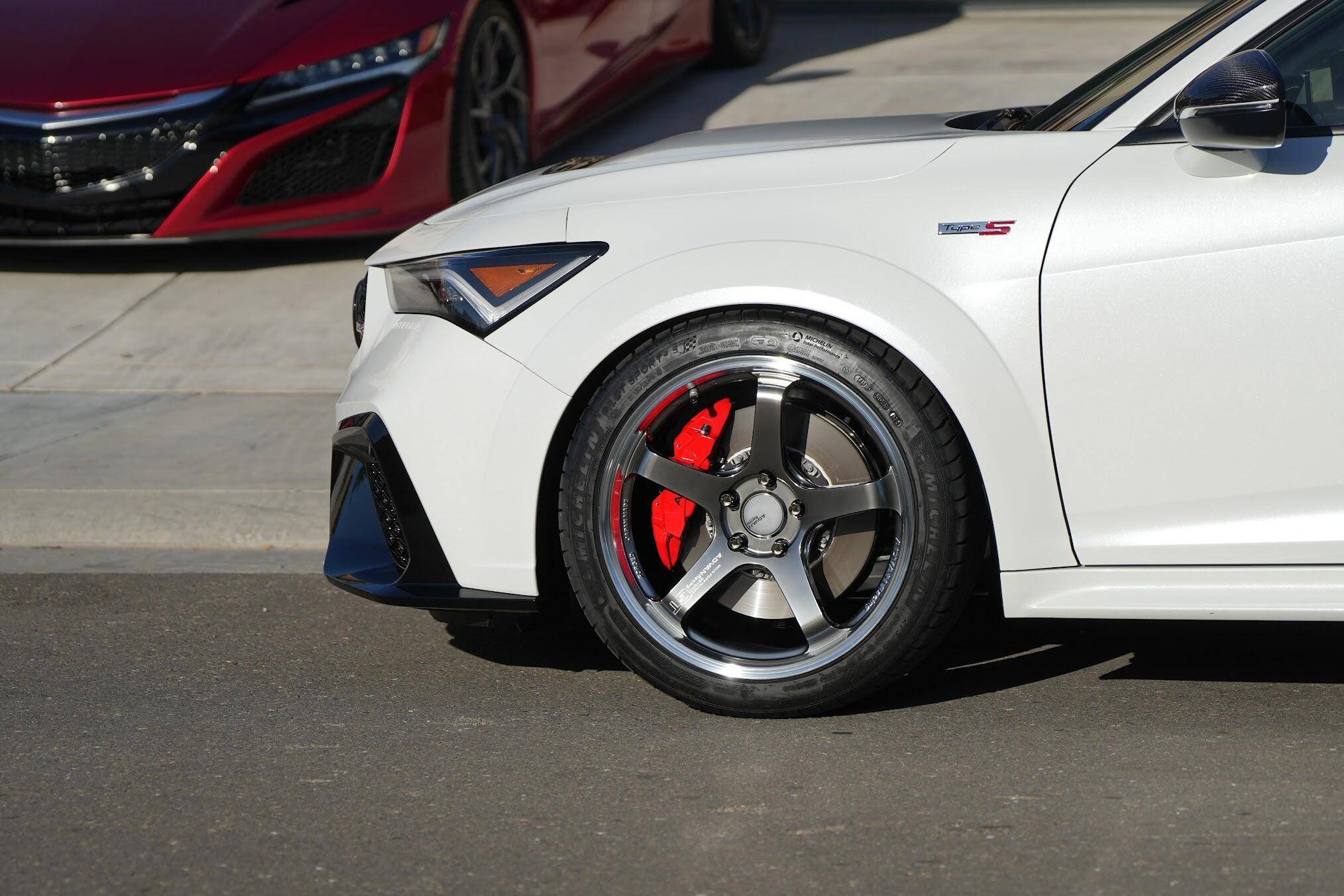

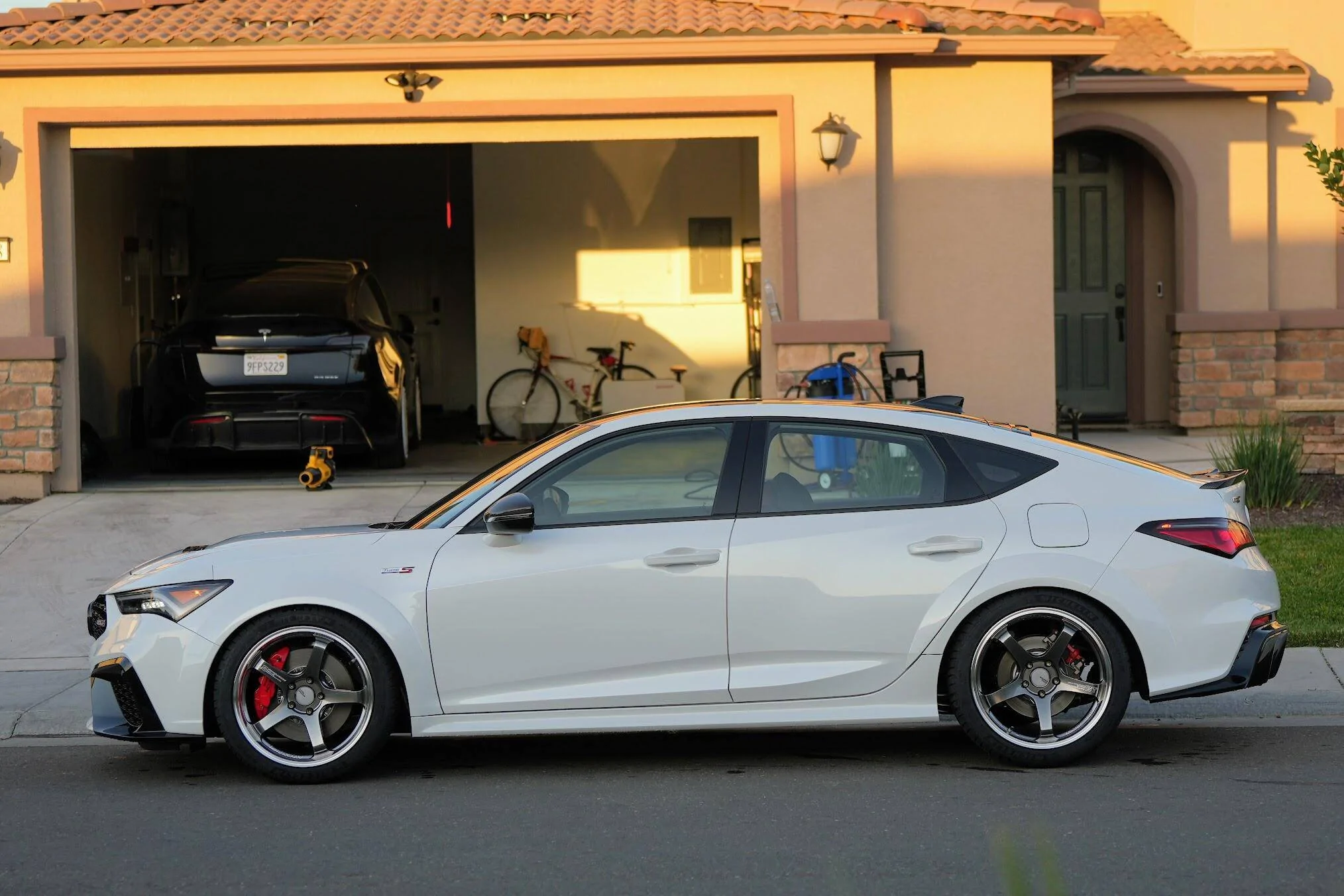

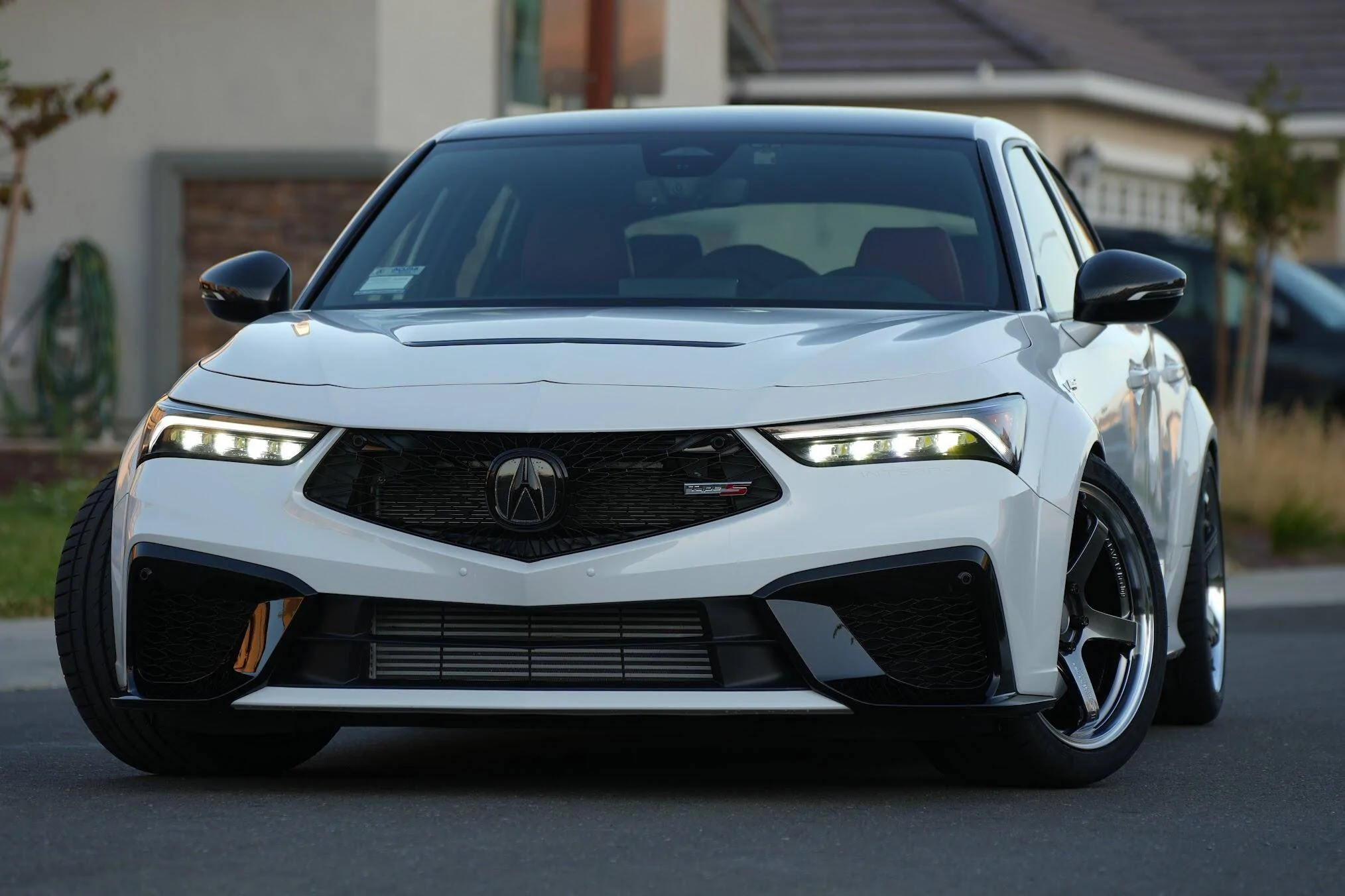

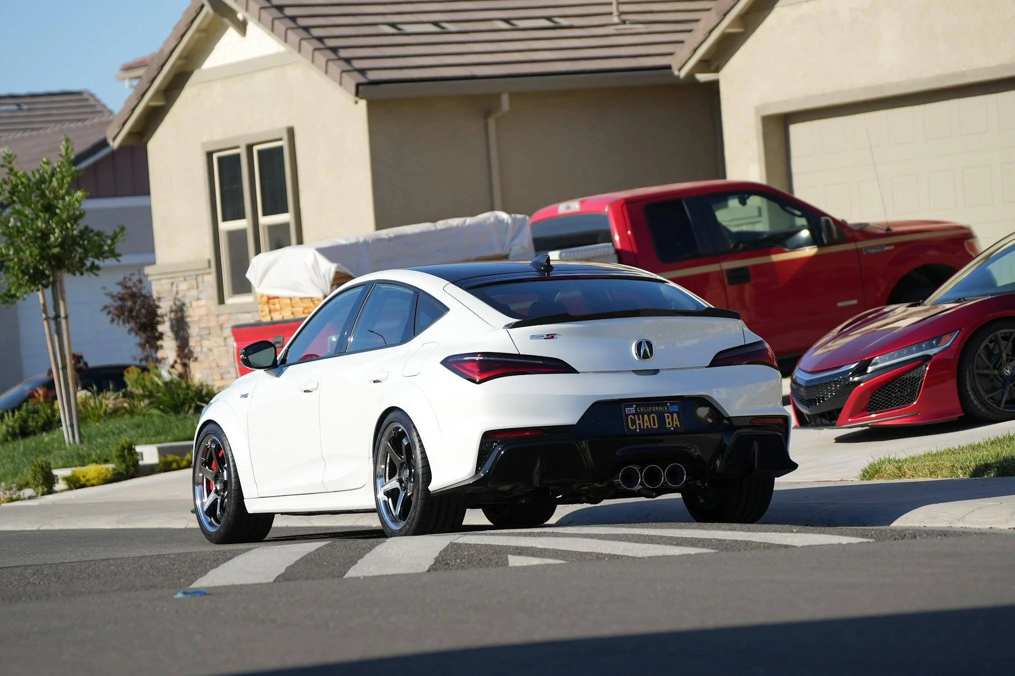

Here are some pics of mine 19s in Racing Titanium Black
This looks great. No issues at all with the 275/35-19 and +45 at stock height? I went with a +51 wheel and am also keeping the car stock height for the time being. I like how the 35 profile fills the wheel arches, and gives more protection against crappy roads.

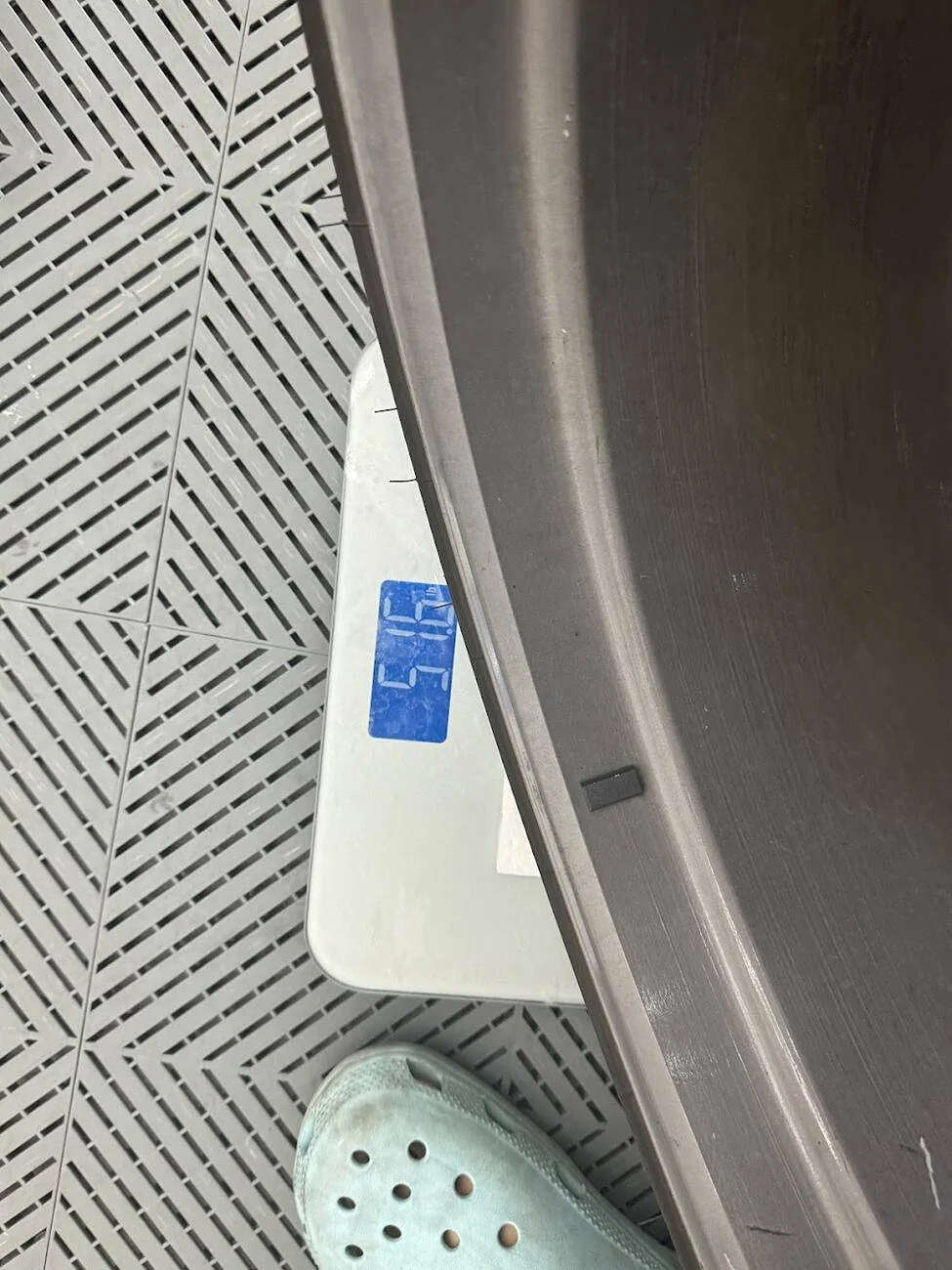

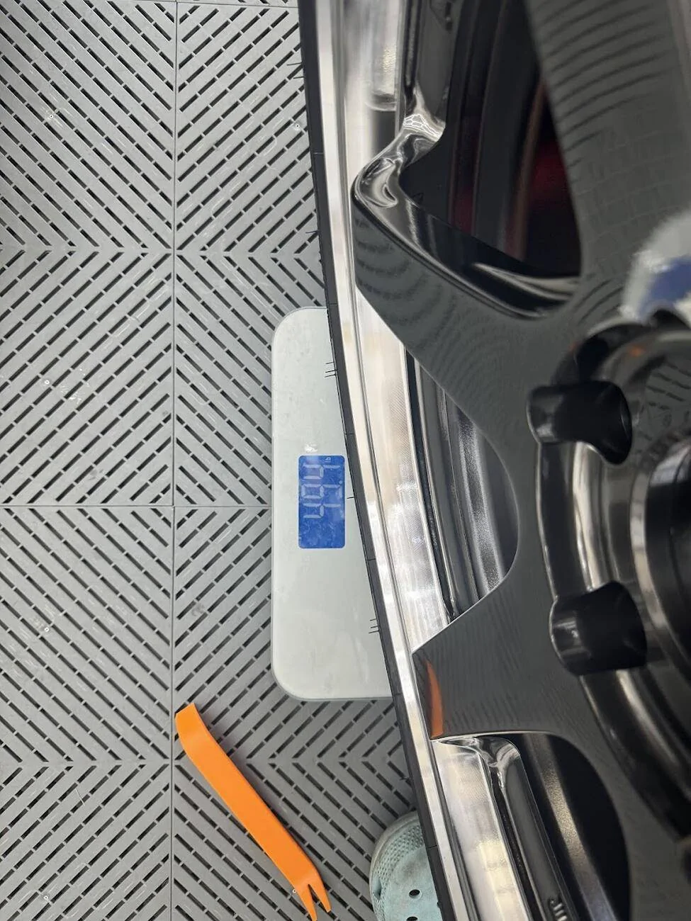

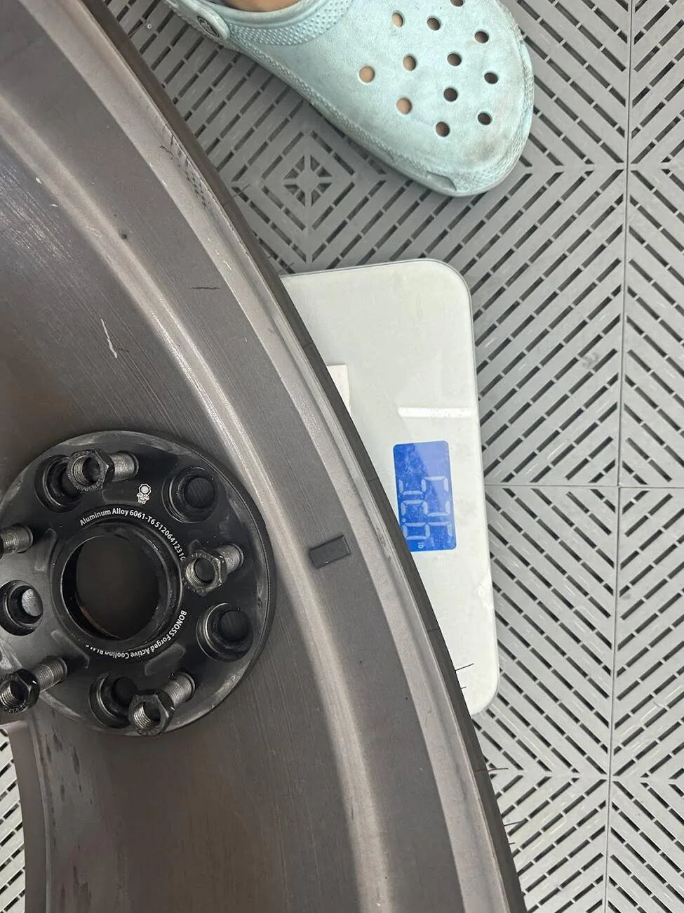

I can't find the weights on the Advan wheels. What was the weight on this setup?
1,452
