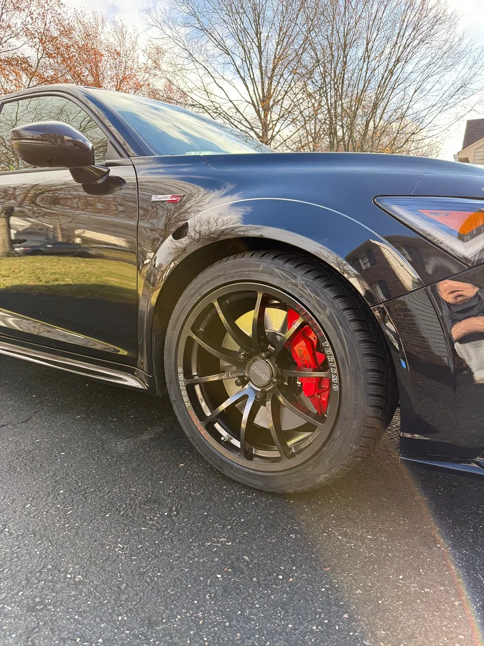

Thinking about pulling the trigger on these. ~$2050 shipped with lug nuts
I have those wheels with 265/35/18 DWS06+. Great combination with an OEM style wheel. Very happy with them in western PA as a winter tire option.

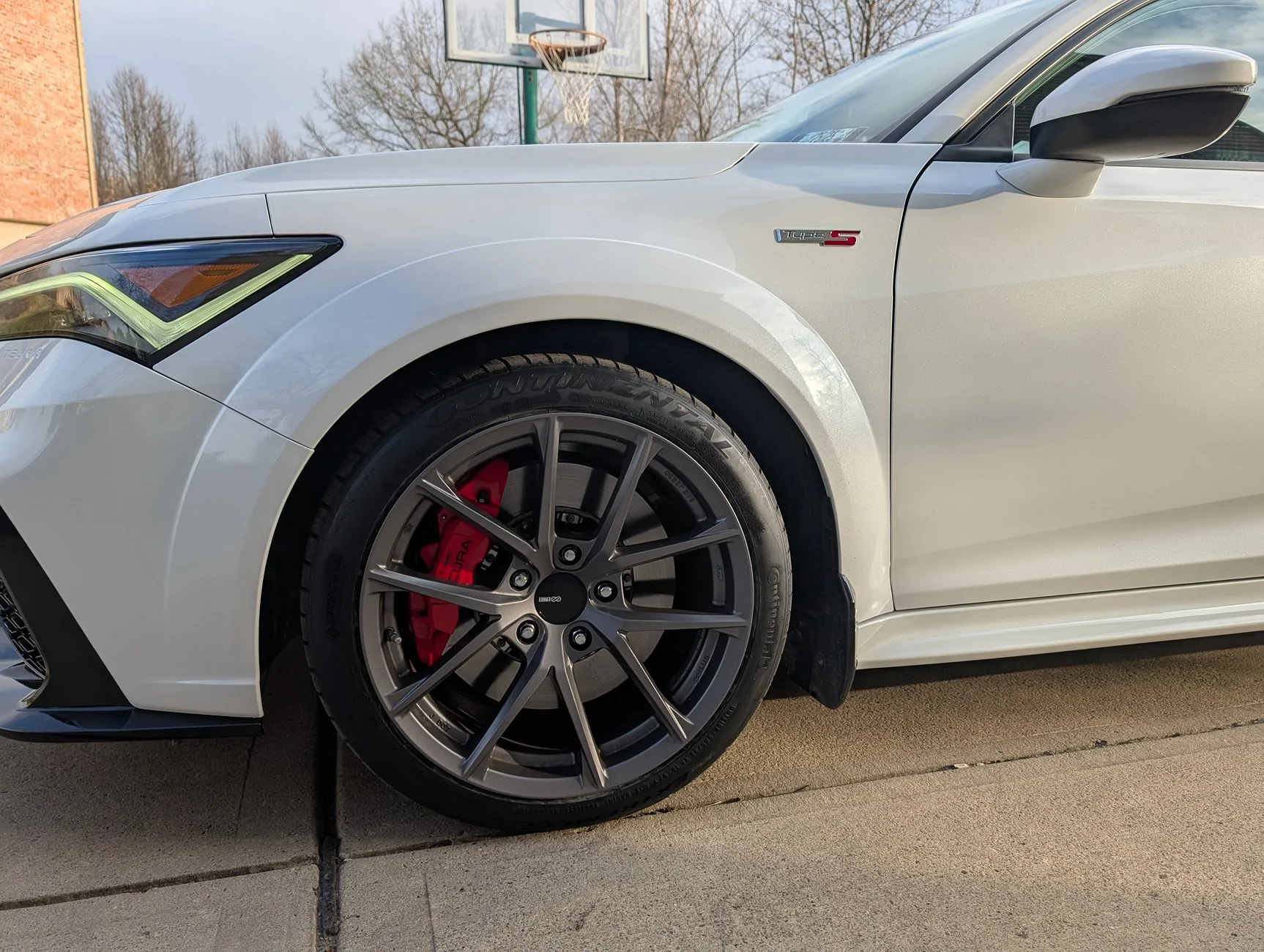

If you're going to push the offset out 15mm, do it on a summer set instead of a winter one.
Keep the winter road grime and salt away from the side of the car as much as you can.

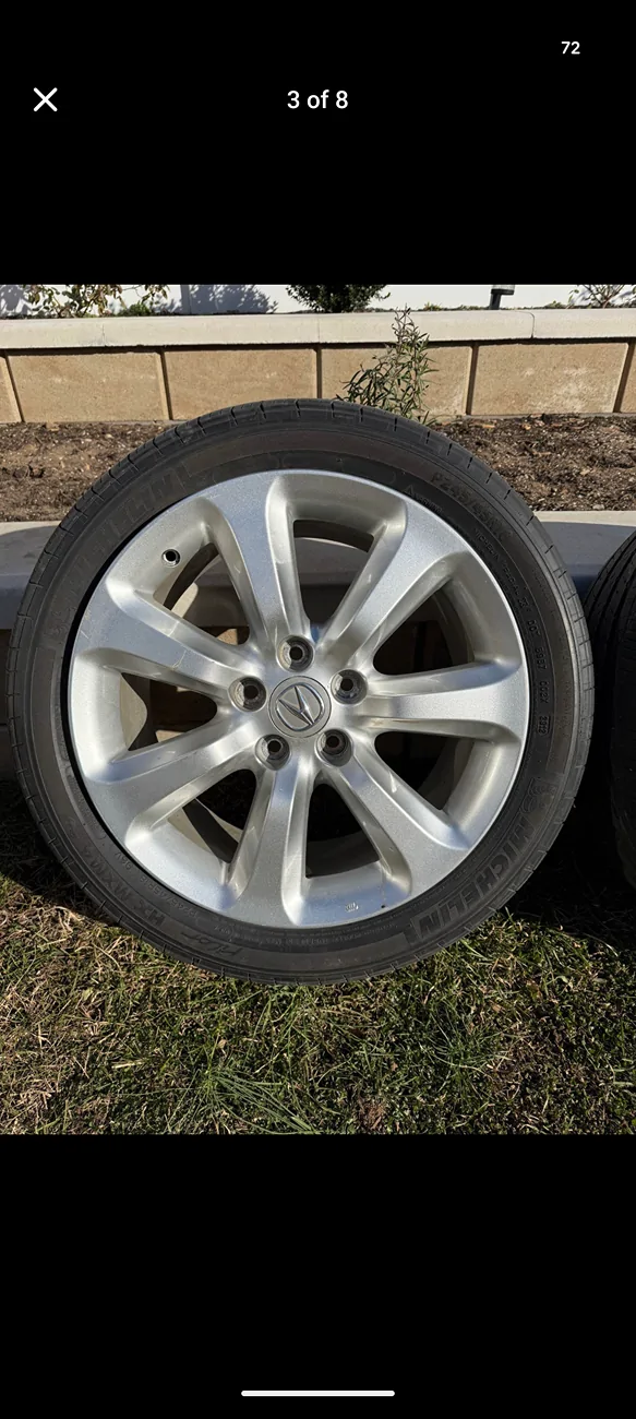

I read through one of the threads someone posted about using oem wheels. It sort of went nowhere, anyone have an insight on an 18" OEM wheel? Depending on the design, doesn't have to be Acura. I'm looking to color change them anyway. Thanks again
Spart
May 31, 2025
182
166
2025 Integra Type S
Check my post on the first page and there's a link regarding the use of 2009 Acura TL wheels.
AbeFroMan66
AbeFroMan66
Dec 19, 2025
US
2025 Integra Type S, 2020 Civic Si, 1970 Chevy C10
I read both of those. The op never showed pics of the wheels on the car with tire. I'm also checking out marketplace and they're not too common by me

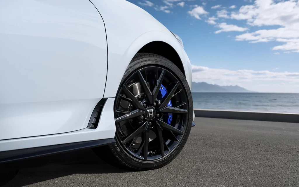

An interesting tidbit I picked up today - the new Prelude uses the CTR suspension and brakes, which I would assume means that it uses the CTR bolt pattern.
I looked it up and the wheels for the Prelude are a 19x8.5, factory wrapped in 235/40R19. That's actually a good bit taller of a tire than our OE 265/30R19.
If these wheels could be ordered, they may make a decent winter wheel option. I would prefer 18's and a touch narrower.
Just a thought.
